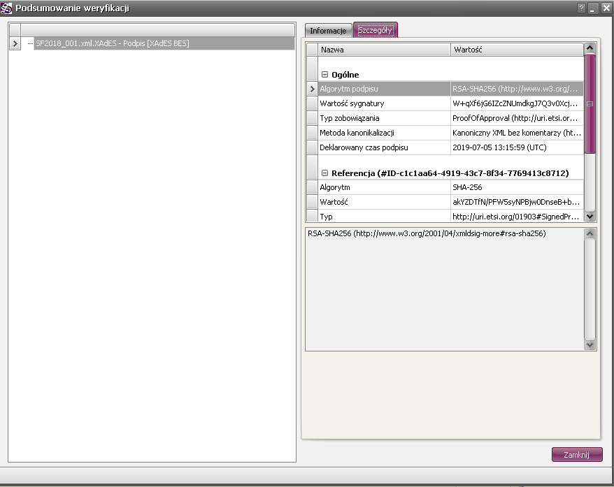

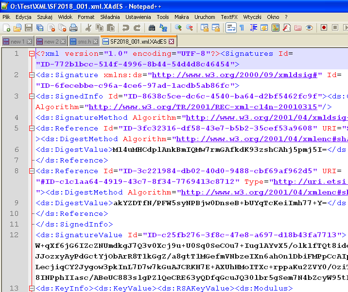

    On my old WinXP computer, I have no problem opening these xades files :D
    I can open it using (also the old one :D ) Sigillum Sign 4
    Programs to Read XML.XAdES Files: ProcertumSmartSign Alternatives + Comoveo CRM Offerxades.PNG (32.37 kB)You must be logged in to download this attachment.

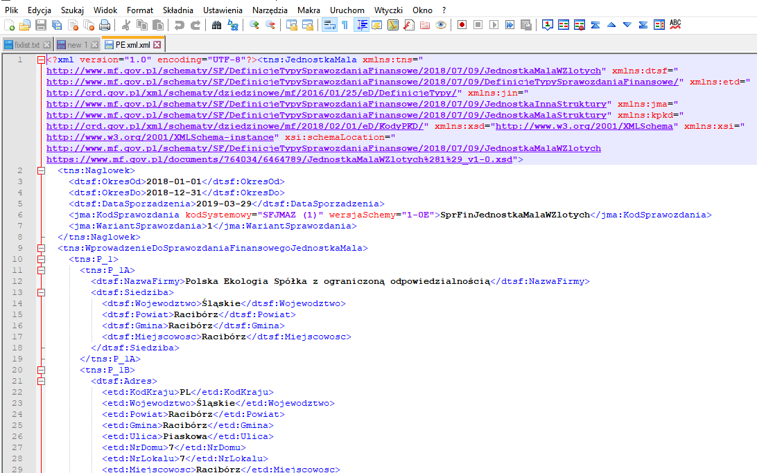

    I can also open with Notepad ++ editor
    Programs to Read XML.XAdES Files: ProcertumSmartSign Alternatives + Comoveo CRM Offerxad note..d.PNG (66.62 kB)You must be logged in to download this attachment.
    This is not the file you indicated, but it has the correct structure (as each is verified when submitting to the National Court Register :idea: ) and you might as well open your file that way :idea:
    However, if you would like to modify it :cunning: I warn you that he has both internal and external security :please: e.g. ADS :D

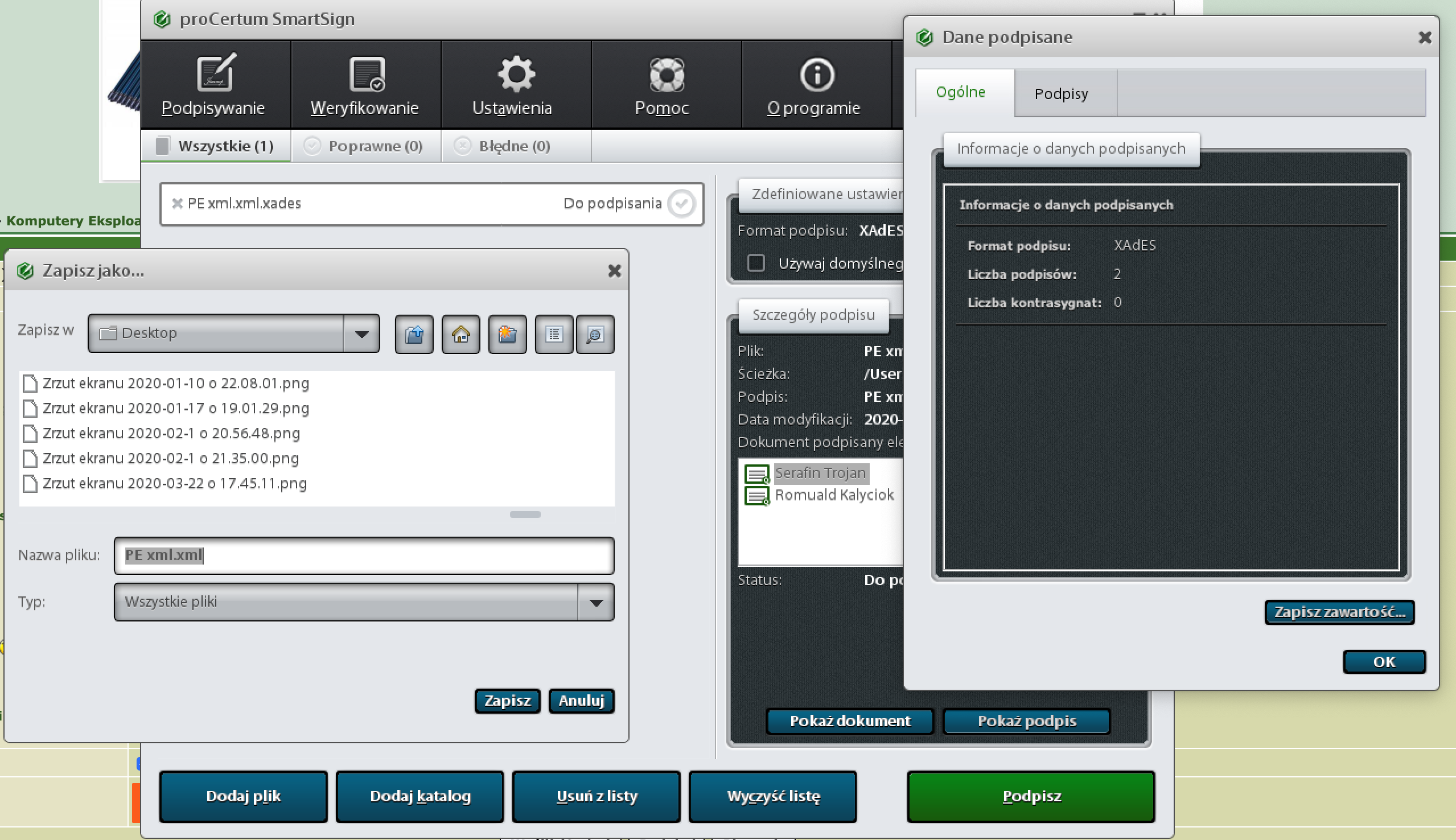

    I am attaching a screen to see the file. Nothing more. KRS files can be opened in the web application at: https://e-sprawozdania.biz.pl/show/ there you can see the actual data of sp z oo. I only manage to load and nothing else ....
    • Programs to Read XML.XAdES Files: ProcertumSmartSign Alternatives + Comoveo CRM Offer Zrzut ekranu 2020-04-20 o 21.17.28.png (1.59 MB) You must be logged in to download this attachment.

    From picture 2 #Prot you can read a lot. You can have such a record in various ways. I don't know if you need fully formatted text or just some data. A file with the .xml extension is a specific file. Even as soon as you change the extension from xades to xml and try to open it with Excel, you will read a lot of content.
    If you answer OK then you will save the file and you will get the same view as given #Prot

    According to my knowledge in this area, e-financial statements are prepared in the structure imposed by the Ministry of Finance (according to the xsd template file) in the xml format. Such a file is signed either internally (digital signatures of signatures are entered inside the xml file) or externally, and then an additional file is created with the same name but with the extension xml.xades which also has an xml type structure (i.e. it can be opened with any xml editor :D ) and basically only contains the digital signature of the signatures :!:
    I will check your Certum software tomorrow, but on the basis of the screenshot I can see that you are trying to operate on the tab signing :cry: and you should run the tab signature verification :idea:

    On my screenshot 2 there is a view of the xml.xades file directly from the editor notepad ++ :!:
    If this editor in the system is the default xml editor, an attempt to open the file outside the Certum software (see author's screenshot) will look the same :D If there is no default xml editor set in Certum software, then "you will not be able to open this file" :not:

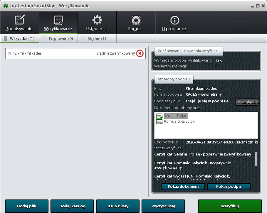

    Programs to Read XML.XAdES Files: ProcertumSmartSign Alternatives + Comoveo CRM Offer2020-04...png (163.01 kB)You must be logged in to download this attachment.
    you press the button verify

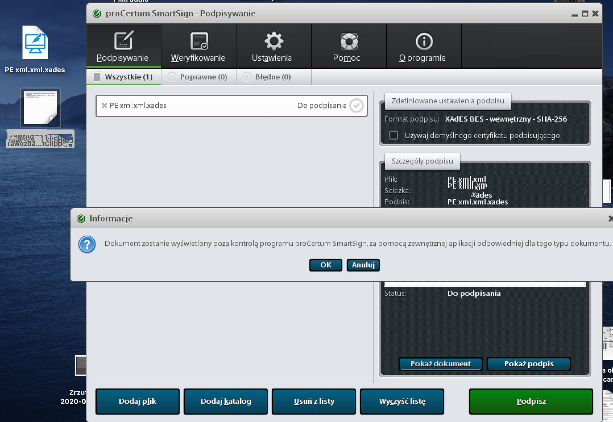

    Programs to Read XML.XAdES Files: ProcertumSmartSign Alternatives + Comoveo CRM Offer2020-04-2..1).png (175.23 kB)You must be logged in to download this attachment.
    you press the button show document and depending on the default xml editor installed on the system (you edit this entire file) :D

    Bingo, thanks, I had to struggle a bit to change the default xml app from open offica to textedit and it worked but only for docx (it opened automatically), xml doesn't open automatically - but there is a way to do it. After selecting a signer, you have to give: show signature and then there is a field save the content, no xades and voil?.
    • Programs to Read XML.XAdES Files: ProcertumSmartSign Alternatives + Comoveo CRM Offer Zrzut ekranu 2020-04-21 o 22.32.24.png (794.79 KB) You must be logged in to download this attachment.

    pabelos1972 wrote:
    and then there's a save content field, no xades anymore
    And I wrote about it and I automatically give you a name with xlm and it opens with the program you pointed the first time so that it opens xlm.

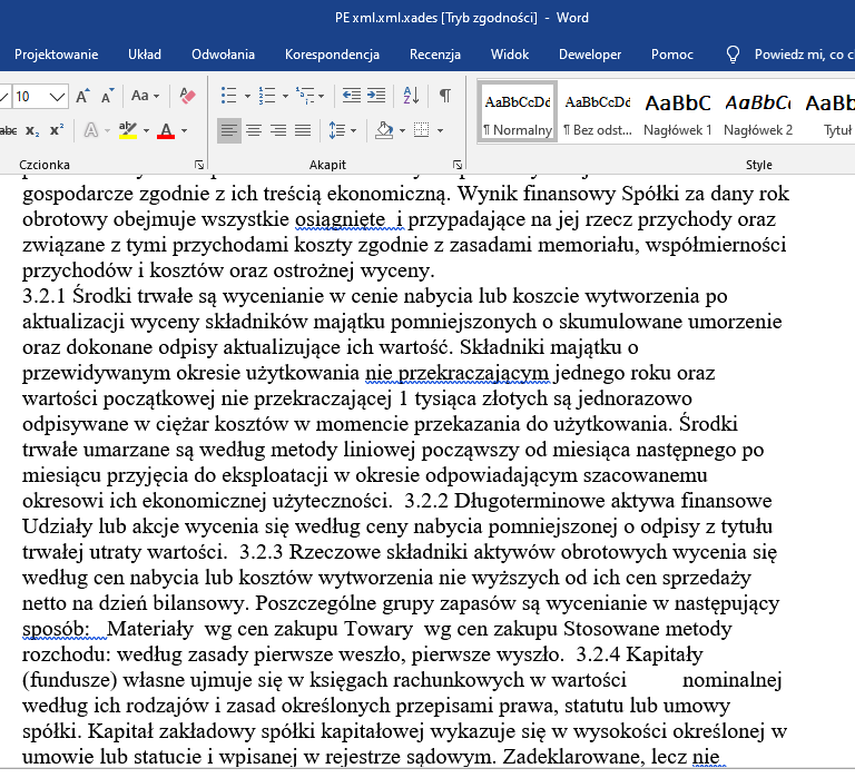

    Therefore, I suggest that the xml file that you "decrypt" open normally but with Excel. You only need to change the height of the poem (at the beginning I gave 50) and the content is more readable.
    PS Now I tried LibreOffice (spreadsheet) and unfortunately it only imports the text there.
