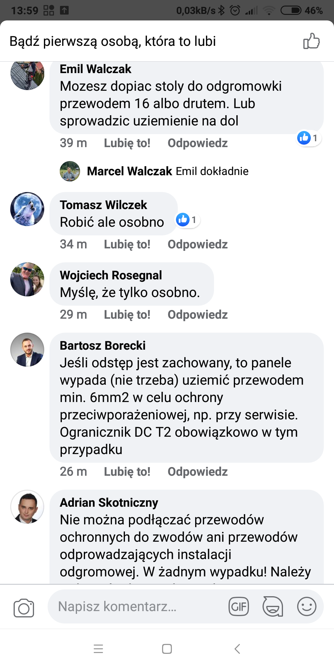

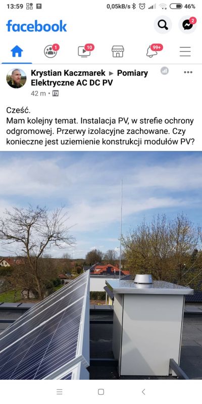

    Posada1993 wrote:
    Hello Experts,
    I studied photovoltaNikie at the University of Fejsbuku and there the lecturers tell me to do this or vice versa.
    Posada1993 wrote:
    what is your opinion
    Opinion of my lecturers of panels level dach:
    PV Installation Grounding on Steel Roof Tiles: Contractor Advice, TN-S System & Regulations
