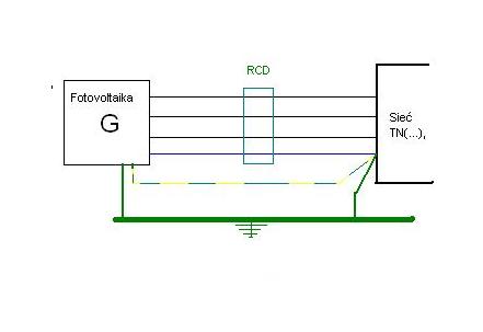

    Can someone explain the difference in the diagram in post # 4 and in the descriptions. E.g.
    eclipse99 wrote:
    Residual current circuit breaker 4P 40A / 300mA, Type B
    My point is to clarify whether the rated differential current should be 30 or 300 mA because it is "such a small" difference.

    I want to note that the RCD is at the installation site 3x230V 50Hz. It does not matter what is the front or before (it checks itself - whether there is current asymmetry) - it checks the condition of the installation in both directions - in the current receiving phase or in the voltage generation phase. The type of RCD depends on the harmonics of the current.

    Bronek22 wrote:
    The 30mA RCD is designed to protect people - not devices.
    It is to prevent people from being "killed" in the event of an electric shock.
    Looking at the figure below, those using renewable and traditional energy are deprived of the protection of second-lieutenants. despite the use of an RCD in the inverter.
    Can a 4P 40A/300mA Type B RCD be used in TN-C PV installation?

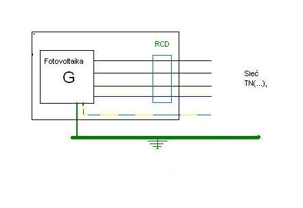

    Bronek22 wrote:
    RG pictorial drawing, without details.
    Mr. Bronek, I will present a very detailed drawing now.
    Represents 100% basic protection of the user - only the inscription is available.
    Still, the RCD is not allowed to function properly.
