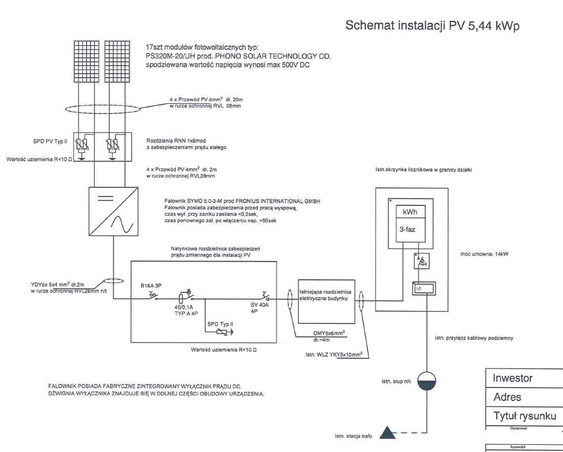

    I have made a PV installation on a roof covered with steel tiles. The building has installations in the TN-S system and does not have a lightning protection system.
    The inverter is grounded to the PE bus. As for the panels and structures themselves, the contractor claims that there is no need for additional installation on the roof.
    Is the contractor right in this case? Are there any laws regulating this?

  • #6 18643205
    ozzi132
    Posts: 6
    Rate: 10
    In addition, I attach a diagram of how it looks like.

    Equipotential bonding: PE rail - module frames

    The following installation diagram shows: "the expected voltage value is max. 500 V DC"

    17x Voc 40.35 = 685.95 I 17x Vmpp 34.08 = 579.36 so almost 80V over the 500 and just over that can kill. Even if this gutter will be made of plastic, it will be safe ??? I just mean how much more expensive it would be with this earthing of the panels. And then installers are surprised that there are such regulations as https://www.elektroda.pl/rtvforum/topic3650420.html and that you will have to pass the UDT RES exam and it is not enough to buy SEP here https: //www.olx.pl/oferty/q-SEP/

    Look in the design, even the inverter has no grounding. The drawing sucks too, so let's wait.
