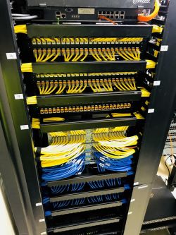

    IC_Current wrote:
    There is no difference with arranging patchcords, just give larger organizers (make sure they are tall, because some of them, despite the fact that they are supposed to be 2U, are very shallow).
    And what do you think of the deep 1U like in the picture below?
    Building a home LAN network with a RACK cabinet (extensive and fast home network
    Here it looks pretty cool and 48 cables can fit in it, without excessive tension and without making 1U spacing between patch panels and organizers (in my case, there would be a maximum of 24 cables per organizer)

    There is really no point in putting up a large wardrobe in such an apartment. Something hanging will be better, hidden somewhere in a dresser or wardrobe.
    As for the previous points:
    - you will mount the devices (if you try) with a depth of about 15 cm less than the depth of the outer wardrobe
    - you cannot dampen the wardrobe with anything, because you will block the air circulation and cook the devices inside
    - in the photo there are 1U organizers, but on the side there are also vertical channels, where the supply of cables is hidden.
    - wardrobe model - if you do not save, the wardrobe will not fall. You can buy good quality wardrobes at Dipol (Signal brand).
    Some cables should enter from the side in a 600mm wide cabinet? ... always alternatively, I think I could run the beam through the organizer, between the devices and lead it out from the back?
    I reorganized the cabinet structure a bit based on your advice, the diagrams below, but I did not apply the wiring diagram anymore because I had no time to think about it today ...
    Building a home LAN network with a RACK cabinet (extensive and fast home network Building a home LAN network with a RACK cabinet (extensive and fast home network
    - I replaced the 10G switch (to what I threw earlier, you can't get ears to be attached to the RACK) - thanks to this I can make an uplink / downlink between switches to 20Gbps
    - I have already "ultimately" added QNAP which would only serve as a backup for all devices (computers, laptops, phones), possibly for the CCTV support function
    - the monitoring functions from Ubiquiti are quite interesting and they have integration with UDM-Pro, so I think that for now I will go this way when it comes to monitoring (or if I am dissatisfied, I will switch the IP camera support to QNAP)
    - a separate QNAP with virtualization and multimedia functions will be in a more efficient form in the Tower version on the desk
    - at the bottom, the areas marked as "reserve" can remain empty or be made available for other devices (e.g. I do not watch TV, so the switch for IPTV is "exaggerated" but I may need it one day), just like so far I do not have QNAP in the RACK version and I don't know when I will buy one ;)
    - I made one scheme with two switches for 24 ports and one with a 48-port switch (in this scheme with a 48-port switch, I decided that the 2U organizer would be more "masking the cables" that would go from the switch to the patchpanel, but at the same time it would allow the introduction to the patchpanel other cables - I think I like this solution the most (and it's cheaper than 2x24port)
    What do you think about these changes after consulting you? ... I know that there is not much reserve left, but as a last resort I will throw away the organizers and pin the cables in bundles with ties and they will be on top ;)
    Do you have any comments? Maybe as for the density of equipment, or for the location of equipment, patch panels, etc., etc.? ;)

    For me, the version with switch 48 is better.
