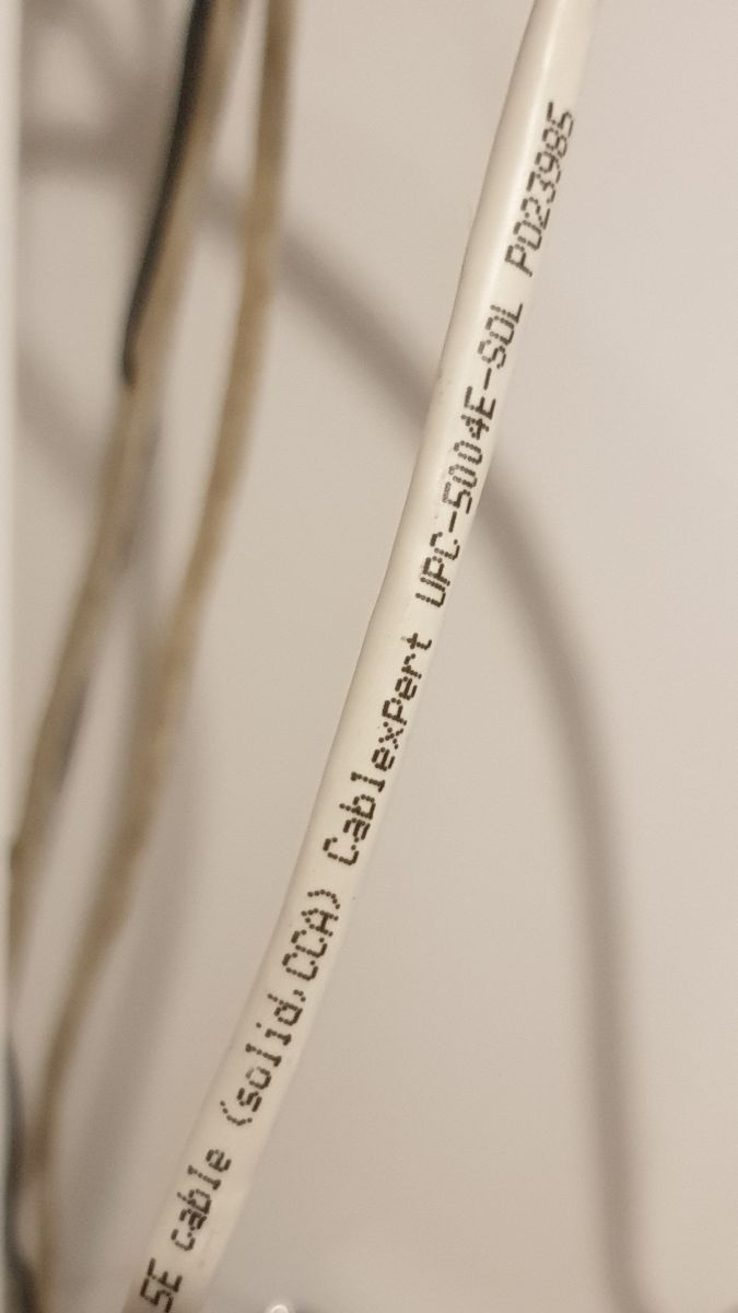

    Hello, I have a problem that I don't know how to solve. Well, today I raised the Internet operator INEA to 600 Mb / s earlier I had 150 Mb / s to 15 Mb / s probably - something that is not important. The problem is that on one cable there is 600Mbps on the other I have a stagnation up to 95Mbps. Both cables are 5E category, of which one, the factory one from Inea, is maybe 1.5 meters long and I need 30 meters because I have about 30 meters from the modem to the computer. 5e cable 30 meters, I made the plugs myself because they were not factory-installed. The Internet is no problem with the fact that instead of 600 Mb / s I have 95 Mb / s (even on a laptop that received 600 Mb / s via a cable with inea).
    How to deal with this?
    Is the cable Chinese?
    I ordered on Allegro because I had no other alternative in my town. I earned the plugs in a simple configuration according to the guide - Rj45 TYPE A - TYPE A. Cables on each plug in the order of white-green, green, white-orange, blue, white-blue, orange, white-brown, brown.
    Where could the problem lie? In the length of the cable, its cheated variant or badly made plugs?

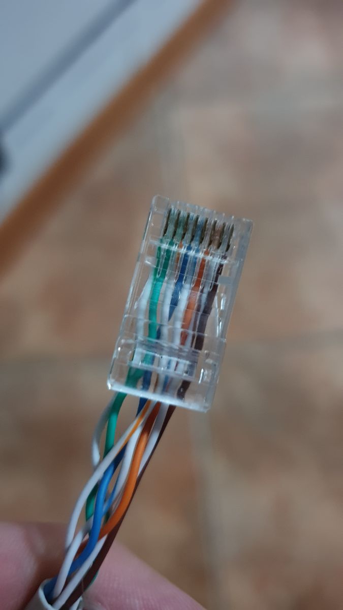

  • #2 18669062
    jimasek
    Posts: 35287
    Help: 3783
    Rate: 2671
    Board Language: polish
    Show a picture of these earned plugs, what kind of wire is this? Some company?

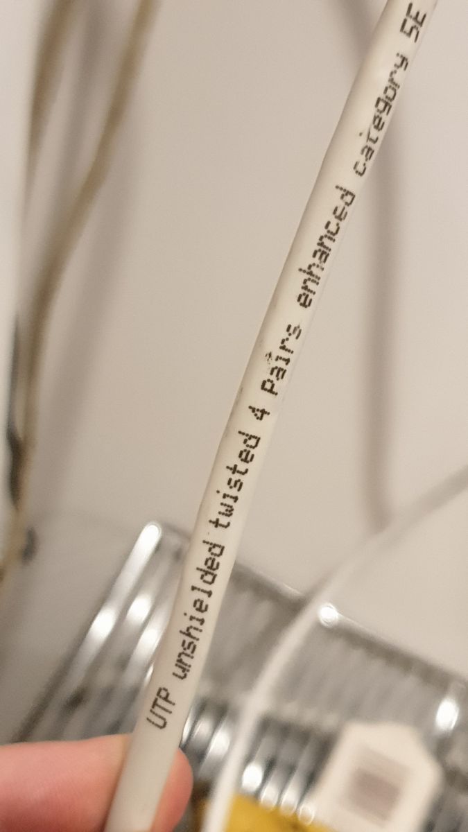

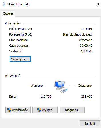

  • #4 18669096
    warzych123
    Posts: 11
    I don't know if it's a company cable, because I don't know much, but it says CablexPert. The picture shows the full text
    The network card sees 1Gb/s, Full Duplex

  • #5 18669118
    nici
    Posts: 4961
    Help: 266
    Rate: 977
    Since the card sees gigabit, it should be ok. Doesn't this value drop under load?
  • #6 18669135
    warzych123
    Posts: 11
    It's not ok because this cable on the speedtest is 95Mb/s on the cable with Inea speed test shows 600Mb/s

  • #9 18669213
    KOCUREK1970
    Posts: 35122
    Help: 3786
    Rate: 5326
    Earn again, only now in standard B and do it more carefully than what is shown in the photos.

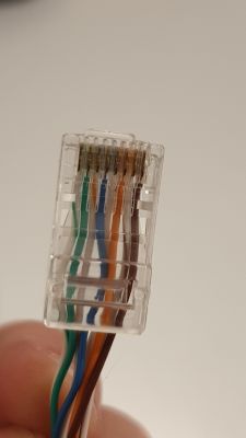

  • #10 18669340
    warzych123
    Posts: 11
    I'm no cable expert, but I tried my best :D
    I plugged with type B and unfortunately the effect is the same. 95Mbps on both PC and Laptop.

  • #12 18669386
    sosarek
    Posts: 83875
    Help: 9318
    Rate: 15425
    And you can see that it's CCA - copper-plated aluminum and not copper.

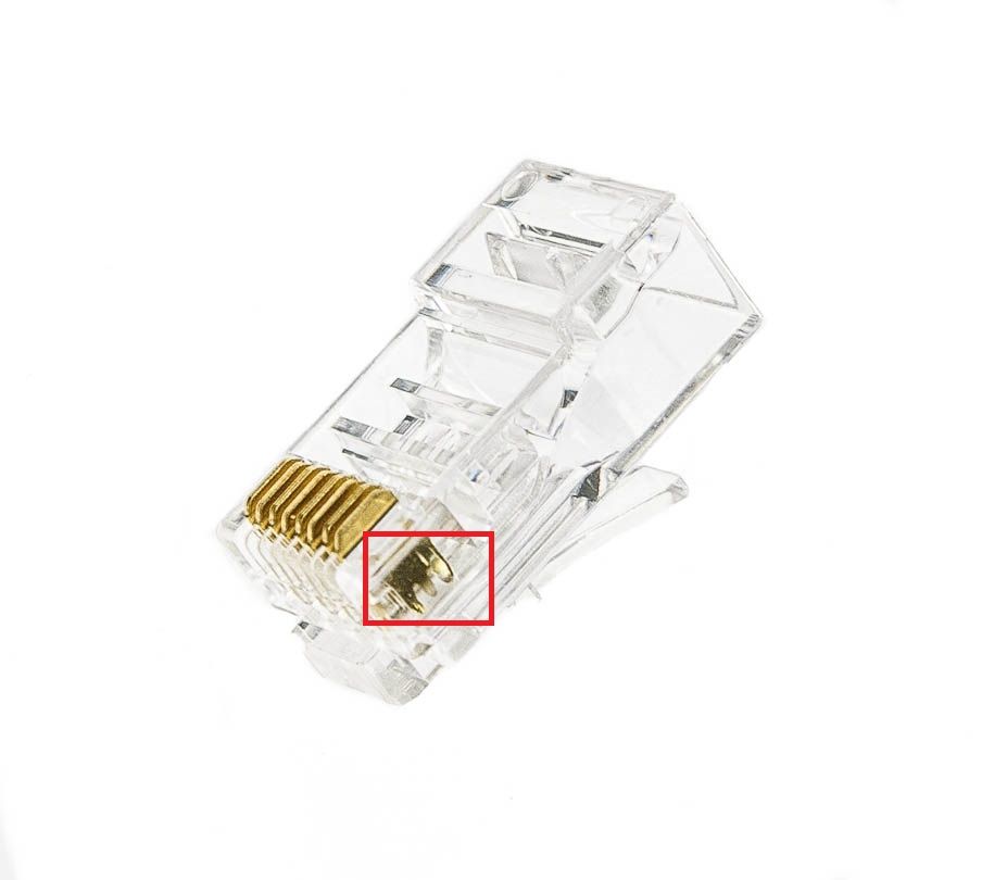

  • #19 18669605
    KOCUREK1970
    Posts: 35122
    Help: 3786
    Rate: 5326
    @warzych123
    These plugs you currently have, when you look at the plug, do they have 2 prongs or 3?
    3 teeth are more versatile:

  • #20 18669623
    warzych123
    Posts: 11
    They have two teeth
  • #22 18669647
    Zutket
    Level 36  
    Posts: 2876
    Help: 270
    Rate: 1045
    warzych123 wrote:
    They have two teeth
    What are you clamping the RJs with? :?: I'm asking because I've already met people who clamped with a screwdriver. Unfortunately, without a meter, or at least a good LAN tester, you will not be able to determine where the problem lies.
  • #23 18669651
    jprzedworski
    Posts: 5350
    Help: 756
    Rate: 823
    One note - these pairs are unraveled at too much length. There should only be as much as fits in the plug, the cable insulation should be crimped in the plug.
