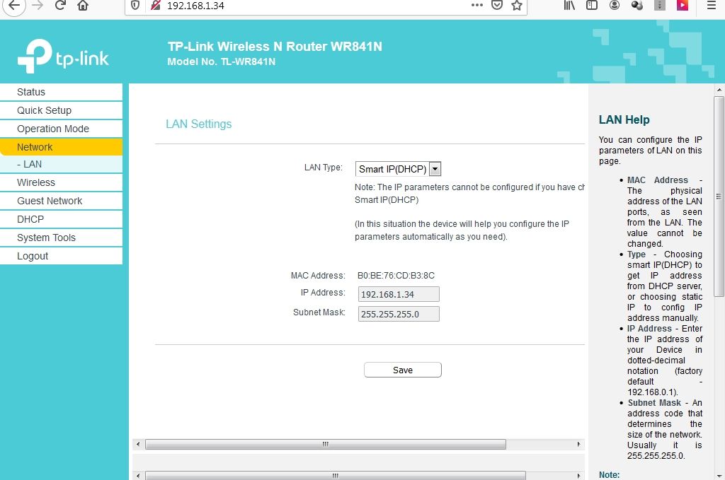

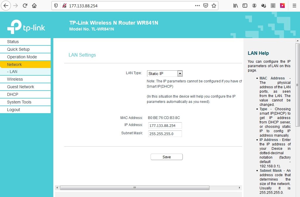

    The only thing I can do is set e.g. a static IP.
    Minecraft - how to play with a friend from another house over LAN. Solution.
    However, Minecraft will launch as an offline version...

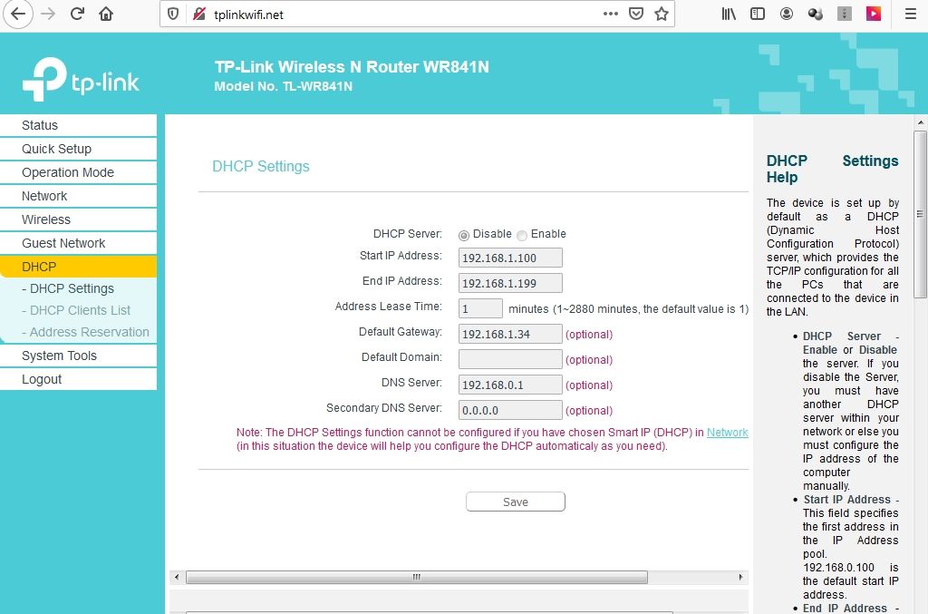

    Now I will return to the default TP-Link settings in AP mode
    and you can see that DHCP is disabled by default in AP mode in TP-Link...
    So, or your friend, when he feels like it, because he`s tired and discouraged :) will change the IP in the Netia router on its side, or we play with two players in one room in one house, on the same Internet. So I have to extend my Internet to my house and my friend`s room. I don`t see any other consideration.

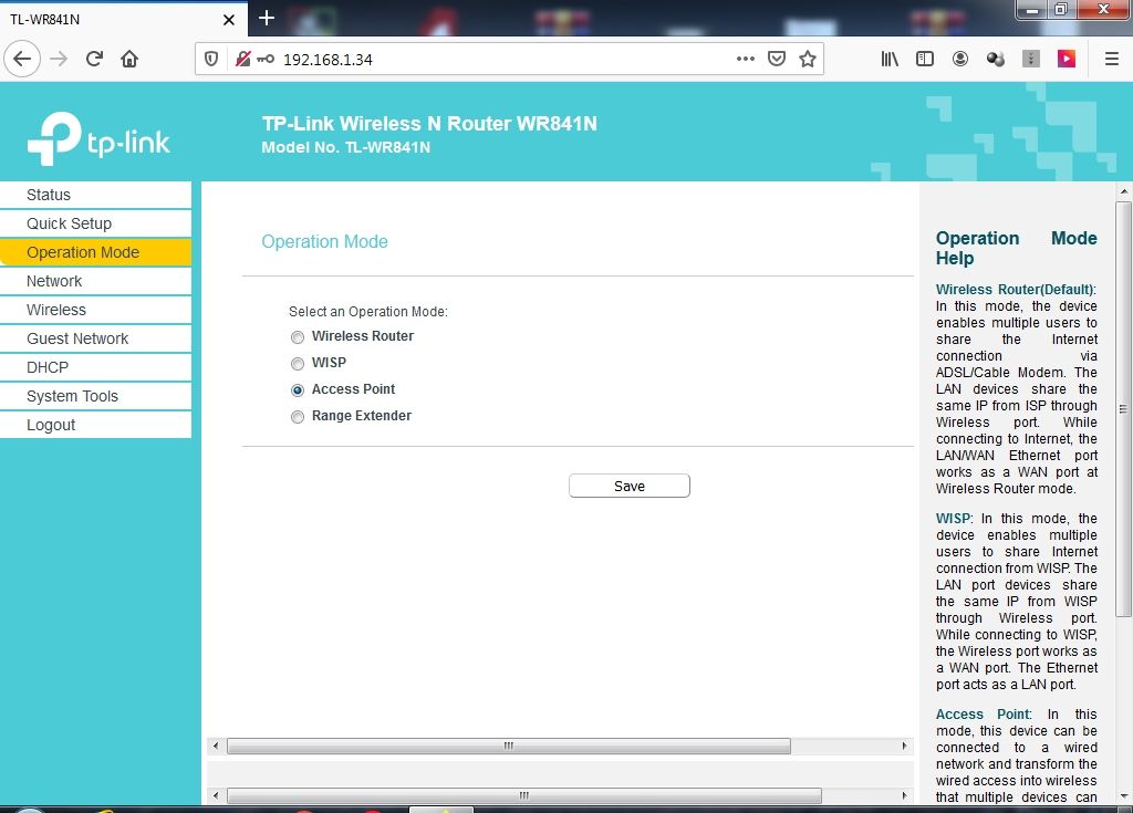

    It looks like you actually have AP mode, with the WAN interface disabled (not the port!)... I don`t see the Operation Mode option at all in the emulator. If so, your Orange router is responsible for changing the IP address.
  • #9 18702978
    Wojtek 24 lata
    Level 25  
    Posts: 1127
    Help: 7
    Rate: 72
    You asked about Operation Mode in TP-Link, here`s a screenshot:
    It is marked AP, whatever that means.
    What IP address should I try to change it to from the Orange router?
