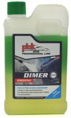

    I haven't written before due to lack of time. Today I'm getting the hang of it. The tank is generally clean and dry, it looks like it has been rinsed because there are no deposits. The smell is so plastic, you can't feel anything except the smell (probably only) of the tank. I will. I spray with Dimera solution (alkaline agent).
    Safe Cleaning of 1000L Mauser Tank Previously Containing Corrosive Rodine XL 1110
    I wash it with a pressure washer. This year I will only water the grass and next year the vegetables. Maybe that's enough.
    Can such chemistry eat into the plastic and release it for a long time?
