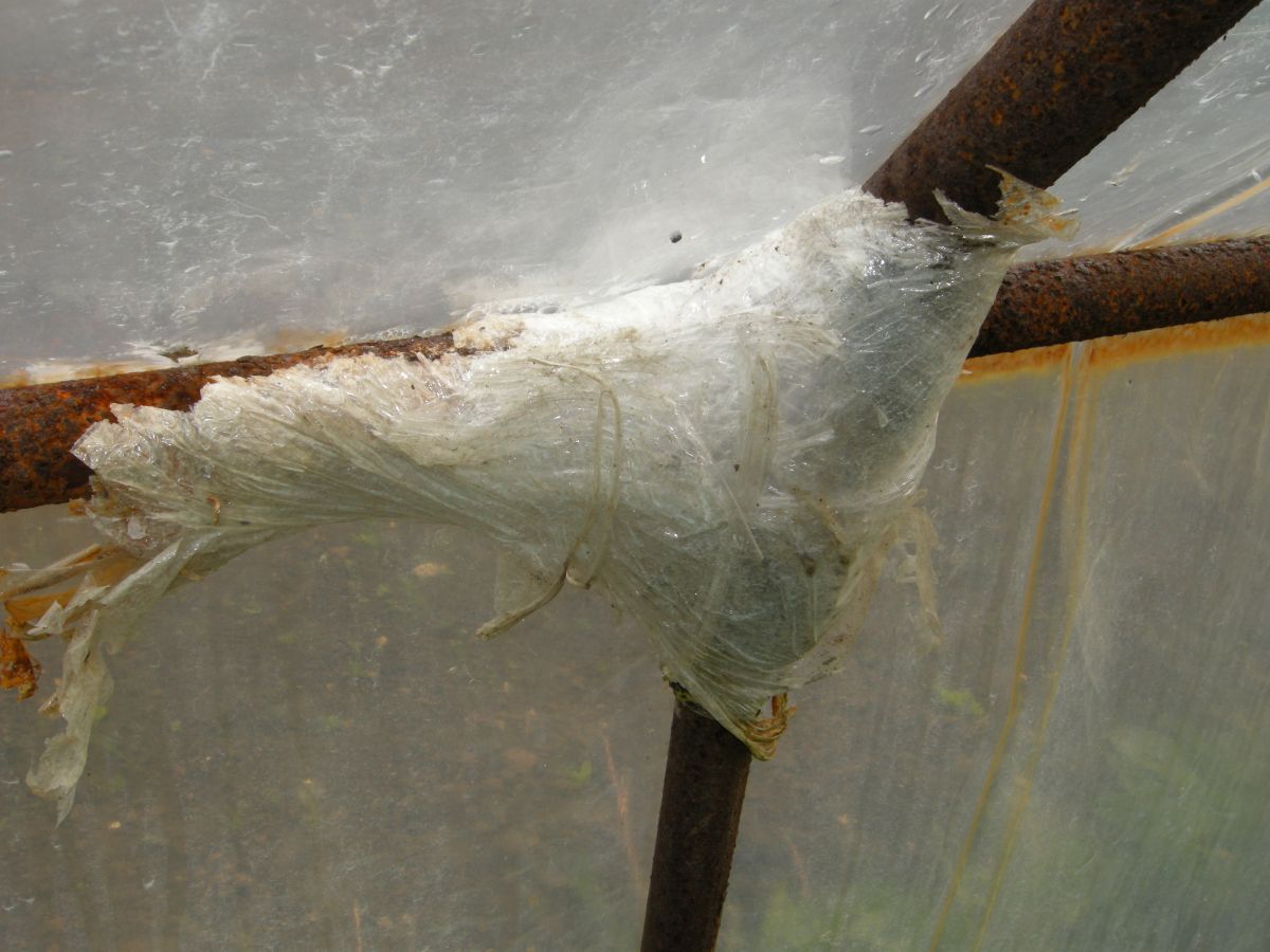

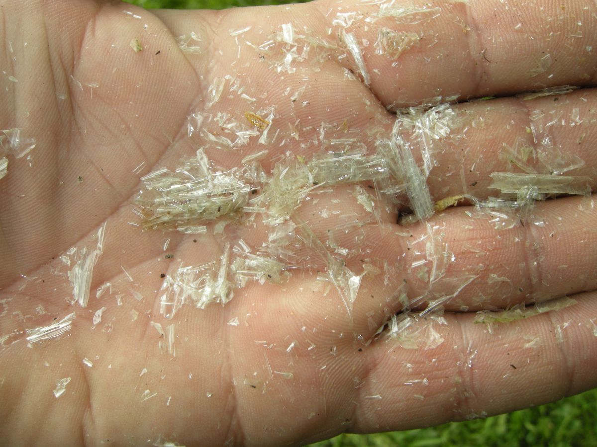

    As for the topic:
    zybex wrote:
    My wife tells me that such foil is not durable. I think so too
    I agree with it.
    And here is an example.
    Rainwater Tanks: Preventing Algae Formation in Mauser 1000L Tanks with Proven Preparations Rainwater Tanks: Preventing Algae Formation in Mauser 1000L Tanks with Proven Preparations
    The stretch foil that I wrapped it connecting the very old (heavily rusted) tubes of the polytunnel construction, it just falls apart like sand. And ecologists "trumpet" how many thousands of years such foil will decompose.
    The foil was not exposed to UV rays because it was in the middle of the foil tunnel.
    Wrapping with stretch foil was intended to soften the rubbing of the foil against the rusty tubes of the structure.
    Stretch like stretch bought three years ago in a DIY store.
    It doesn't decompose - it just changes state of matter... Back to granules. ?
    Your stretch is strange - some poor quality...
    But environmentalists are right, this foil has not decomposed into prime factors. She just crumbled and crumbled. And these particles can constantly circulate in the environment, they can settle on your lungs and other internal organs, they can be in your bloodstream and cause clots and blockages, they can be in your entire digestive system and in many, many other places in nature.. .
