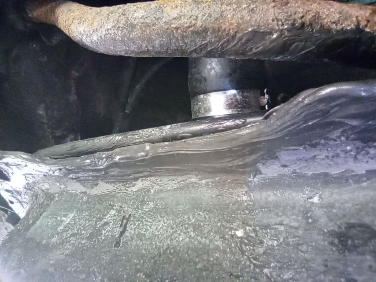

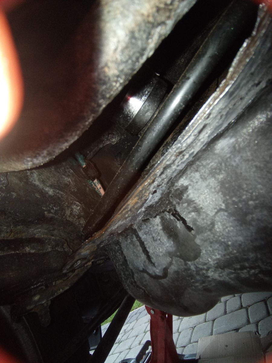

  • Fuel tank leak sealed with anaerobic compound
    #17 21544718
    fabians
    Posts: 228
    Rate: 65
    As for the metal tank, I was recommended by a mechanic friend to use the anaerobic compound "VICTOR REINZ REINZOSIL SILICON SEALING MESS". One similar to silicone, resistant to oils fuel etc. I had the problem of a leak on the weld of the ON tank. Rust had been pitting for years and a leak had developed. I used a screwdriver to clean off the rust and then applied phosphoric acid as a rust remover. After doing 3-4 of these and running the fuel out to 1/4 tank, I degreased and applied the product. After 3 days I poured to full, zero leaks. I applied epoxy primer to the surrounds and repainted with maintenance.
