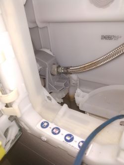

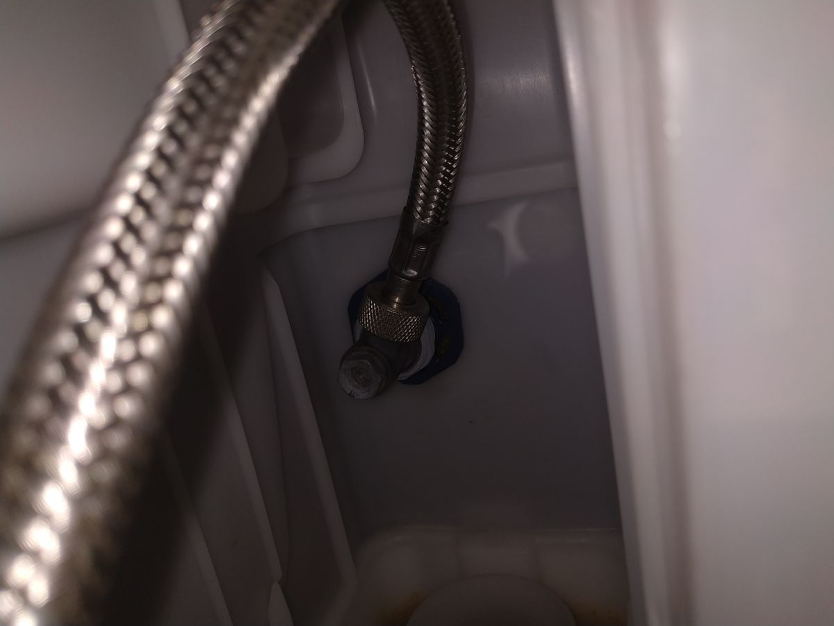

    Hello. I've had a problem with a concealed cistern (I think that's what it's called) for a long time. Well, sometimes it has such a whim and after rinsing it does not take water. Only when I lightly touch the hose does the water move. Sometimes it doesn't show itself for a week and two and it takes water flawlessly, and sometimes it can fail for a few days in a row. I have no idea how this flush works. The only way to get to it is through a small hole through this window with buttons. I also don't know what company this cistern is, when I bought the apartment it was already mounted in the wall. What could be the cause? Is this hose bent too much or not enough? Has anyone had this problem or have any idea how to deal with it? Concealed Cistern: Inconsistent Water Draw After Flushing - Possible Hose Issue? Concealed Cistern: Inconsistent Water Draw After Flushing - Possible Hose Issue? Concealed Cistern: Inconsistent Water Draw After Flushing - Possible Hose Issue?

    You're probably moving the filling valve as well. He is the reason that the water is blocked. Try to see (and if it is possible, take a picture when it has not drawn water) if the filling valve is not blocked. Did the float sink down with the water or is it hanging in the air?

    I have the same problem with the flush-mounted one that does not draw water ... Grohe company .... I unscrewed the hose from both sides and cleaned it ... I suspect that it may still be about the fact that it froze .... explain it to me in terms of what and where else may be...
