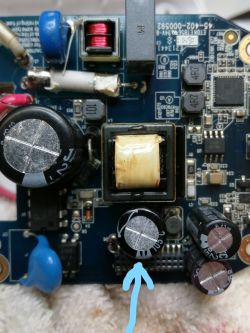

    Change a 470mfd 25v capacitor and possibly save yourself PLN70:00
    Vodafone Sure Signal V3: Fix Dead Unit with 470mfd 25v Capacitor & Save £70

    The user only published information that if this equipment turns out to be dead (it will not turn on), then replacing the specific capacitor shown in the photo will restore the device's efficiency.
    It's translated from English to ours, and since the author's English is the same as some people's Polish here, the translation sucks too.
