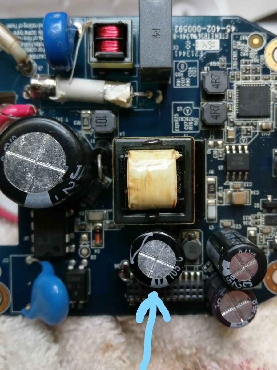

    My Sure Signal from Vodafone suddenly went dead. Opened it up and spotted a likely suspect.
    470mfd at 25v. Changed it and it started again. Vodafone Sure Signal - Vodafone Sure Signal - Completely Dead

    ESR high reading 470mfd.
