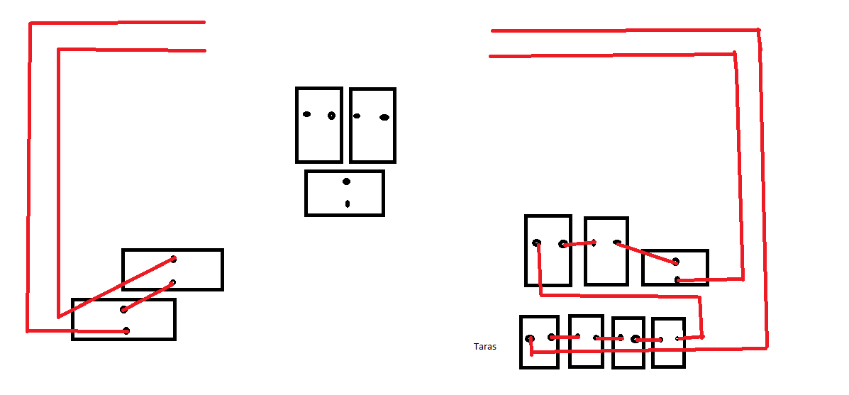

    The installation was designed with modules horizontally taking into account the tech factors. and limitations of the type of shading, limited roof area, etc.
    It is no longer possible to change it, so there remains the question of the arrangement of the current and PE conductors. Please, give me a suggestion on this if there is a better solution.

    You have to "follow the traces" and that's it - there is no need to combine, save and invent.
    We run the cables "in parallel" and there is no point in inventing an induction loop anymore.
    "Half cut" panels - e.g. in QCells - the location does NOT matter - because the cables from the boxes go in opposite directions - we put the panels alternately "up / down" - simple reason - we connect without cutting the factory ties and we do not need to attach loose cables - just attach the "return" wire and that's it.
    I do not understand the dilemmas - the cable costs so little that saving on it does not make sense - especially saving not in accordance with the rules of art.

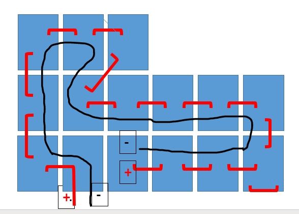

    Hello, I am not going to save on cables, their cost is ridiculous ... I asked a specific question and attached a photo with a combination of modules. In that case, I put the "red" cable to the extreme modules and return it as in the picture. Greetings

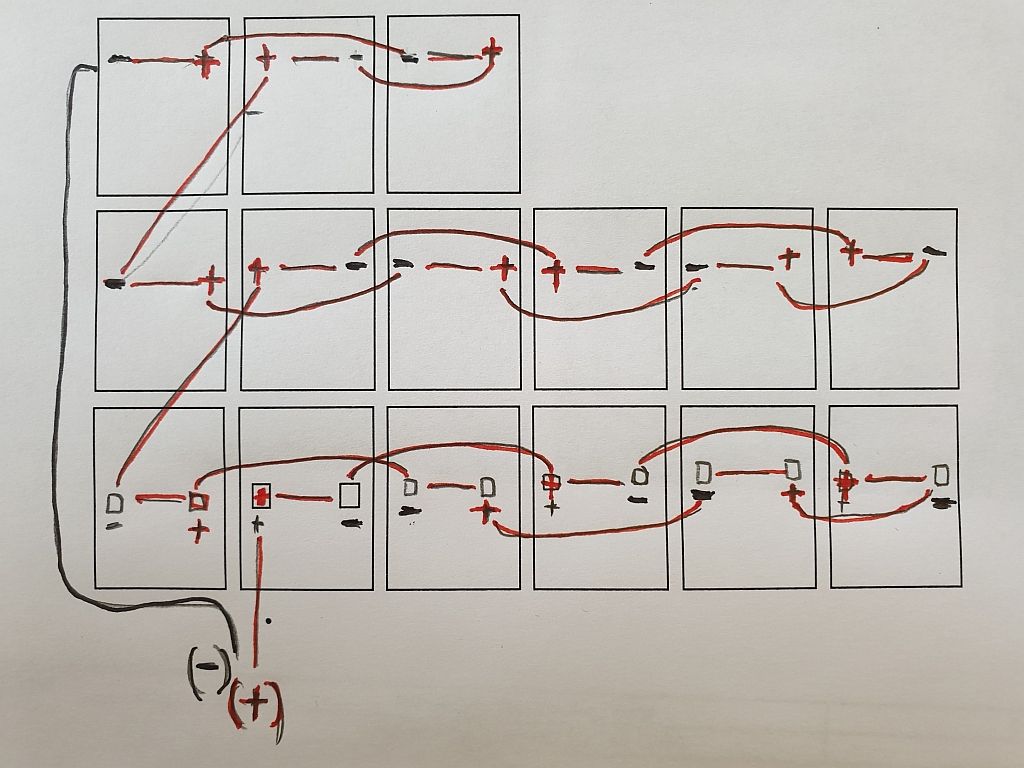

    Hello, I have the last stage of my micro-installation to perform and I have a dilemma with connecting the panels (Qcells G8 350W),
    please subject experts to evaluate my quick wiring diagram. The + and - cables will be placed on the bottom of the panel frame in clips, every other panel will be turned 180 °.

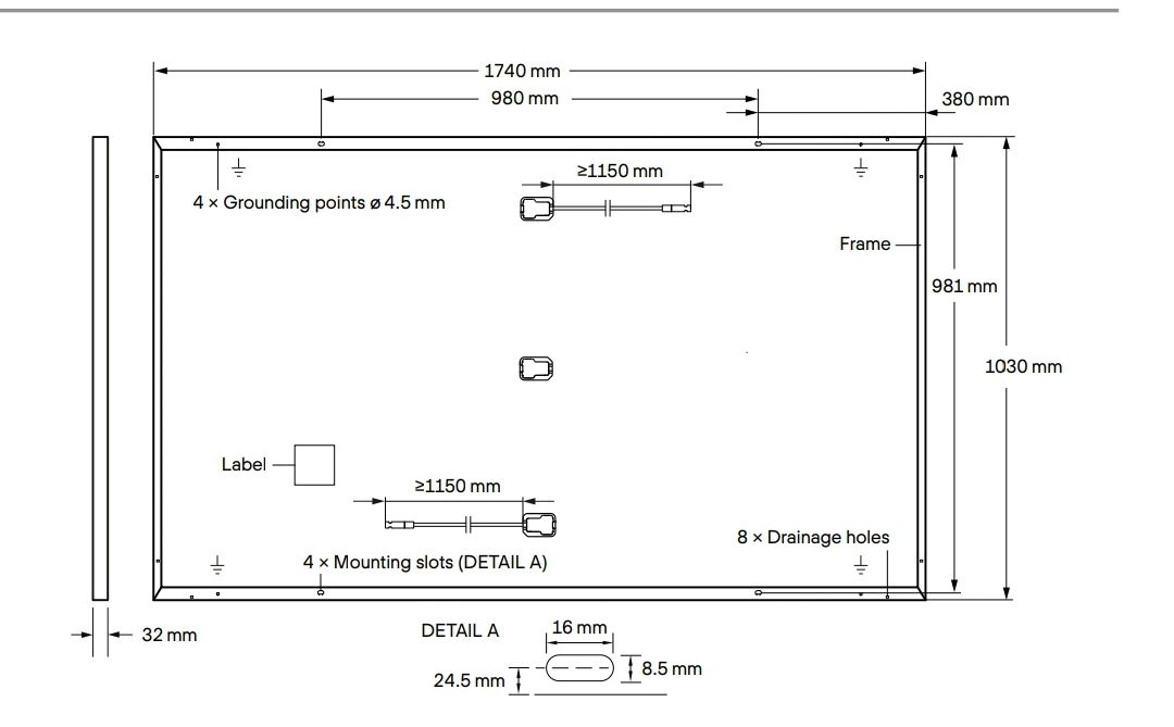

    These modules, as well as most, now have terminals in the middle and there will not be enough wires to lead the lower part of the frame, connecting every second, I would connect one by one and lead the mounting rail and the return pole from the last module led in parallel with the same rail
    As for Qcells, they are introduced on the side ?

    Exactly and in the middle of the length, you have 670 to the lower frame and half of the adjacent module 510 and the break for the handle 200 so we have 1370 and the cable at the module is 1150, unless I did not understand something here or you make cables with mc-4 plugs for each such connection so what is the purpose of rotating the modules?

    On the sides you have holes for ties or you put it on:

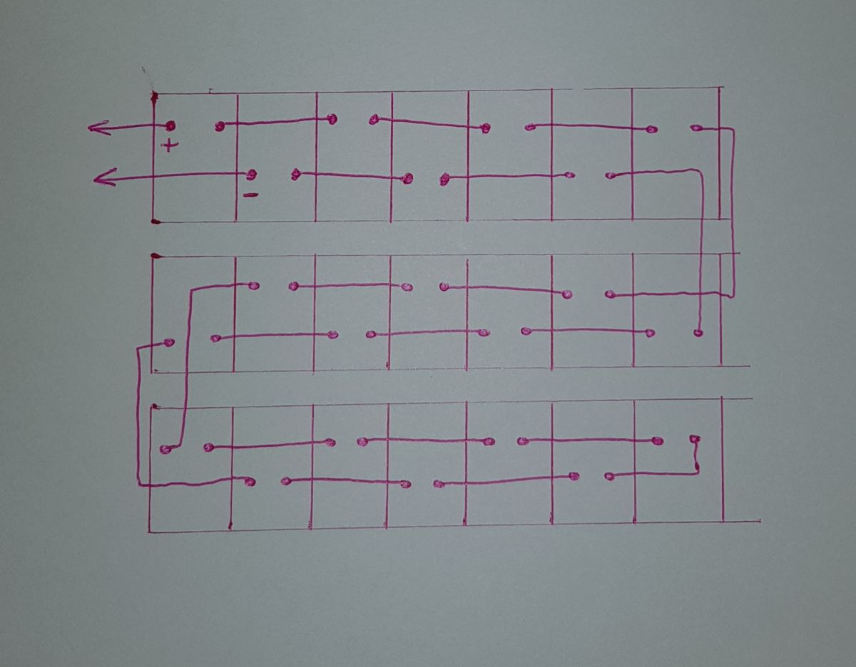

    I put the panels on my own, I'm at the stage of assembling screws and mounting rails, my roof is nasty, I can fit it
    8 Pv panels + 4 panels on the terrace (south side).
    The panels will be scattered across the slope, the cables will be run in a conduit over the ridge and corner rafters.
    "Scramble" how to fasten the panels to avoid loops when wires come from both sides.
    I scrawled a sorry illustrative drawing in the paint. Thanks for any suggestions.
