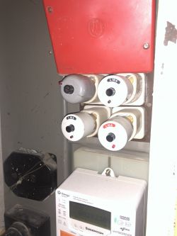

    Hey,
    Need some quick advice.
    How do I fix the plugs? I can't go to press :( .
    They are all removed, when trying to insert them (I press the red button to release the lock, then press the black knob and let go) they pop out.
    Does anyone know of this type of fuse?
    How do you fix traffic jams that won't push in? .

    These are automatic fuses.
    If they "bounce" when pressed, it means there is a short circuit somewhere and the cause should be removed.

    Hey thanks - the problem is that one of them popped out after probably being hit with a small box (they are in a cupboard). The rest were squeezed out by hand and now they refuse to pop back in place.
    So it doesn't look like any failure....

    Unscrew them all and check one by one.

    And pressing without pressing the red button is not possible?

    Ok, false alarm. It is possible to push in without the red dangle, however, it required some force and I therefore assumed that the release of the red safety catch was required
    GENTLEMEN, THANK YOU VERY MUCH!
