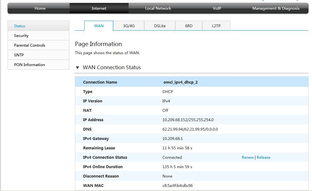

    szmaj
    Posts: 106
    Rate: 31

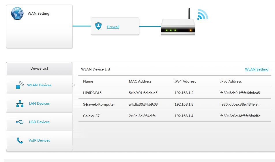

    I logged. I'm already looking (moment).
    Something like this, I know it's not that, I keep looking

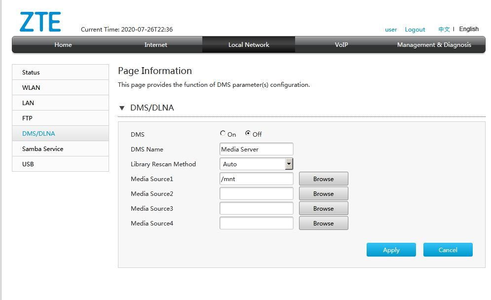

  • #13 18839407
    szmaj
    Posts: 106
    Rate: 31
    I'm already looking, a moment (something like that is also there, but I'm going to your link

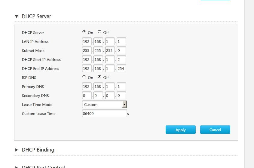

    IPv 4 - I have it enabled
    Enigma 2: Nameserver (DNS) Unconfirmed Issue with New Internet Provider & Router Setup
    I'm already looking for IPv6, hold on

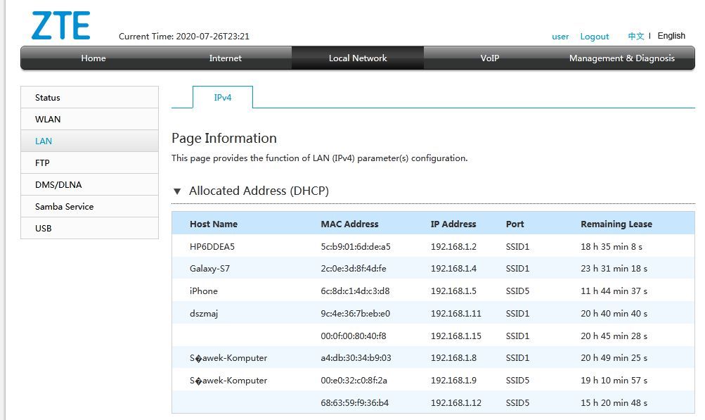

    I can't find IPv6. i have a different menu. There is something like that, but there are four
    I do not give up, I keep looking. sorry it takes so long

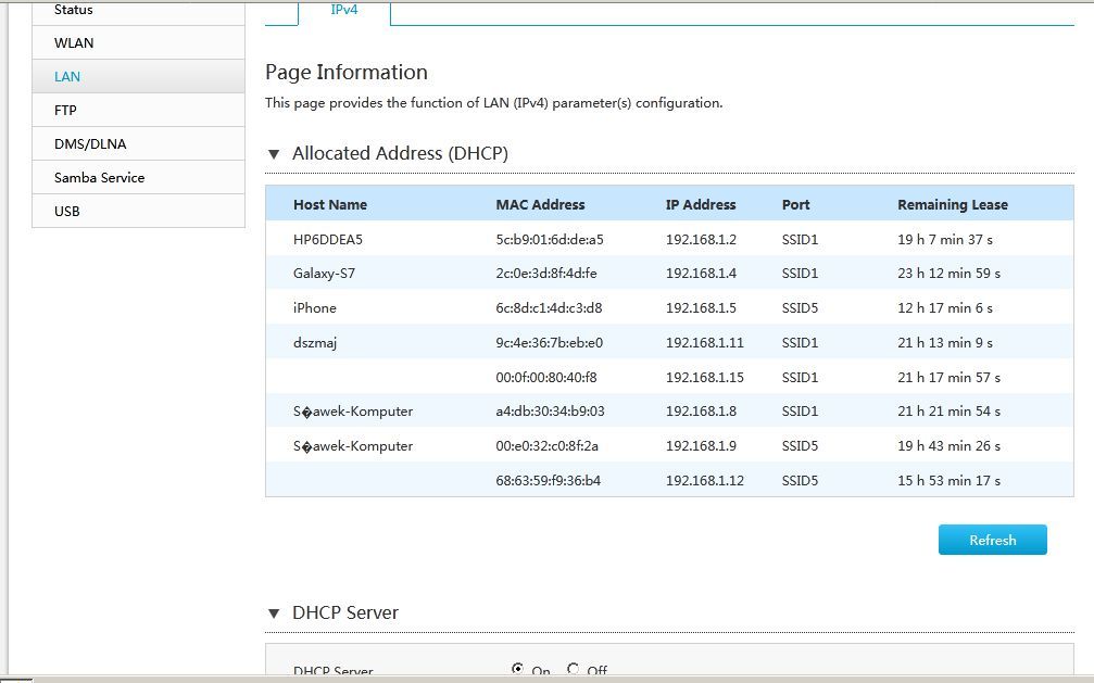

    Here's something from IPv6
    He's already trying to get into it
  • #19 18839466
    szmaj
    Posts: 106
    Rate: 31
    Erbit wrote:
    This should be close to the DHCP Server IPv4.
    Show me what else you have here (DNS): http://screenshots.portforward.com/routers/ZTE/F680/DNS_Service.htm
    CONFIRM MORE OR FOR SURE LAN or WLAN. It says IPv6, but when I get into it, it's still IPv4

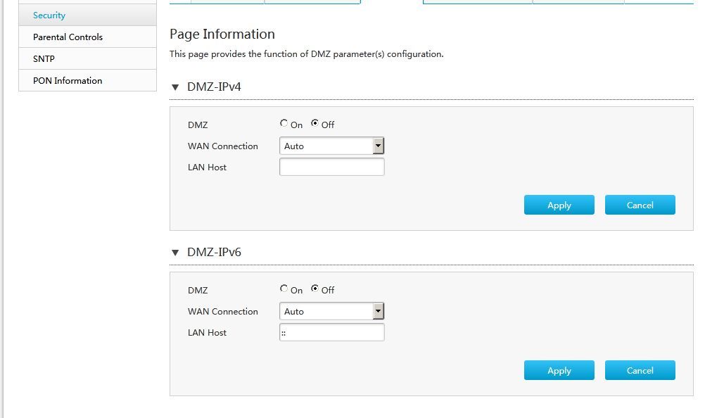

    Added after 6 [minutes]:
    See, I only see IPv4. Maybe I have to make an IPv6 tab next to the IPv4 tab?
