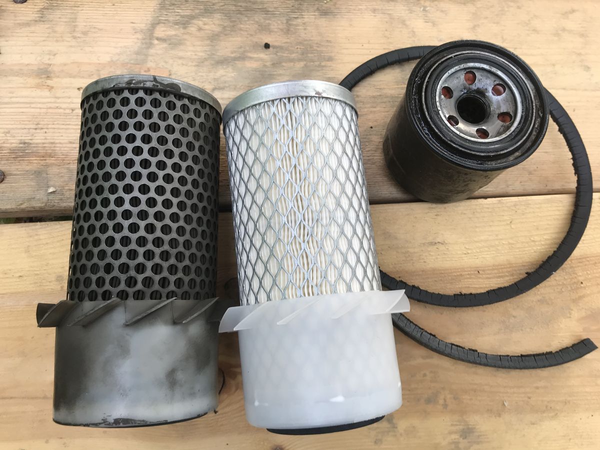

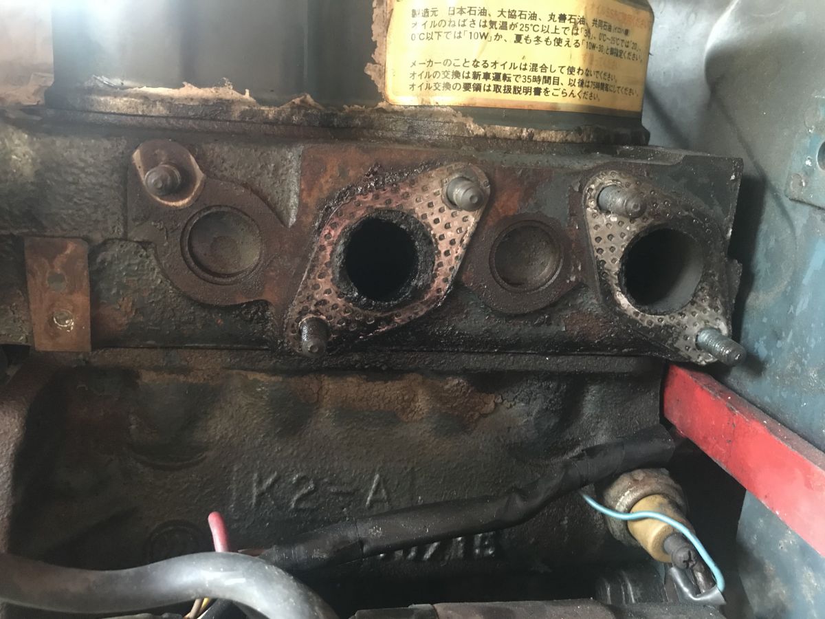

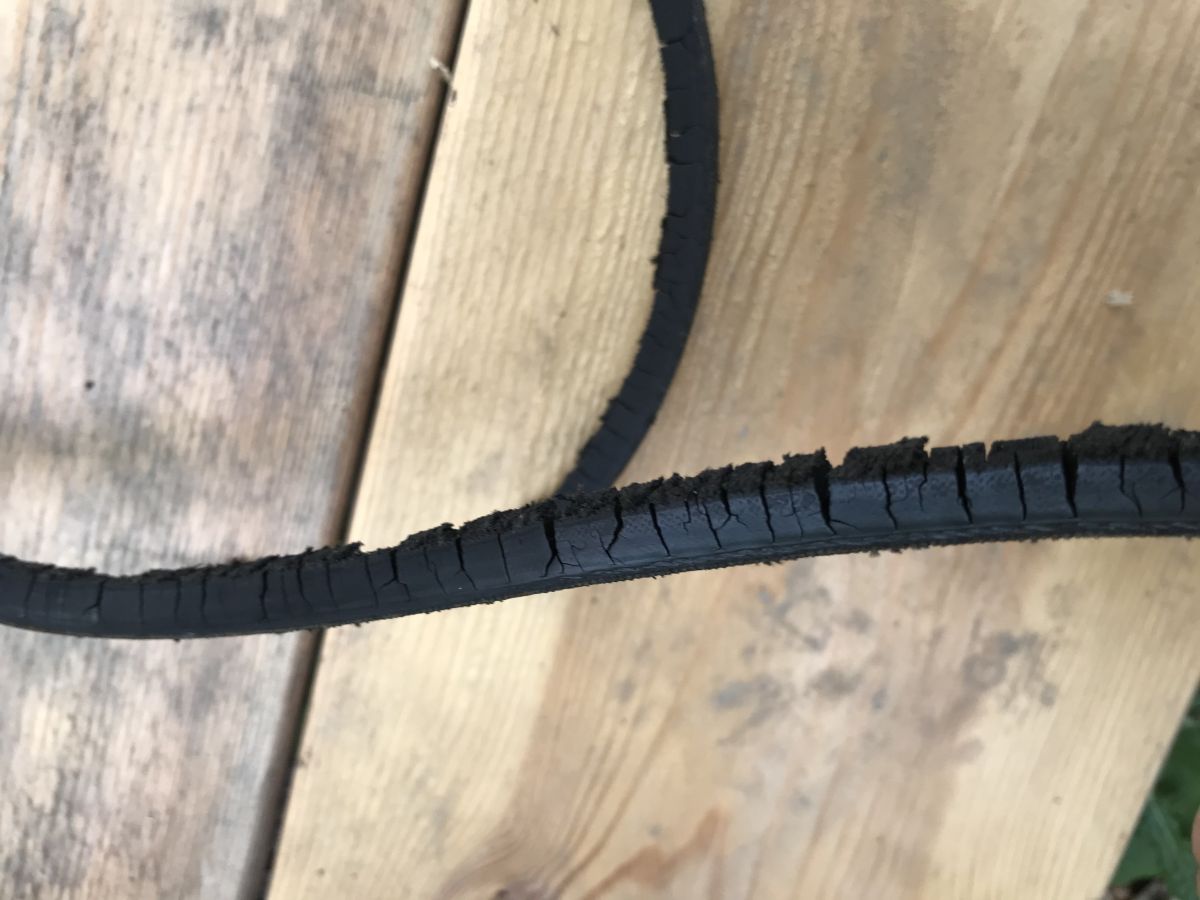

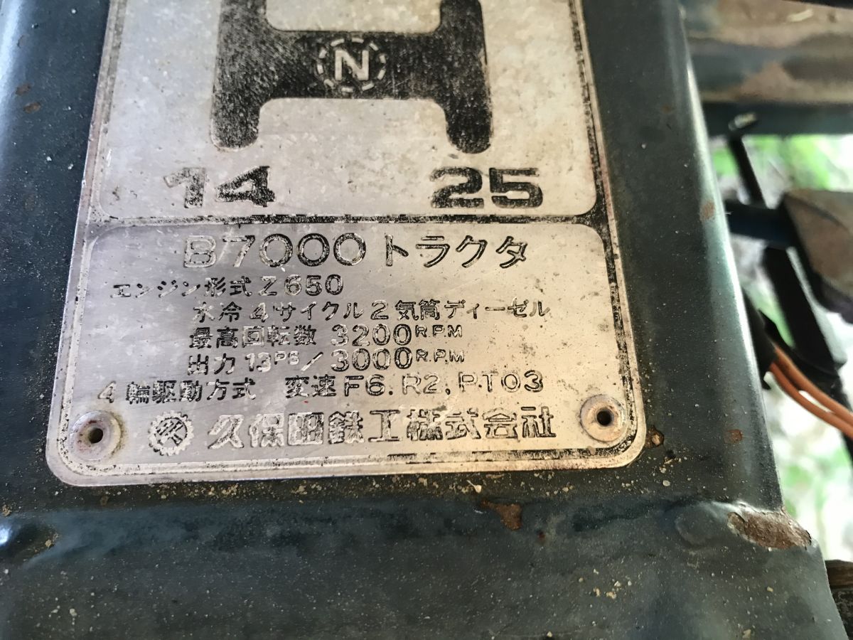

    Recently, I have owned the Kubota B7000 tractor.

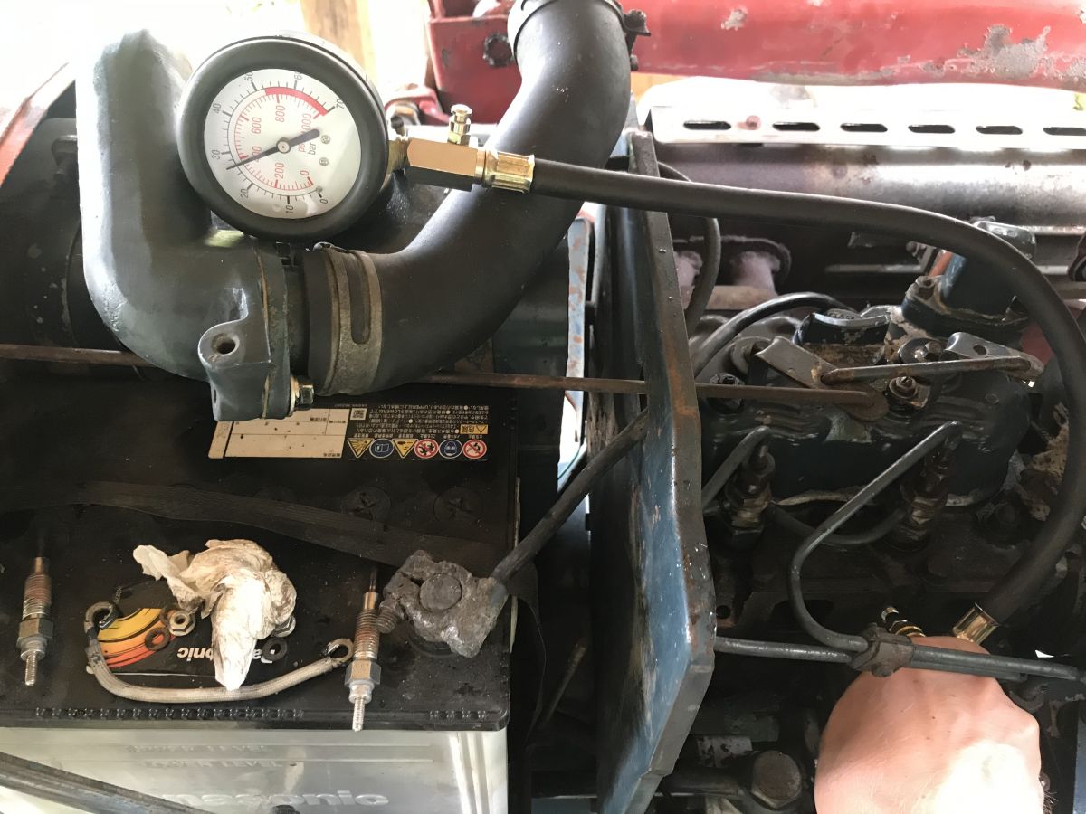

    When loaded, it smokes white quite profusely, takes a long time to spin when firing, and has gusts of pneumothorax.
    Compression 1 cylinder 22 Bar; the second cylinder 25 Bar, while after the oil test 30 and 32 Bar respectively.
    Also suspicion is the rings and / or pistons and / or sleeves :(

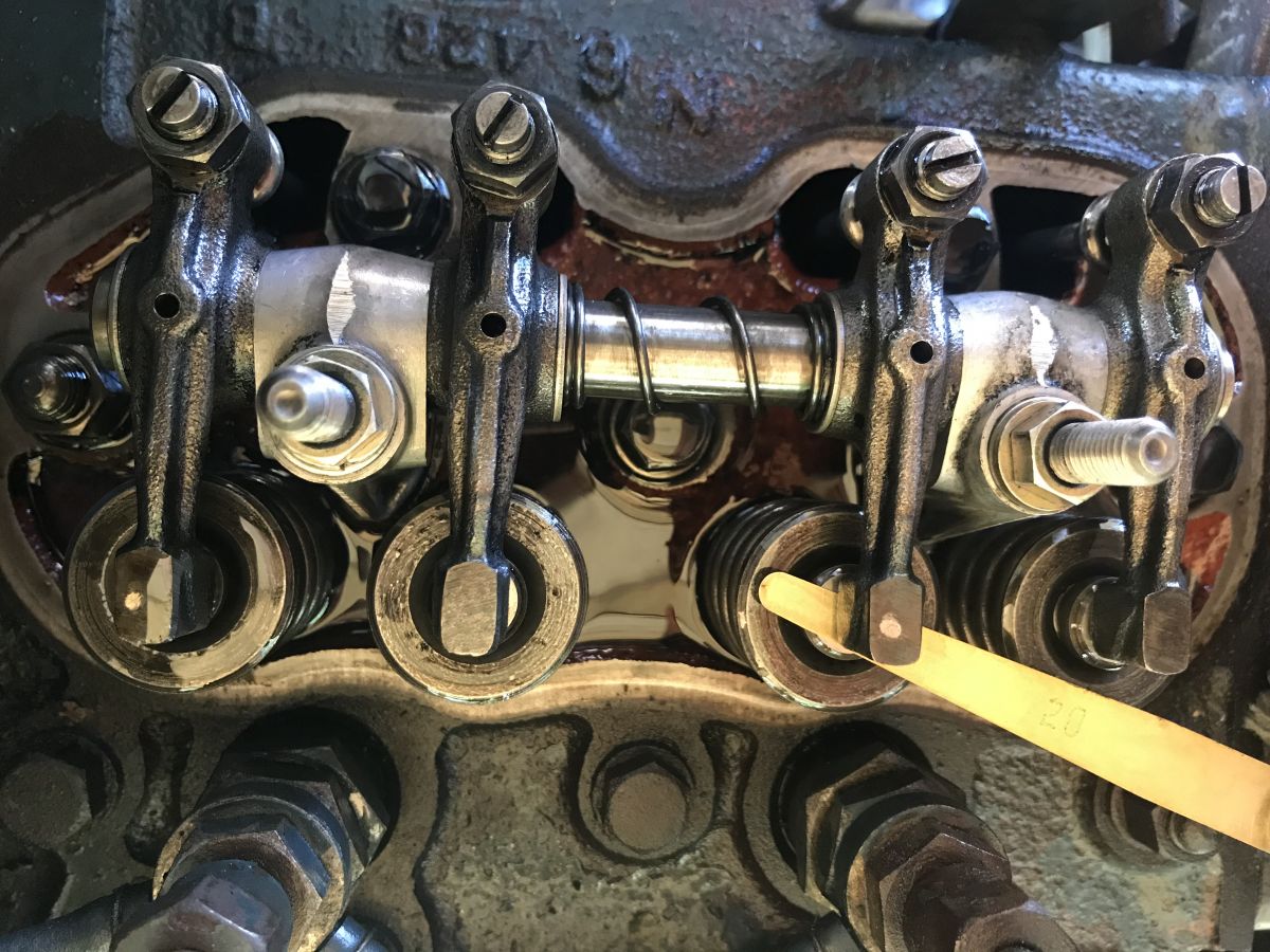

    I also checked the valve clearance, it was 0.15-0.25; I adjusted it to 0.2 all.
    I also did a filter-oil-strip service with engine rinsing (I have the impression that the belt is as old as the tractor, i.e.> 40)
    I'm waiting for the engine to start, so I'm looking for a service for the Z650 engine with a capacity of 653cc and a source to buy / add rings and gaskets - a warm request for help in this regard.
    There is a lot in the network for newer engines, but there is nothing specific about it.
    Below are some photos and a link to the movie.
    https://youtu.be/LvCyCOUdRxY

    These twin-cylinder tractors ignite badly. The first firing requires 15 seconds of glow plug heating.
    I have a L 180 with such an engine only reamed to 750ccm. The engine has a pressure similar to yours, also with a smaller one on one cylinder. When heated, the candles fires on a shot. Hot, it fires practically without heating.
    White smoke in your case is rather a problem with the injector. Under load it has black smoke. If it smokes white, unburned fuel from one cylinder goes to the exhaust and evaporates there. This may be due to lower compression pressure on one cylinder but it should be on speed and not during operation. Something is wrong. Are you sure it is running on both cylinders? You let go of the tubes on the injectors. They can run on one cylinder. Wono is going to turn, but it does.
    I have a service for the B 6000 and L 180 with such engines and boxes, but with a capacity of 550 and 750cc. as if you were interested.
    Parts on ebay without a problem., Traktor.com.pl and - www.kubota.pl here I bought heads, valves and rings. Good quality and trouble-free shipping.
    I would just wait with this engine demolition in your place.

    eksploatacja wrote:
    Your white smoke is rather a problem with the injector.
    This tractor should have 30-32 bar compression pressure. 22-25 bar is a padaka.

    The engine works with two cylinders, but it has blow-throughs, which explains the low pressure, so I will not avoid the renovation, but the question is how big it will be ...

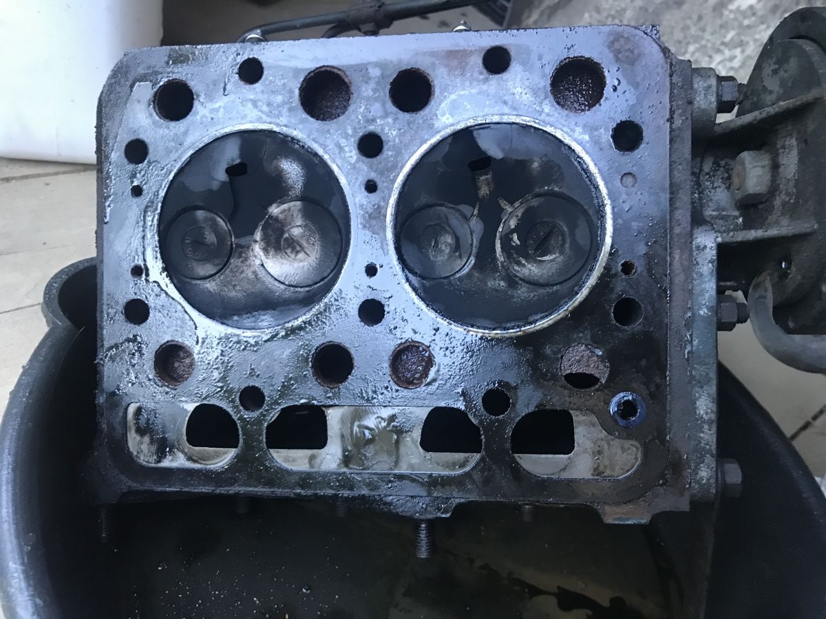

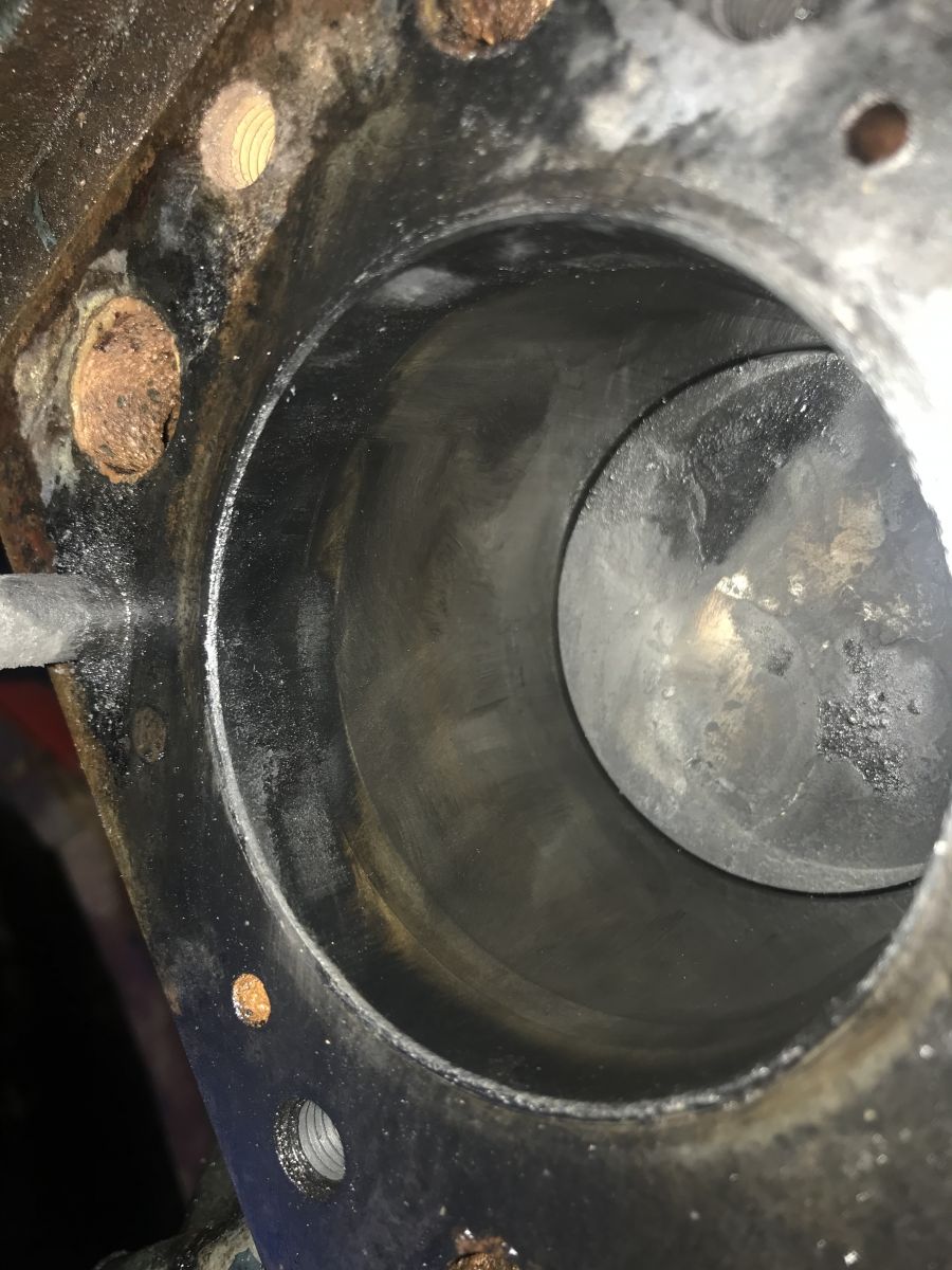

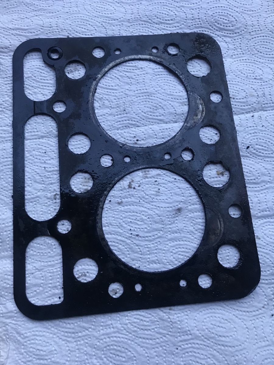

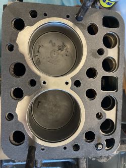

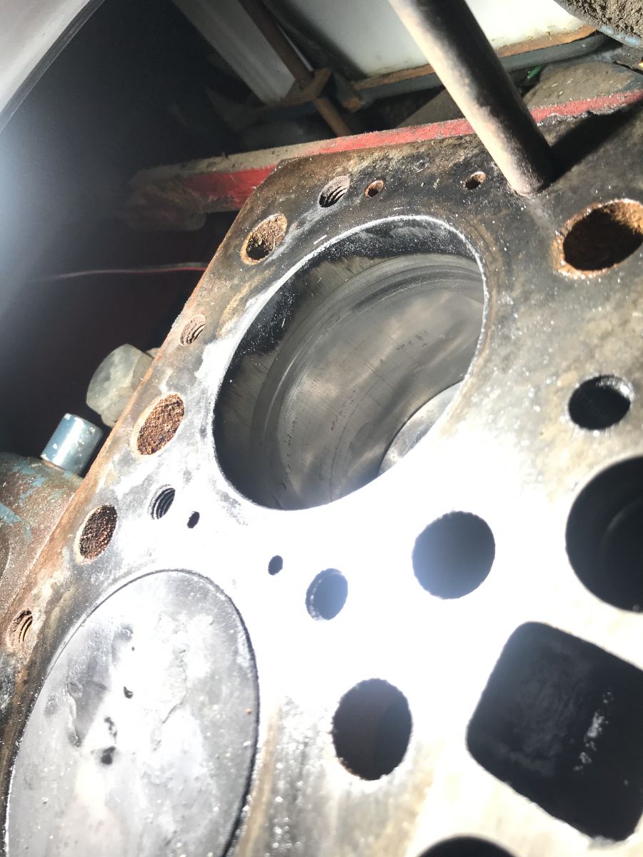

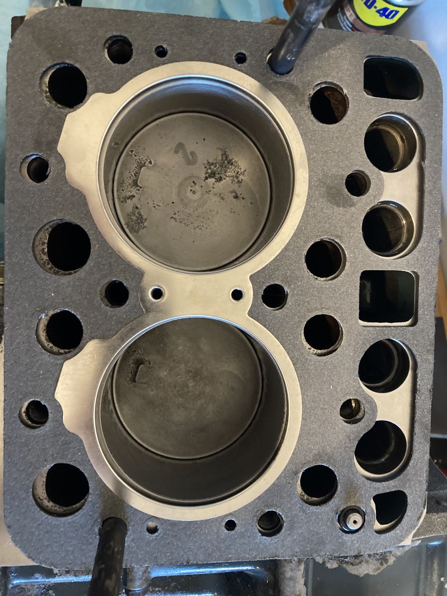

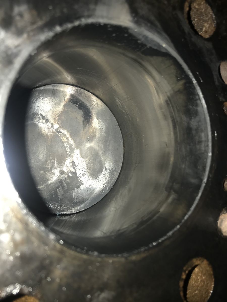

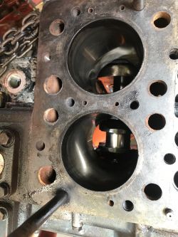

    After unscrewing the head, it looks like this, tomorrow I will remove the pistons, today there was no time for more:
    Kubota B7000 Tractor: White Smoke, Pneumothorax Blowing, Z650 Engine Issues & Solutions
    #6 18884726
    LENIWIEC_PL
    Level 28  
    Posts: 1476
    Help: 119
    Rate: 322
    Something this head gasket does not fit very well. Original?

    in this picture:
    https://obrazki.elektroda.pl/6134927600_1598131246.jpg
    you can see elegantly that the cylinder on the left is taking a lot of oil, the cylinder on the right is much better
    if there are no scratches on the cylinders you can feel under the fingernail, go ahead and put on new rings and put them together.
    Of course, the planning head, valves to run in and it is good to check the injectors at least, although they will probably need regeneration
  • #8 18885616
    Tajfun211
    Posts: 102
    Rate: 49
    There is no scratch under the fingernail, but the inferior sleeve has a small threshold and pitting, so it is rather impossible to sand or replace the sleeve:
    The gasket is original, I just put it a little crookedly.

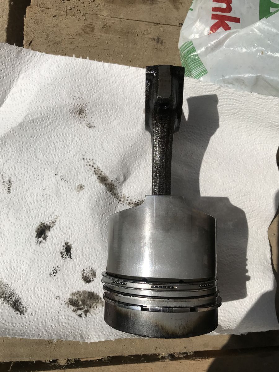

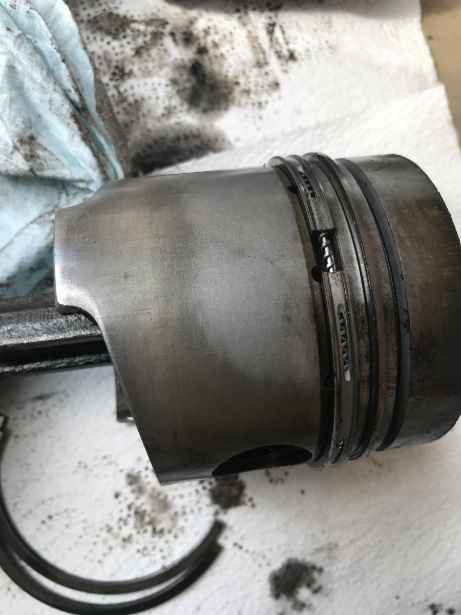

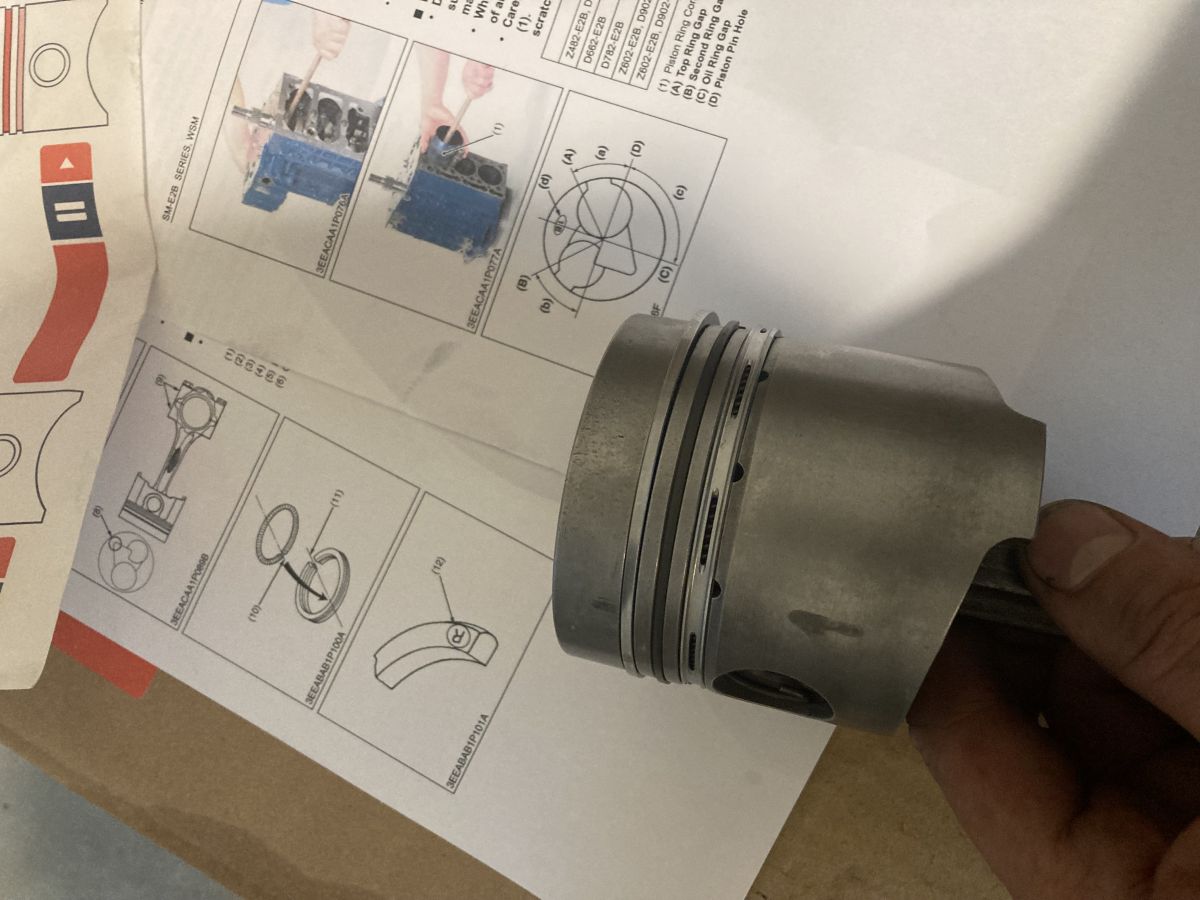

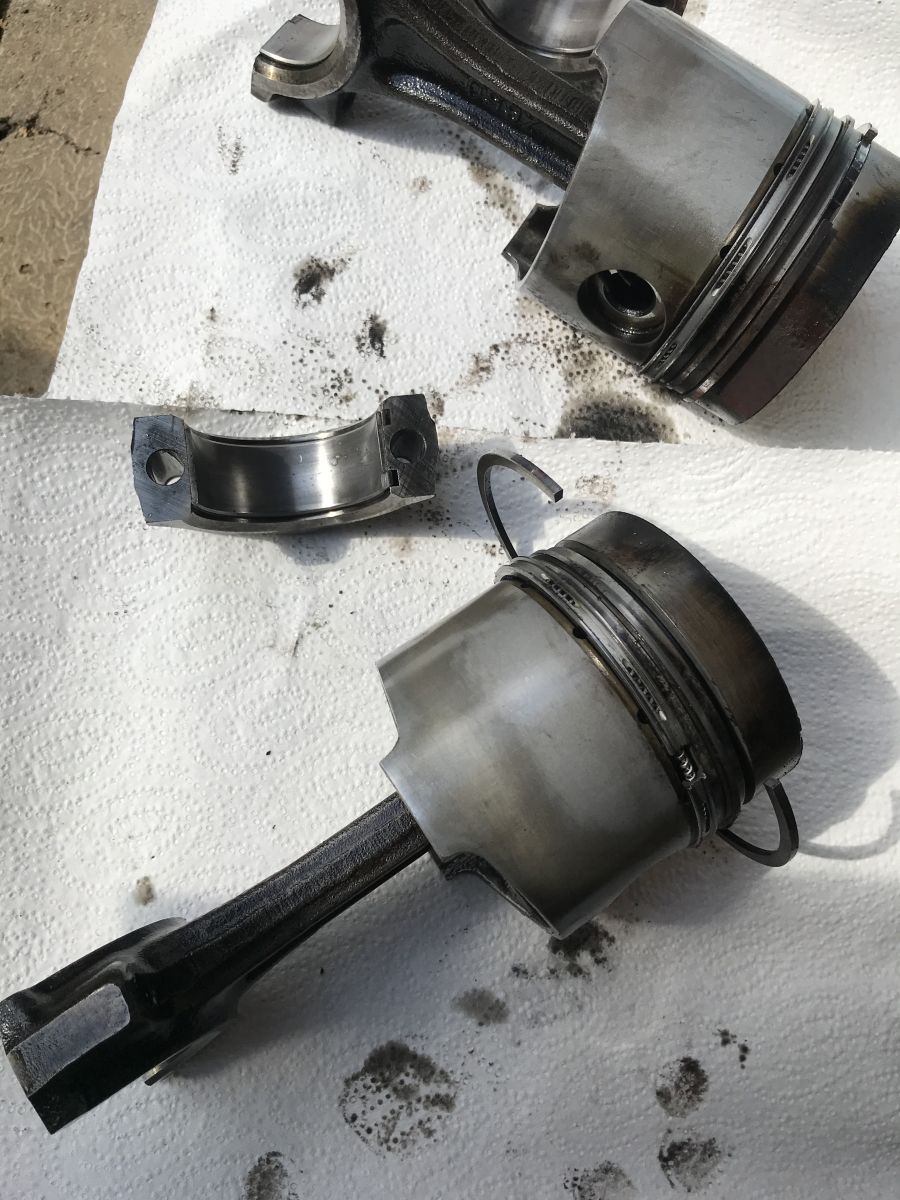

    Update after removing the engine, the first ring cracked on both pistons, the rest does not look bad, I wonder if I should replace the rings and shells ...:

    Tajfun211 wrote:
    I am wondering whether or not to replace the rings and bushings themselves.
    If you like to do twice, why not. At this stage, I would dismantle this engine into its first parts, wash everything, seal everything ...

    I wonder what could have caused my rings to break ...
  • #15 18898894
    bearq
    Posts: 4888
    Help: 414
    Rate: 1615
    They often break from overload / temperature.
    Such an engine will make you a better bet, but I recommend that you first check the availability of parts for this engine and then return the engine to the factory. If you do not find anything, let me know, I will look for something in my catalogs.
    There will be no problem with bushings because their availability is so large that you can easily fit something from another motor and there is no problem with shortening or extending it to a different size.
    Regenerating pistons after seizing will not even comment, no self-respecting plant does such a sculpture.

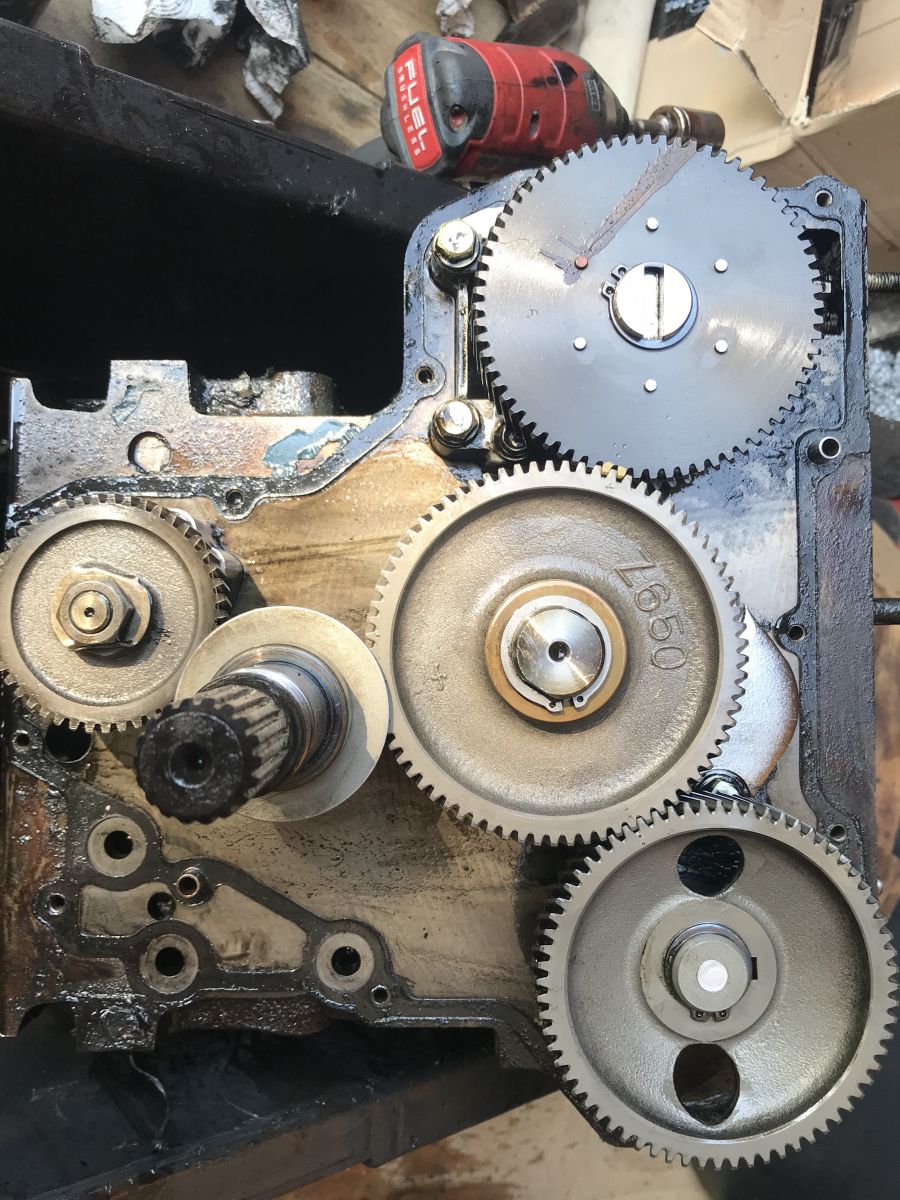

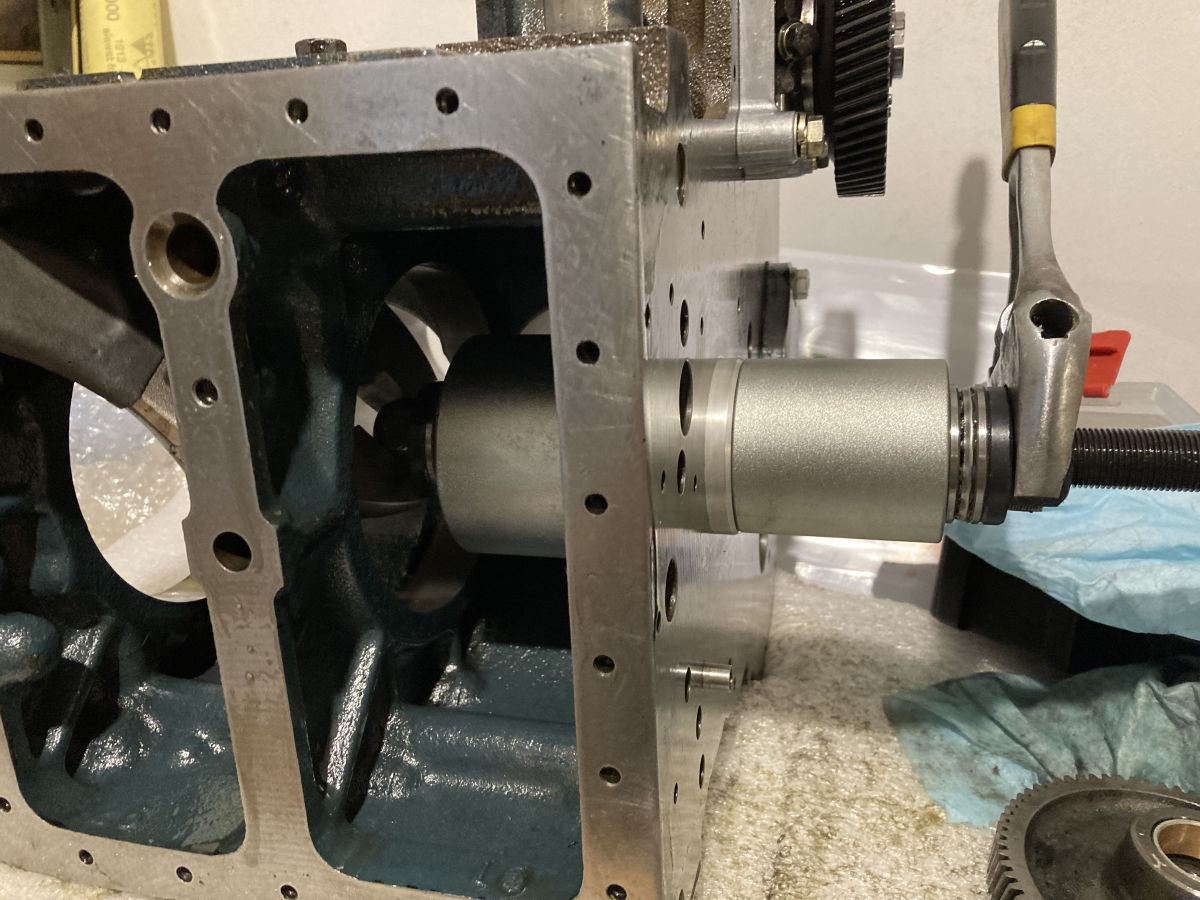

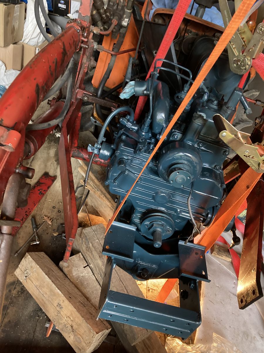

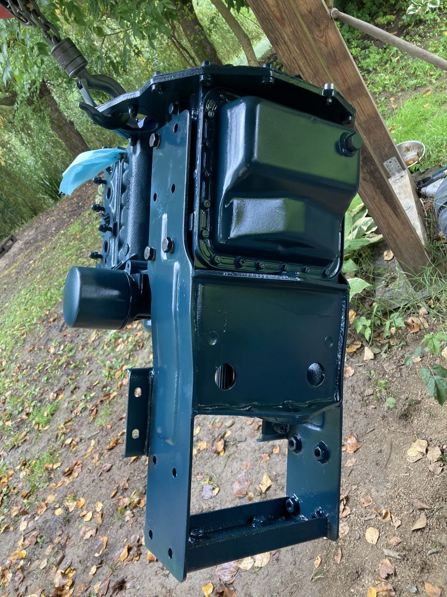

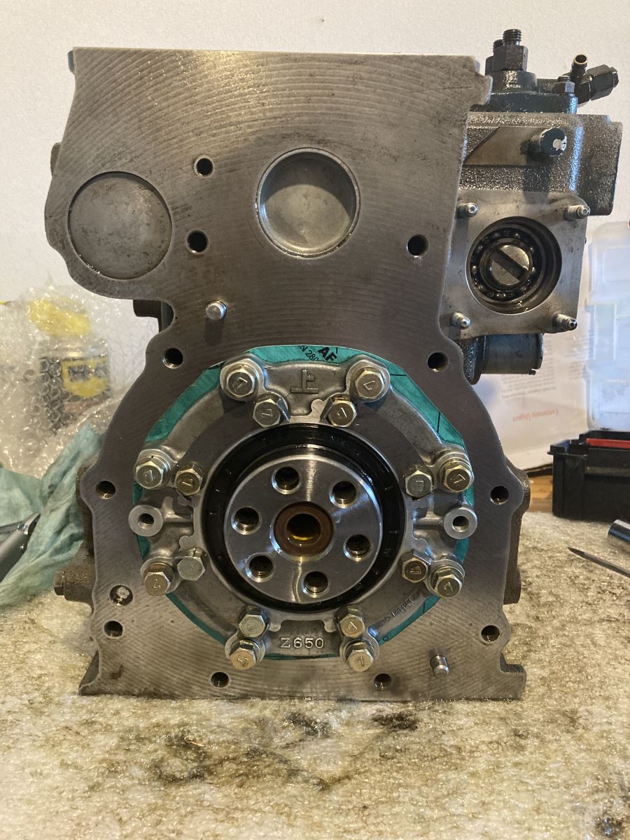

    I finally found time to dismantle the engine.
    Do you need to knock out the wedge to remove the shaft because there is a flange that blocks it ?:
  • #21 18920487
    bearq
    Posts: 4888
    Help: 414
    Rate: 1615
    Rather yes, you have to take everything apart one by one.

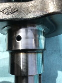

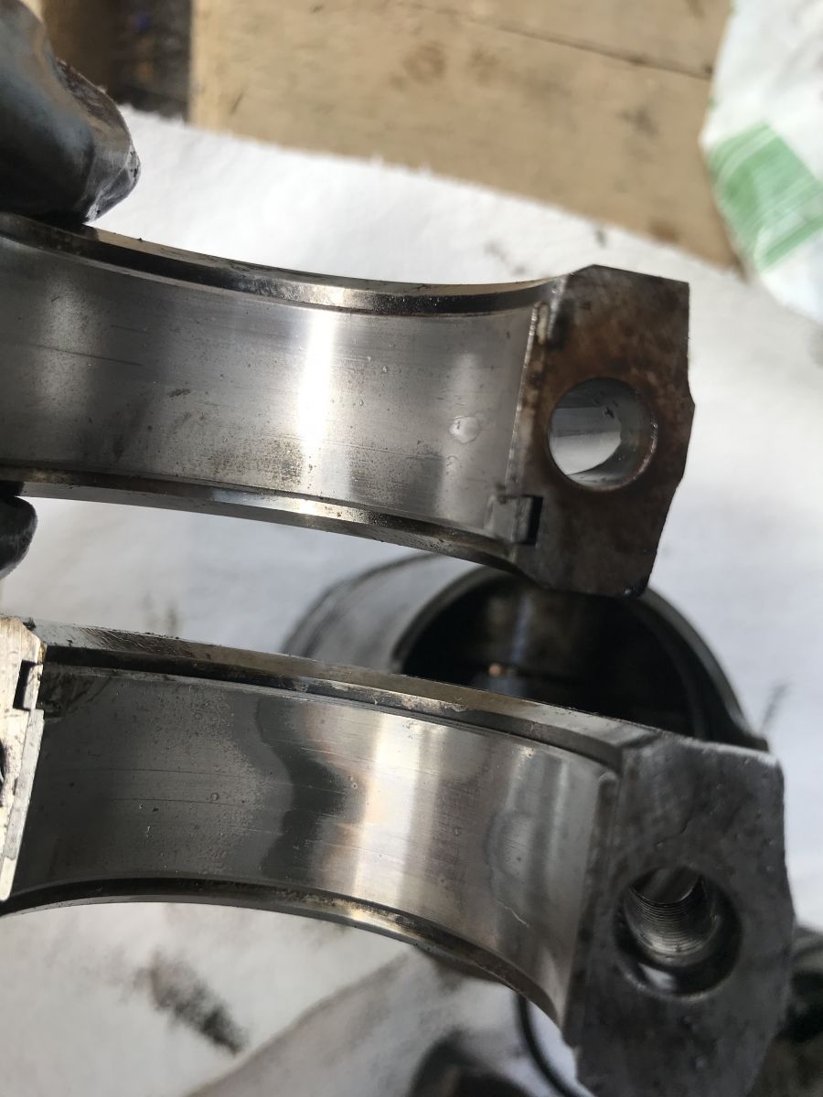

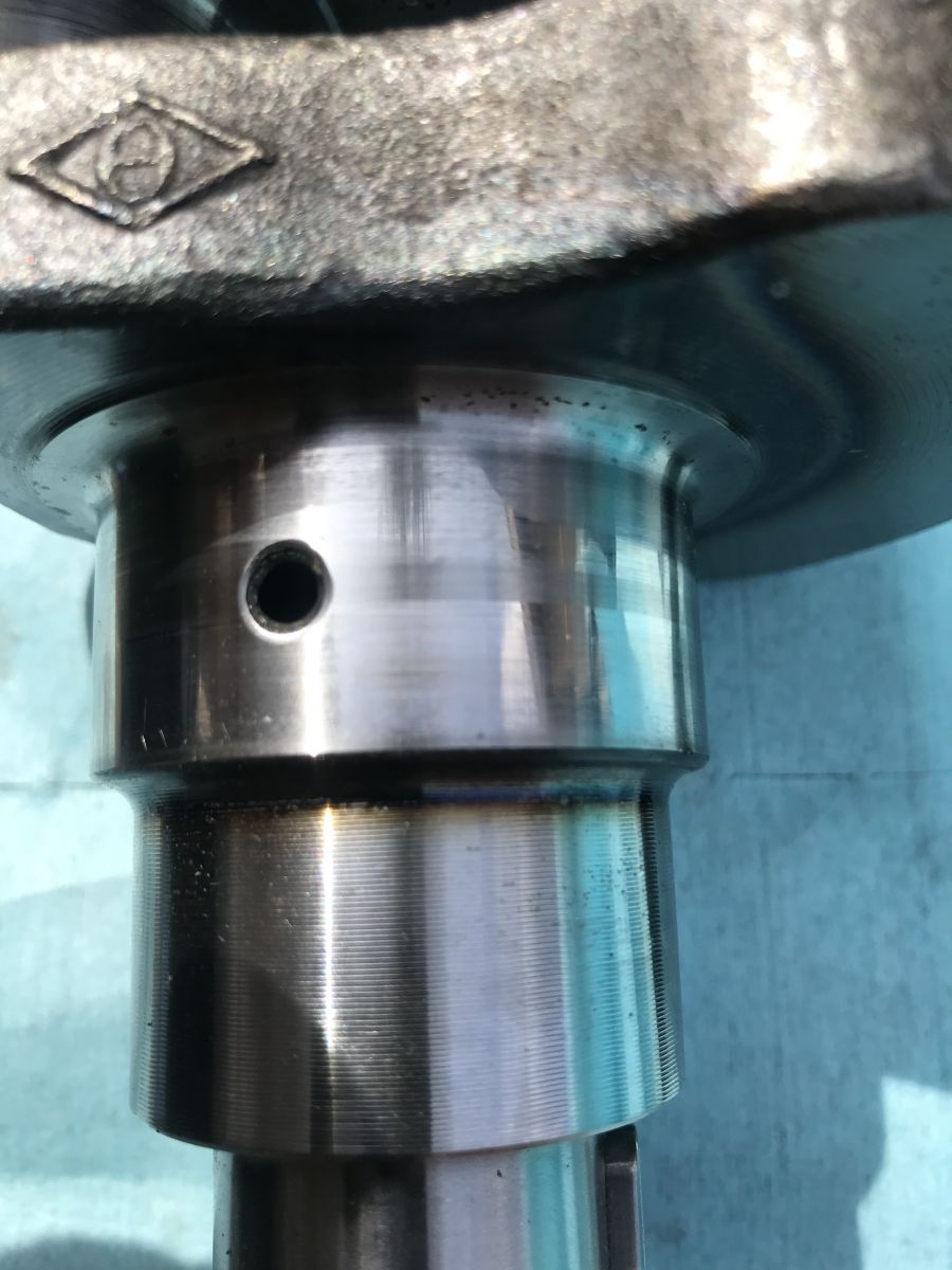

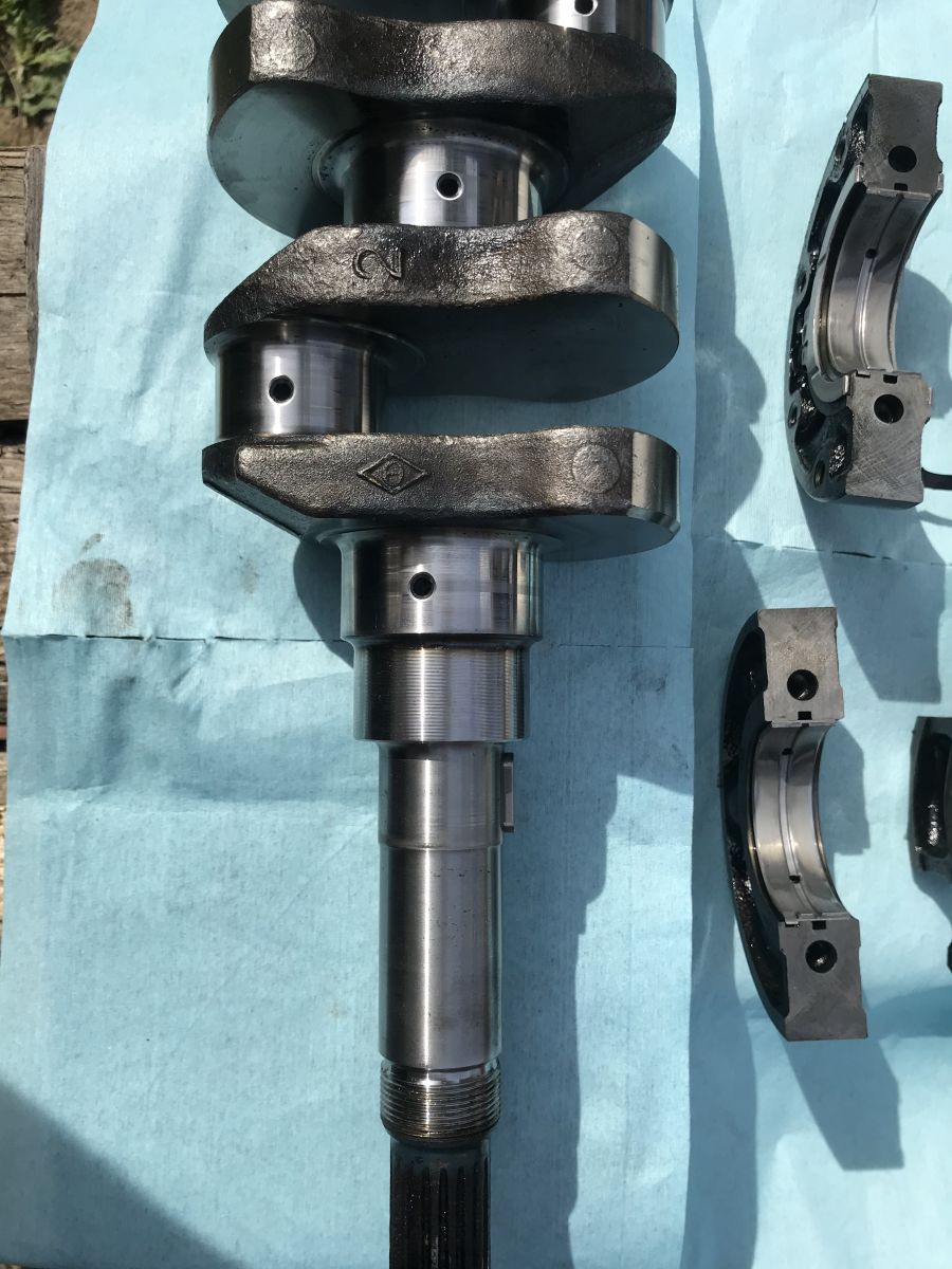

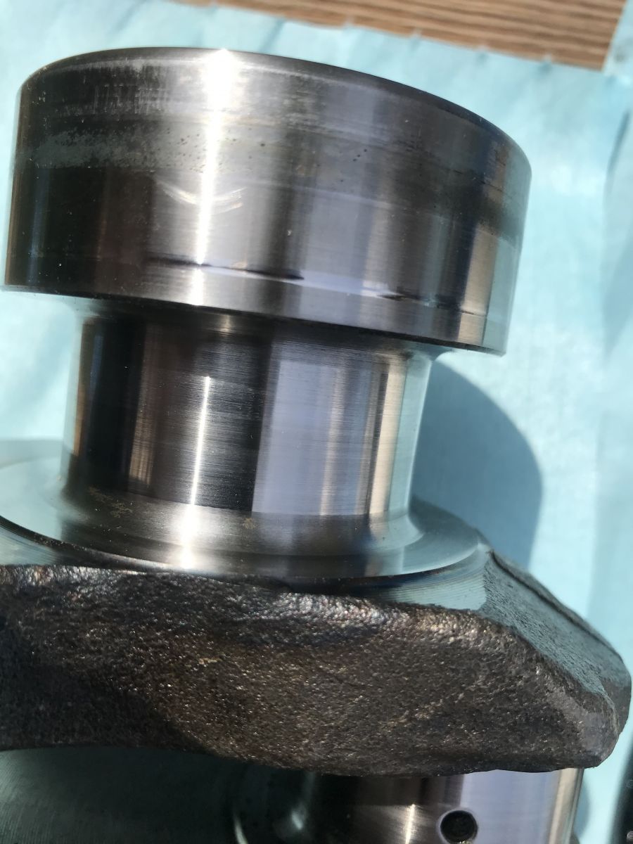

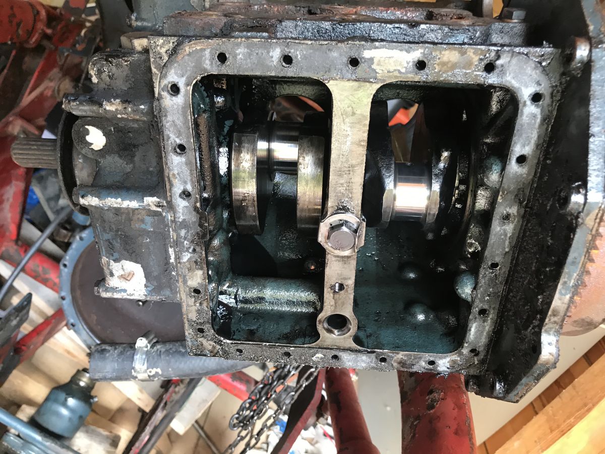

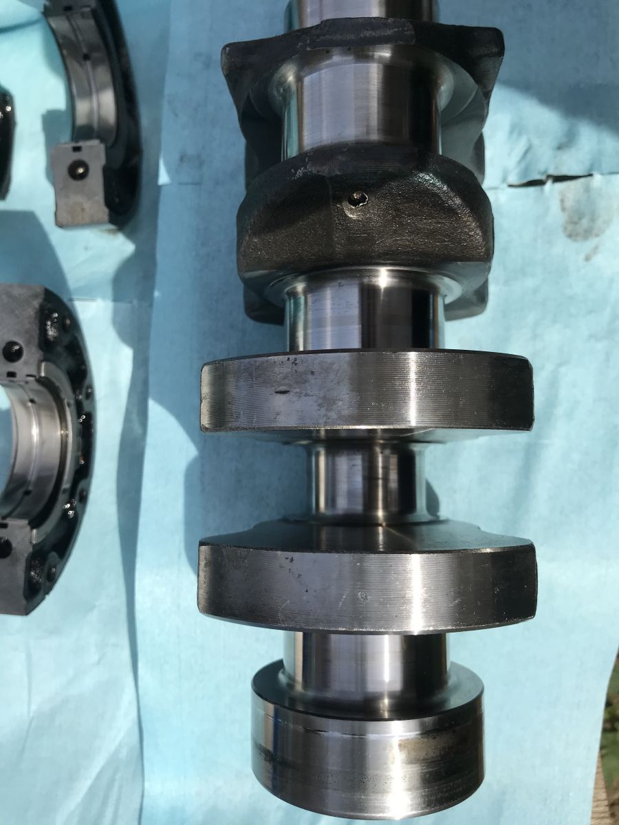

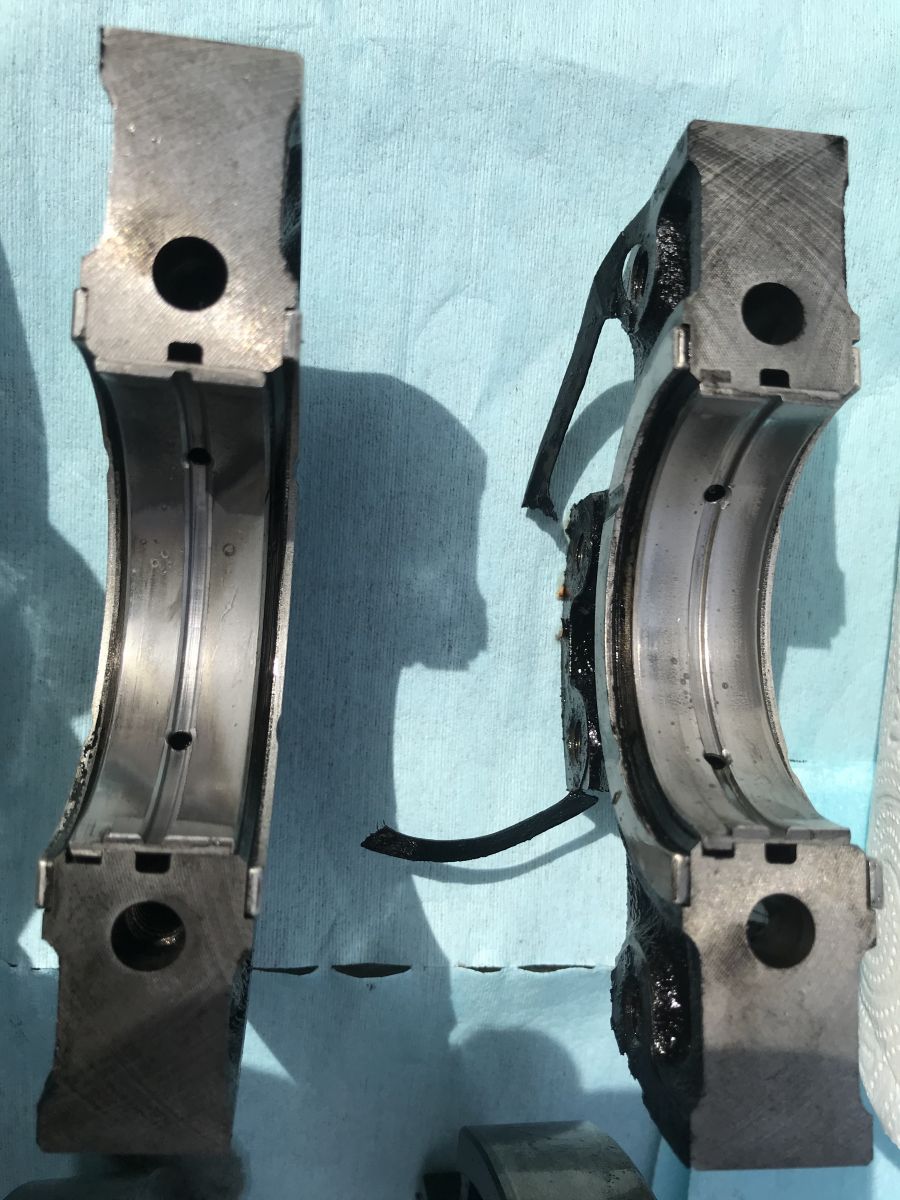

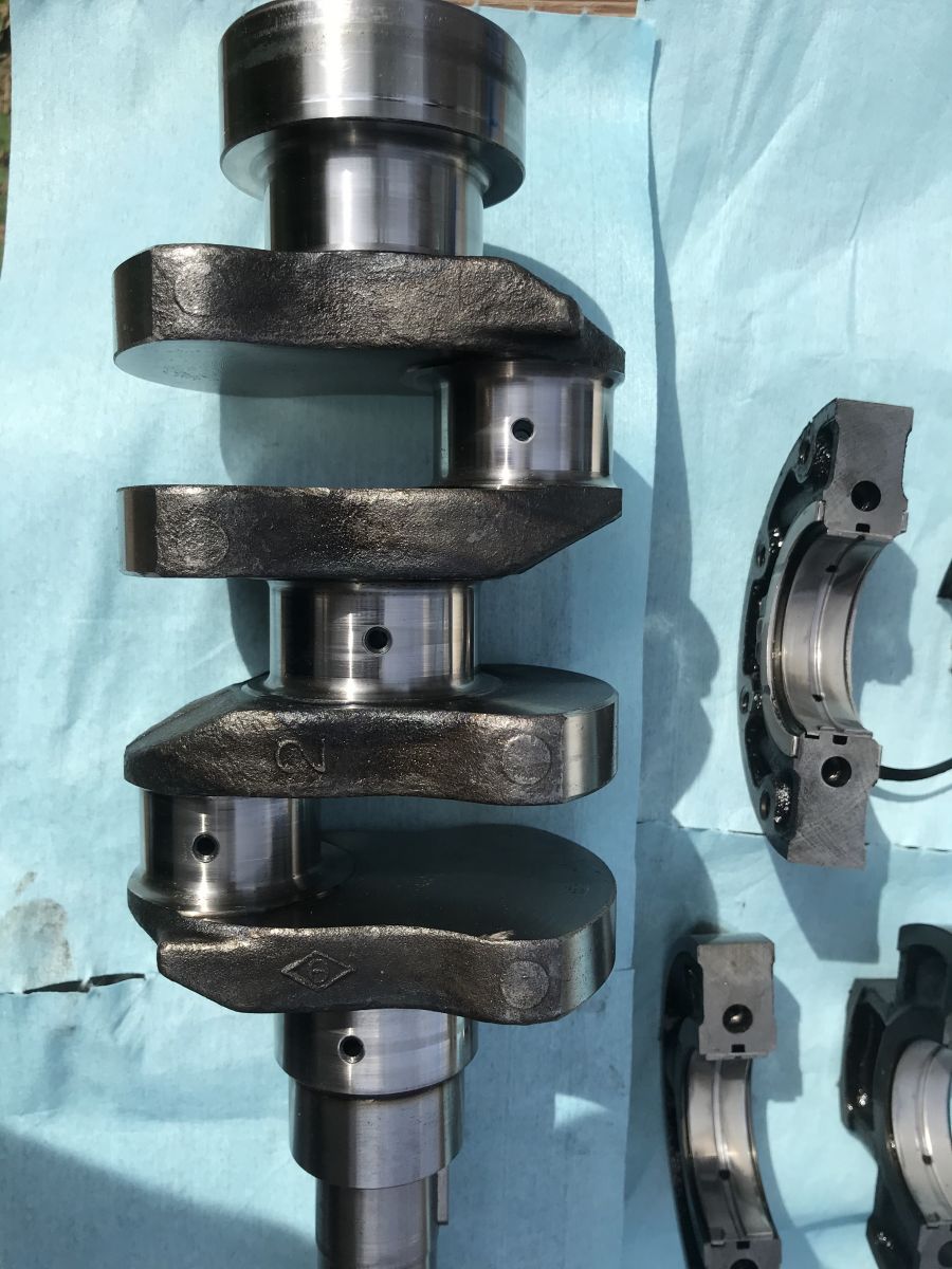

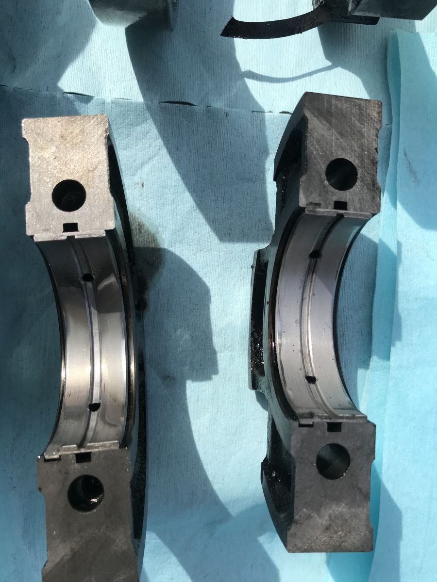

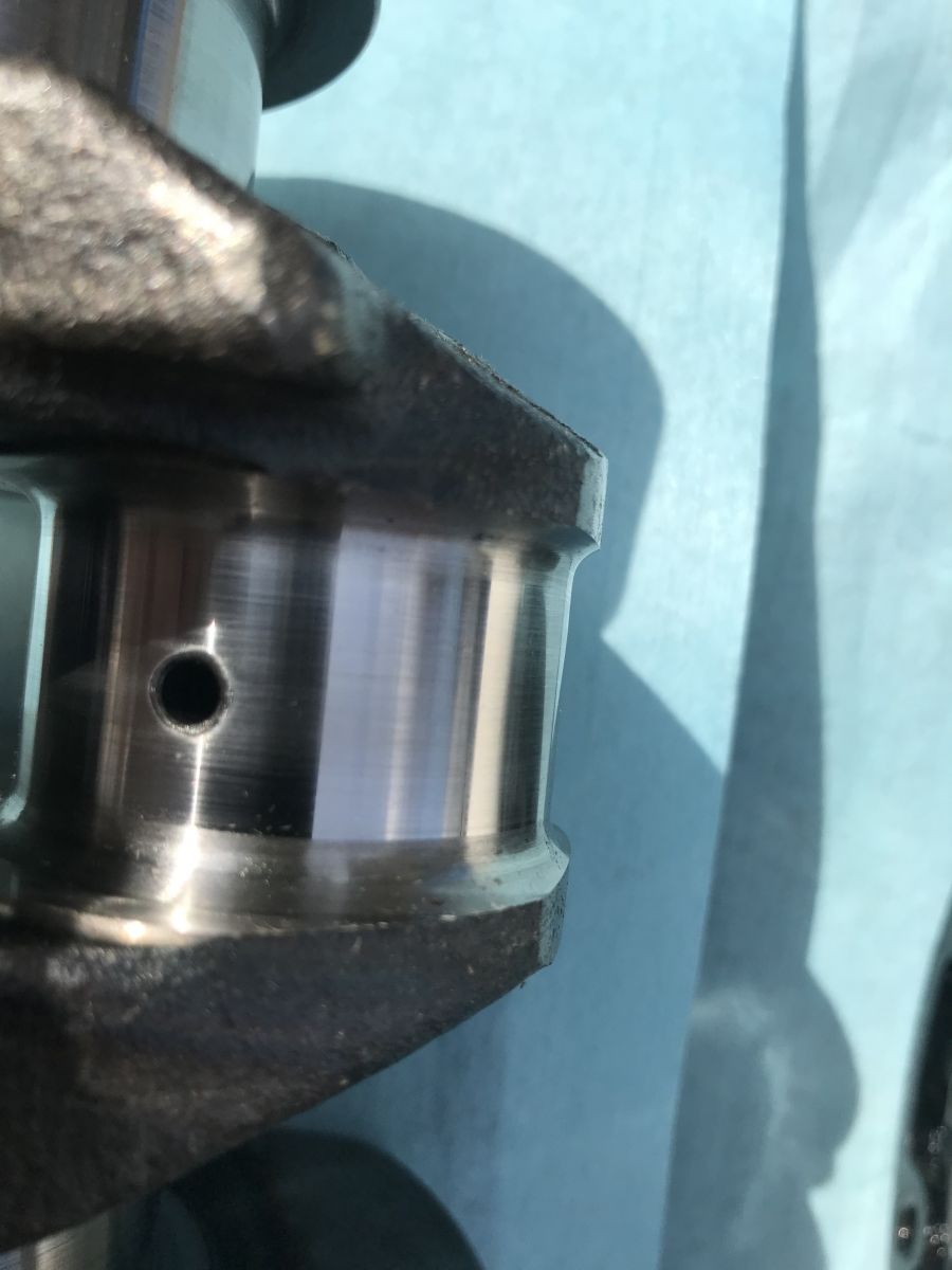

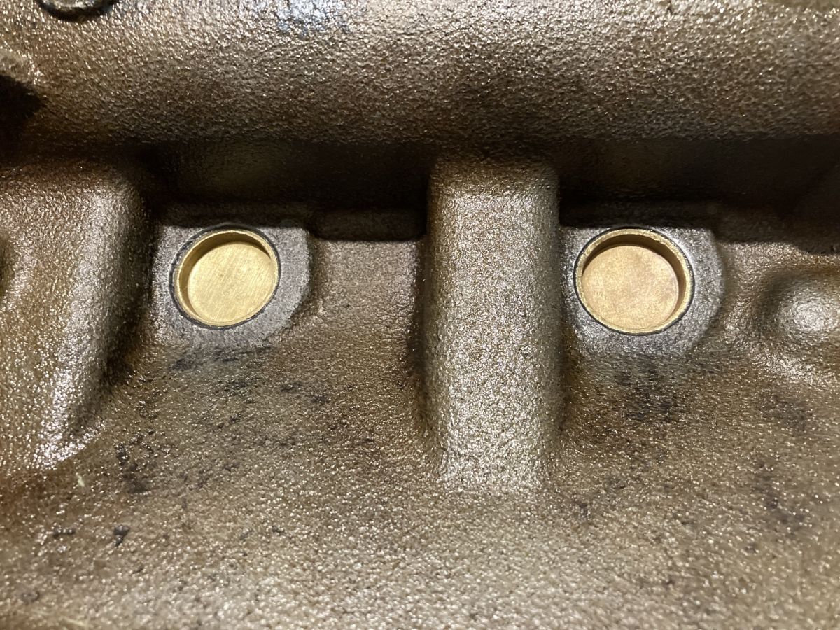

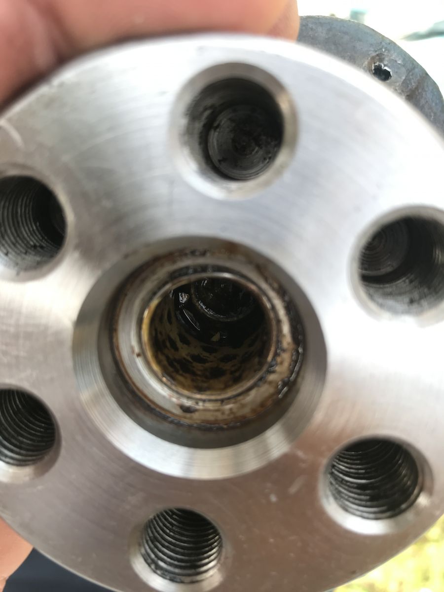

    Shaft removed, this is how it looks:

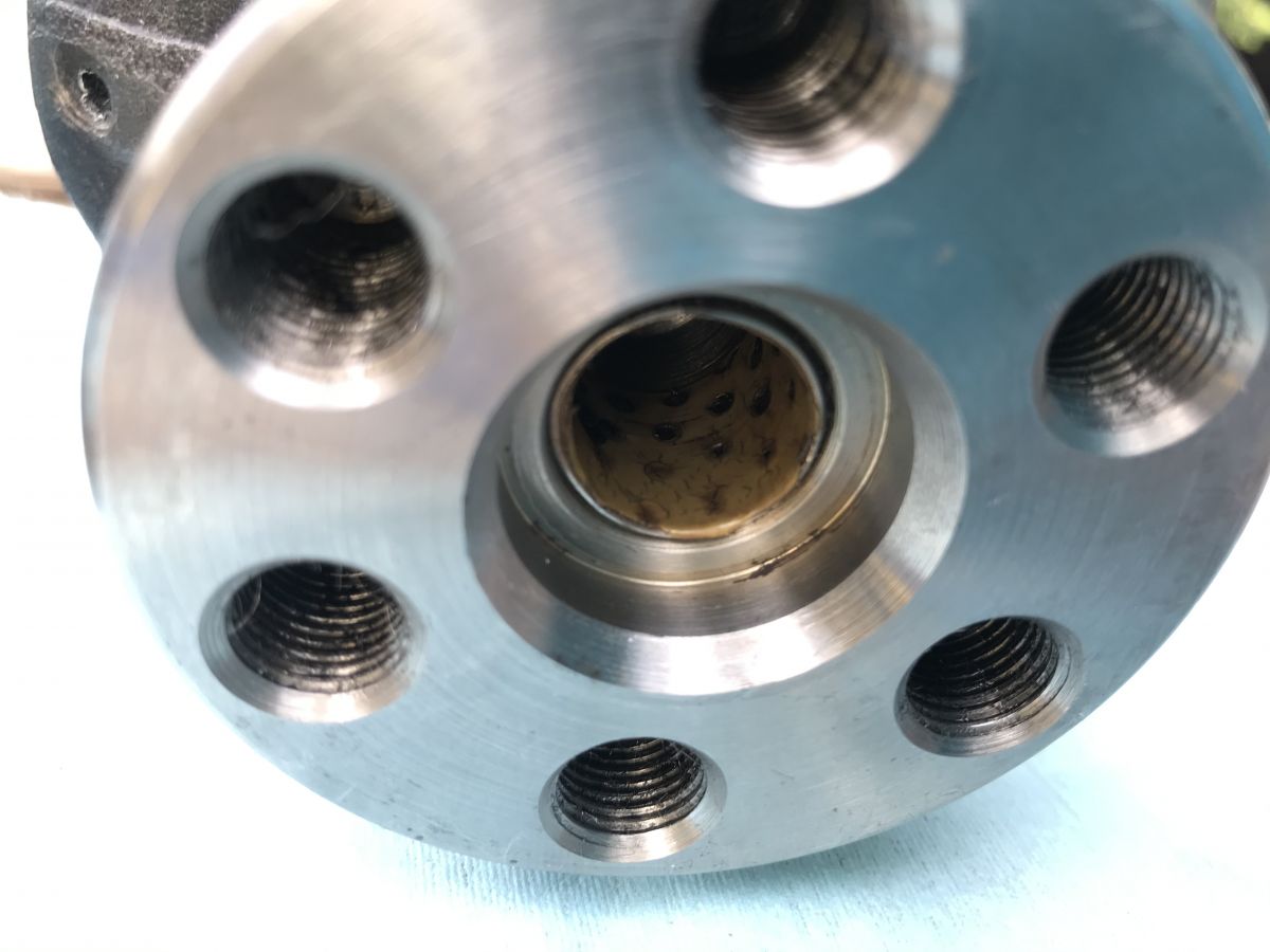

    Added after 3 [minutes]:
    I just don't know what is used where the shaft enters from the clutch side, I thought that the bearing would be there, but after removing the sealant it looks like this:

  • #23 18921768
    bearq
    Posts: 4888
    Help: 414
    Rate: 1615

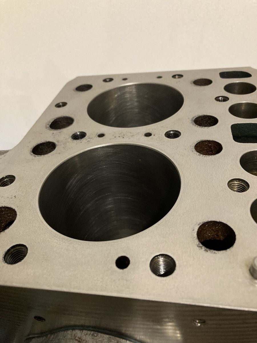

    You can see that the acetabulum is already peeling. Without measurements, nothing can be said about a shaft. In the shaft you have a sliding sleeve instead of a bearing.
    #24 18921797
    kkknc
    Posts: 23778
    Help: 1916
    Rate: 6716
    Your engine is totally worn out. Shaft for measurement. You can see worn cylinder liners with no traces of honing. For this seizure scratches. The pistons have a worn adaptation layer. And no one knows what the clearance is on the shelves and you want to put them back on.
    You can see elegantly that you lack knowledge about internal combustion engines and their repairs ...
    And so totally .....
  • #25 18922897
    Tajfun211
    Posts: 102
    Rate: 49

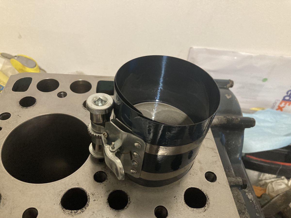

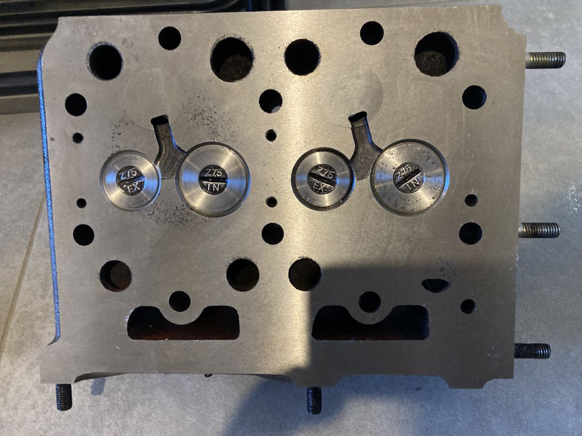

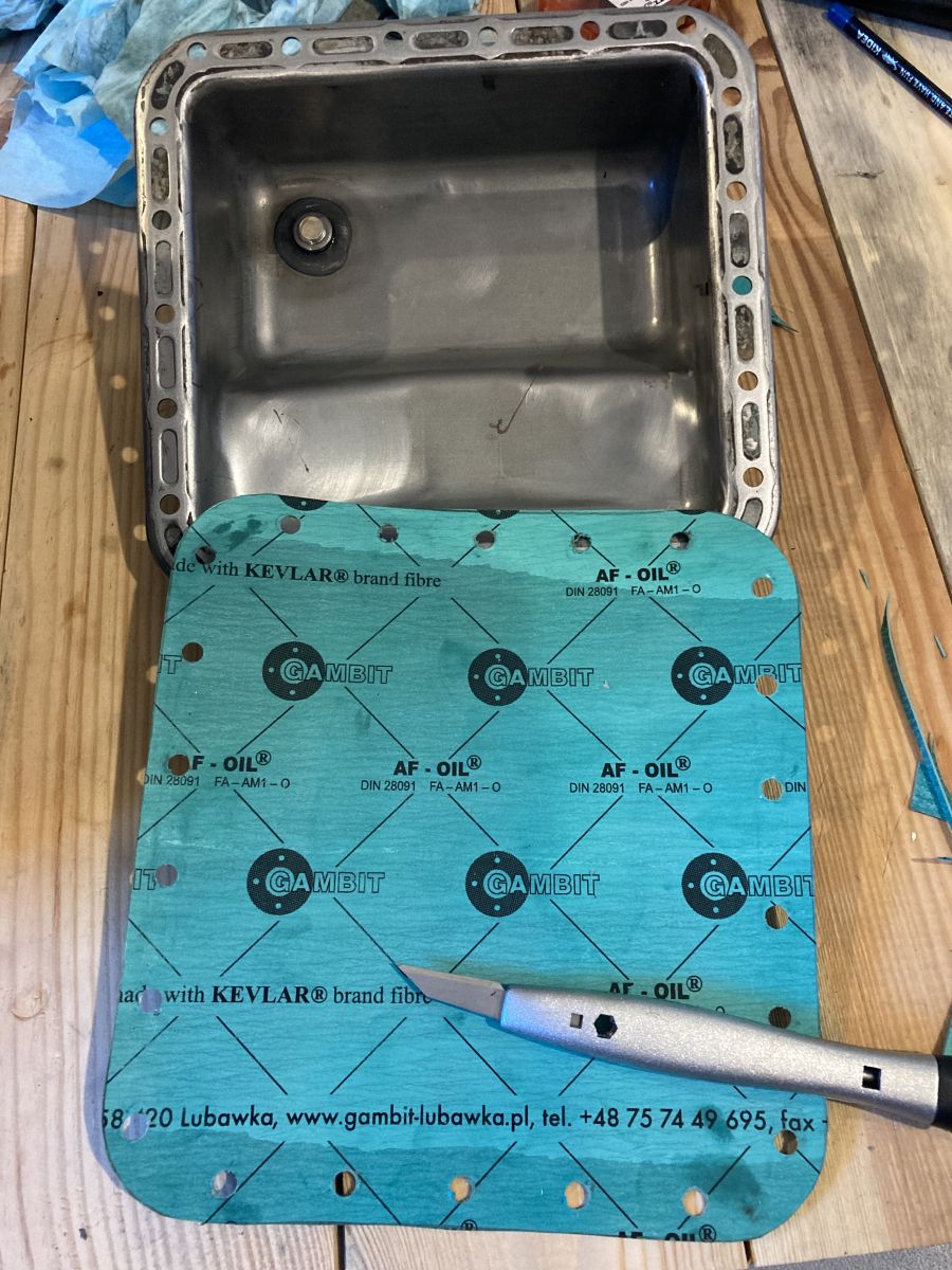

    The plan is this:
    1. The engine block will be put into bushings under the current pistons and new rings will be selected.
    2. Shaft to be checked, new main and crank bushings.
    3. Head - valve seats / valves for running-in / milling check.
    4. All seals and shaft / valve seals new plus this new sleeve bearing.
    5. Seat shells and all wheels to be checked.
    What else needs to be done / checked?
  • #26 18922967
    bearq
    Posts: 4888
    Help: 414
    Rate: 1615
    Look for new pistons, you still have to do connecting rods, injectors, pump, check the plane of the block and probably the shaft for grinding. Get the repair manual even from another tractor and although you read it, you will have a picture of more or less what else to pay attention to or check.

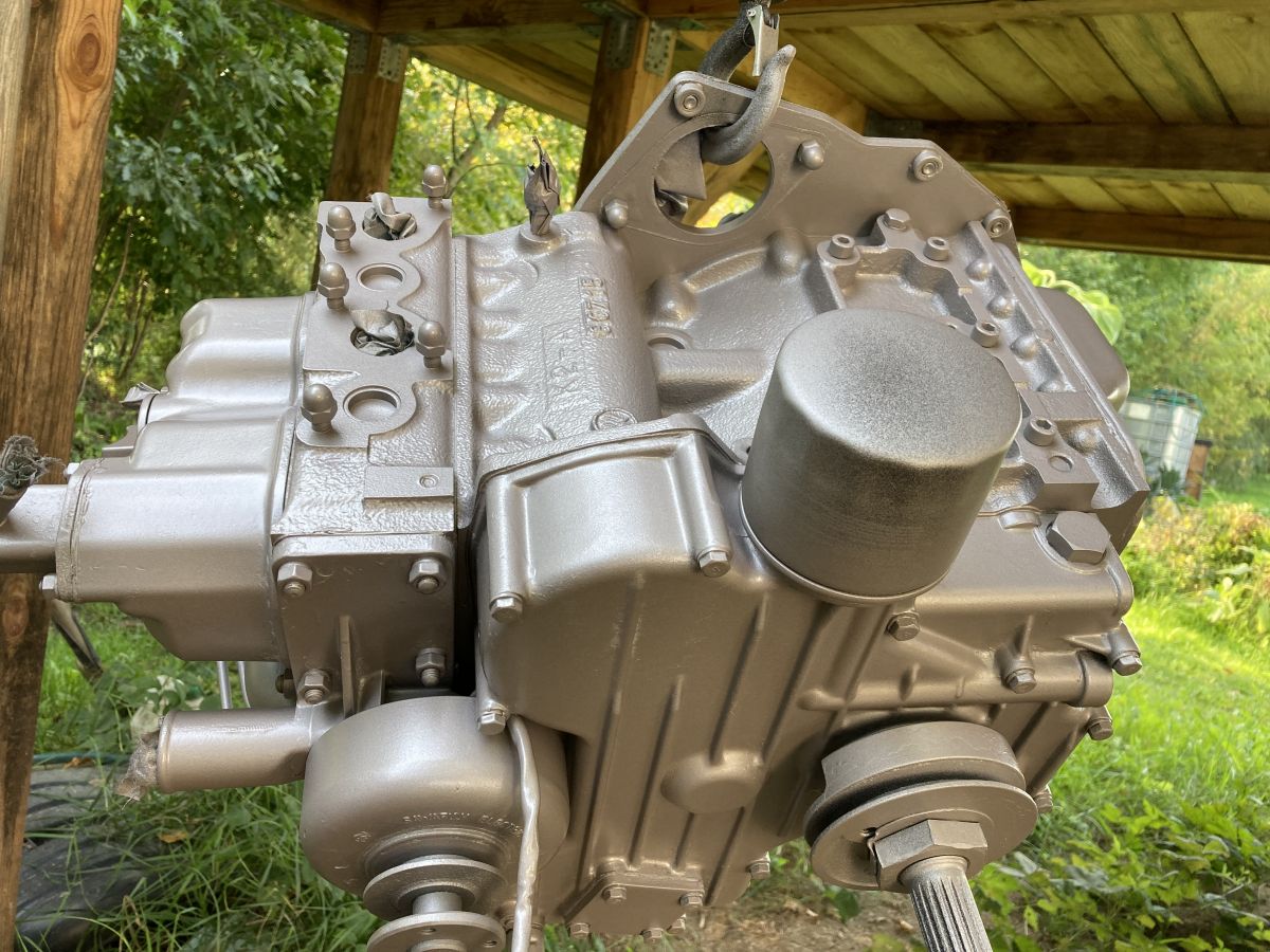

    So far, I have not found a dedicated manual for the Z650, but I have the Z482, this is the closest engine for which I was able to find documentation.
    The manual helped me a lot in understanding the structure, but I can't really be guided by the tolerances and values given there.
    In the attachment, the instruction I am writing about.
    It is possible that it has overheated, this engine has no water pump or thermostat.
    The heat exchange takes place passively on the principle of a thermosiphon, while the signaling of high temperature is a whistle mounted on the overflow pipe, but the copy I have does not work ...
  • Complete Kubota B7000 engine rebuild and first measurements
    #29 19614433
    Tajfun211
    Posts: 102
    Rate: 49
    Hello, I finally found time to assemble the engine so I would like to share some information about what has been done:
    - I found documentation for this model on Japanese servers, which was very useful when assembling:
    PL_B700...pdf (2.99 MB)You must be logged in to download this attachment.
    PL_B700...pdf (2.43 MB)You must be logged in to download this attachment.
    PL_B700...pdf (2.2 MB)You must be logged in to download this attachment.
    PL_B700...pdf (2.47 MB)You must be logged in to download this attachment.
    PL_B700...pdf (1.77 MB)You must be logged in to download this attachment.
    B5000-700..3).pdf (21.82 MB)You must be logged in to download this attachment.
    - sleeve replacement and block planning:
    - replacement of brokers (two of them were rotten and clogged with some kind of putty):
    - replacement of the bushings, shaft checked, everything OK:

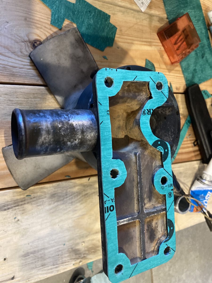

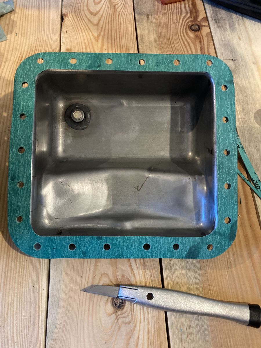

    - making gaskets, replacing seals:
    - replacement of rings
    - replacement of guides and valve seals, milled seats and lapped, planned head and of course a new gasket:
    Kubota B7000 Tractor: White Smoke, Pneumothorax Blowing, Z650 Engine Issues & Solutions Kubota B7000 Tractor: White Smoke, Pneumothorax Blowing, Z650 Engine Issues & Solutions
    - painting and assembly:
    - starting the engine and first measurements:
    https://youtu.be/zcr5NfJ-Y_k
    https://youtu.be/nDrM_w1pgSs
