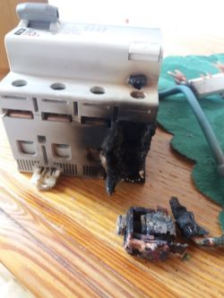

    Why it is "not allowed" to use 3-phase differentials in 1-phase instal Why it is "not allowed" to use 3-phase differentials in 1-phase instal
    Weeping and gnashing of teeth today.
    Over 5,000,- the dog went up the ass.
    So I propose to chill with paeans over a solution from the "obvious malpractice" category.

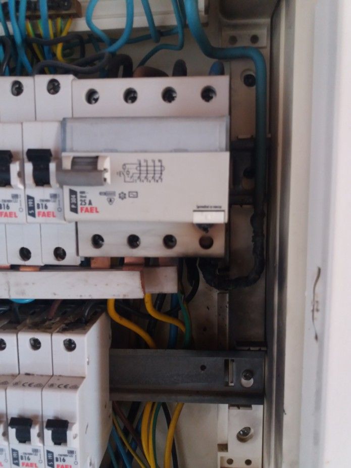

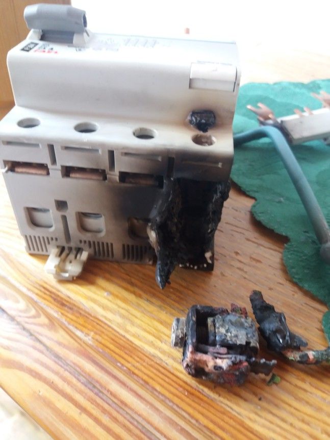

    How does this relate to the topic? A colleague in the next topic shows a photo, but the reason for burning the differential is completely unrelated to the topic :) Untightened cable (loose) and such an effect. But how does this relate to the topic?
  • #17 18913604
    kkas12
    Posts: 17402
    Help: 1076
    Rate: 4313
    adversus wrote:
    .... but the reason for burning the differential is completely unrelated to the topic ....
    For a layman, maybe not, but for a (conscious) electrician, it is not the cause that is important, but its effect.
    So praise your pseudo-saving solutions, just remember that dogs eat cheap meat and what was acceptable at the beginning of the RCD era does not have to be used in its unchanged form (or even should not) today.
    So sorry my friend, but photos will always be found where a solution that is not suitable for the 21st century will be propagated.
    Personally, I tolerate a four-circuit RCD only in the power supply of a small construction site.

    Exactly. The problem begins when the user connects the existing installation (with one four-pole RCD), e.g. plugs in induction hob, ceramic (with heaters).
    All the boards I have seen are powered from two phase voltages, and the connection power of these boards is mostly about 7.2 kW.
    Such a device at maximum power forces the current consumption of about 15.5A per phase (rms value), then what current flows in the neutral?
    Average 26.9A.
    I wrote on average because due to the work of a household appliance service technician, I happened to capture with clamps the current flowing through the N field (in RCD 4-P 25A / 30mA) of the order of 35A, because there was still a washing machine, dryer, electric kettle ... on the same phase used in same time by induction.
    kkas12 wrote:
    Here, too, it worked flawlessly for about twenty years.
    Such a view is no stranger to me, after firing the neutral, devices with low power consumption were especially hit. Where, as it turned out, the power consumption was distributed asymmetrically, after adding the above-mentioned devices by the existing RCD.
    To sum up, the neutral (in the section after the N/PE division) is the most and most frequently loaded cable in a household installation. At the same time, it is so important in the case of a 3-phase connection (in the event of a break) not to hurt yourself in the future.

Edge case: What happens if RCD terminals loosen?
Loose neutral screws burned an RCD and caused €5,000 damage after 20 years of ‘flawless’ service [Elektroda, kkas12, post #18913539]
