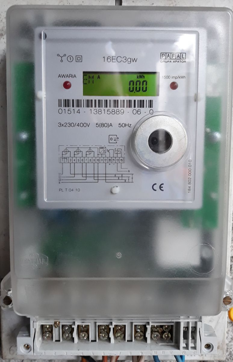

    Let me revive the topic because this week I was a participant in a conversation with an "inspector" from ZE during the supply of voltage (installation of the meter) to the facility. TT overhead network, pole measurement, 4-core WLZ earth cable for the powered building.
    Inspector - well TT is here so 4 wires are enough. But when we modify it on TN-C, it cannot be used because it does not have 5 wires.
    Electrician - why?
    Inspector - because our PEN conductor from the pole must be separated in front of the meter into PE and N.
    Electrician - why can't there be PEN all the way to the facility?
    Inspector - because the meter is a separable element, it breaks the continuity of the wire and it can no longer be treated as a protective one.
    What do you say to this argument? The measuring and junction box (from the supplier) actually has a PEN conductor (from the pole) connected to the mini rail with the output to the meter, functional earth electrode and one more "eye". Apparently on the recipient's PE.
    I am asking for calm answers.

    Kind of right, but there are probably several such connectors on the way from the transformer to the PEN meter. The PEN counter will not disconnect. Except for damage to the clamp. But that could happen anywhere in front of the counter.
    The second thing. If I have a switchgear located 60 meters away from the junction box, the 60 meter PE will work well?
    This pseudo electrician probably did not see a diagram of the meter.
    Whole life with crazy people :please:
