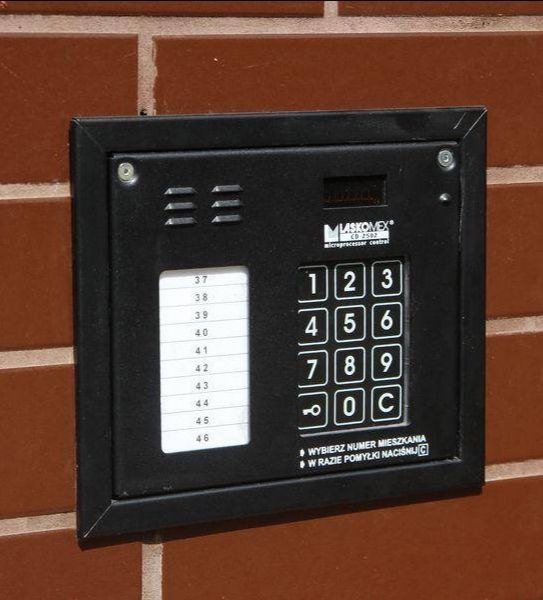

  • #5 18948485
    ptaszynka84
    Posts: 10
    Rate: 7
    How to silence a loud intercom and change the ringtone?
  • #6 18948561
    Ircys
    Intercoms specialist
    Posts: 6959
    Help: 1340
    Rate: 2078
    This uniphone does not have the factory option to mute the bell. The easiest way is to buy a uniphone with this option.
    Give us a photo of the cassette at the front door from which you are called, and we will tell you what to buy.
    Regards

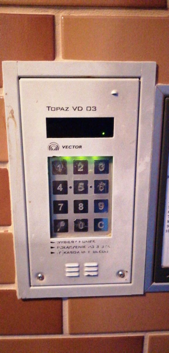

  • #7 18948574
    ptaszynka84
    Posts: 10
    Rate: 7
    This is the type of panel like the attached photo. How to silence a loud intercom and change the ringtone?
  • #8 18948588
    Ircys
    Posts: 6959
    Help: 1340
    Rate: 2078
    It`s not about the type, because we know the types. It`s about taking down YOUR tape.
    Regards

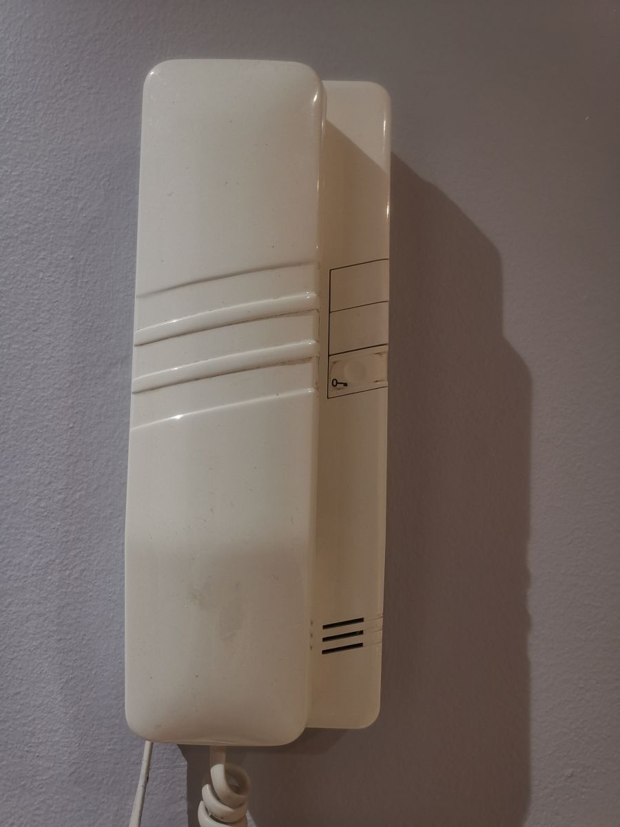

  • #9 18948619
    ptaszynka84
    Posts: 10
    Rate: 7
    Ok, ok, I`ll do it in the morning
    Added after 7 [hours] 55 [minutes]:
    This is my intercom
  • #11 18958569
    ptaszynka84
    Posts: 10
    Rate: 7
    Thank you very much for your help. The intercom came and works and you can finally turn down the volume. A nice solution is that the mute is outside the intercom and you don`t have to unscrew it :)
    I have an additional question: can it be additionally connected to this intercom so that it produces sound when someone enters the code into the intercom downstairs? The cable coming out of the wall has 4 wires, green, blue, brown and white. Blue is connected to F- and green to + and two are loose. Can they be connected somewhere to make a sound when the code is entered?
  • #12 18958976
    Ircys
    Posts: 6959
    Help: 1340
    Rate: 2078
    In this intercom, confirmation of code use is set programmatically, so no additional connections are needed.
    If you don`t have it turned on, to run it you need to perform a somewhat annoyingly complicated procedure described in the manual: https://www.elektroda.pl/rtvforum/topic2573702.html#12334189
    It`s about the point. 11 function
    Regards

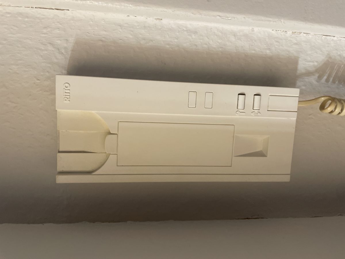

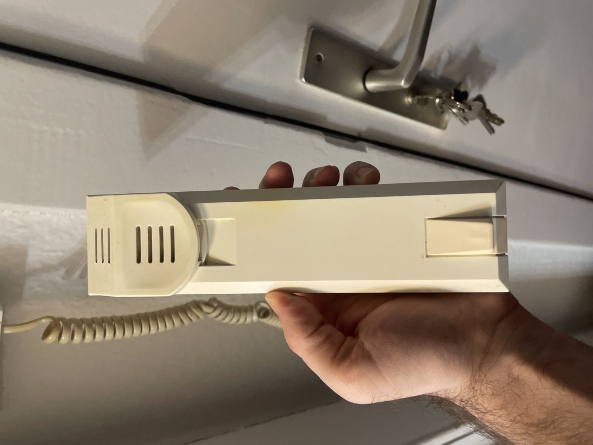

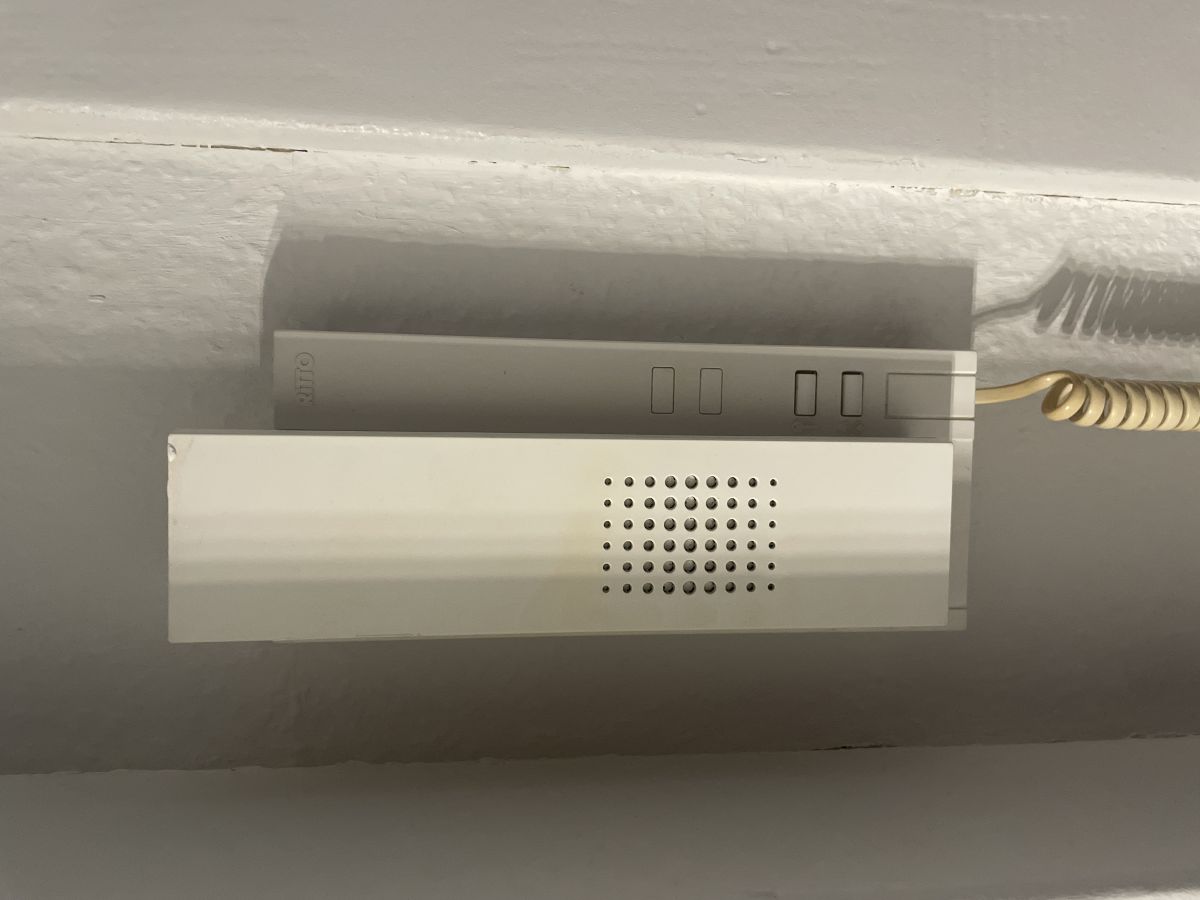

    The intercom is terribly loud and frightens my child. White intercom mounted on a wall with a visible handset. .
    Added after 1 [minute]:
    White intercom on a wall with several buttons and a coiled cable on the side. .
    Added after 57 [seconds]:
    A person holding a light-colored intercom handset with a visible coiled cord. .

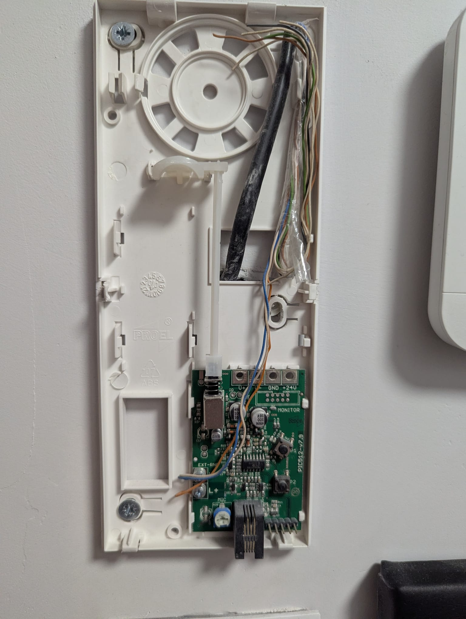

  • #17 21322128
    Ircys
    Posts: 6959
    Help: 1340
    Rate: 2078
    Please remove the uniphone top casing and take a picture of the insides so you can see the connections.

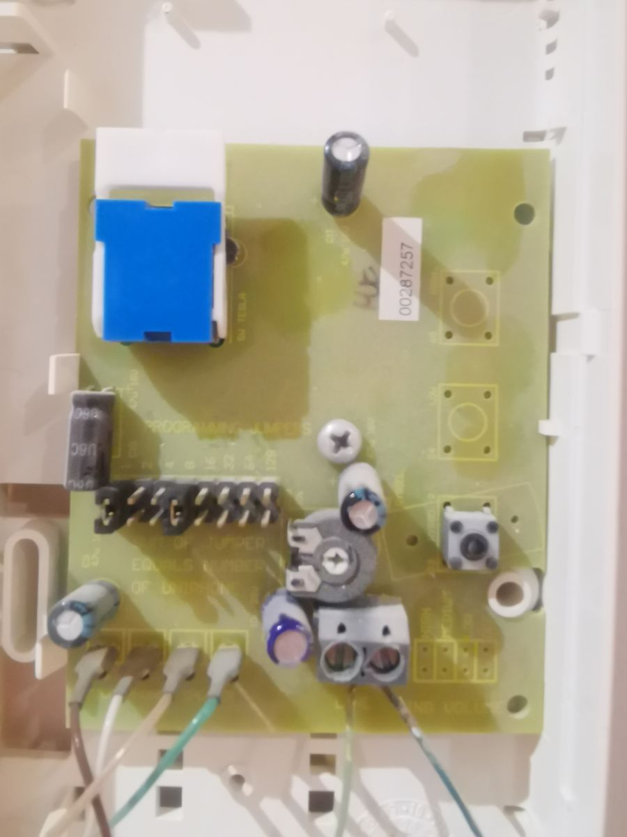

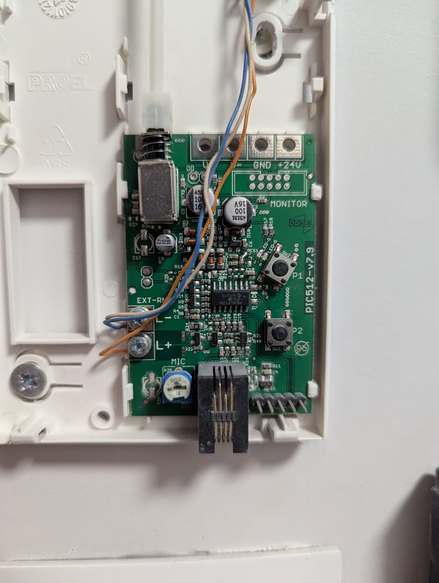

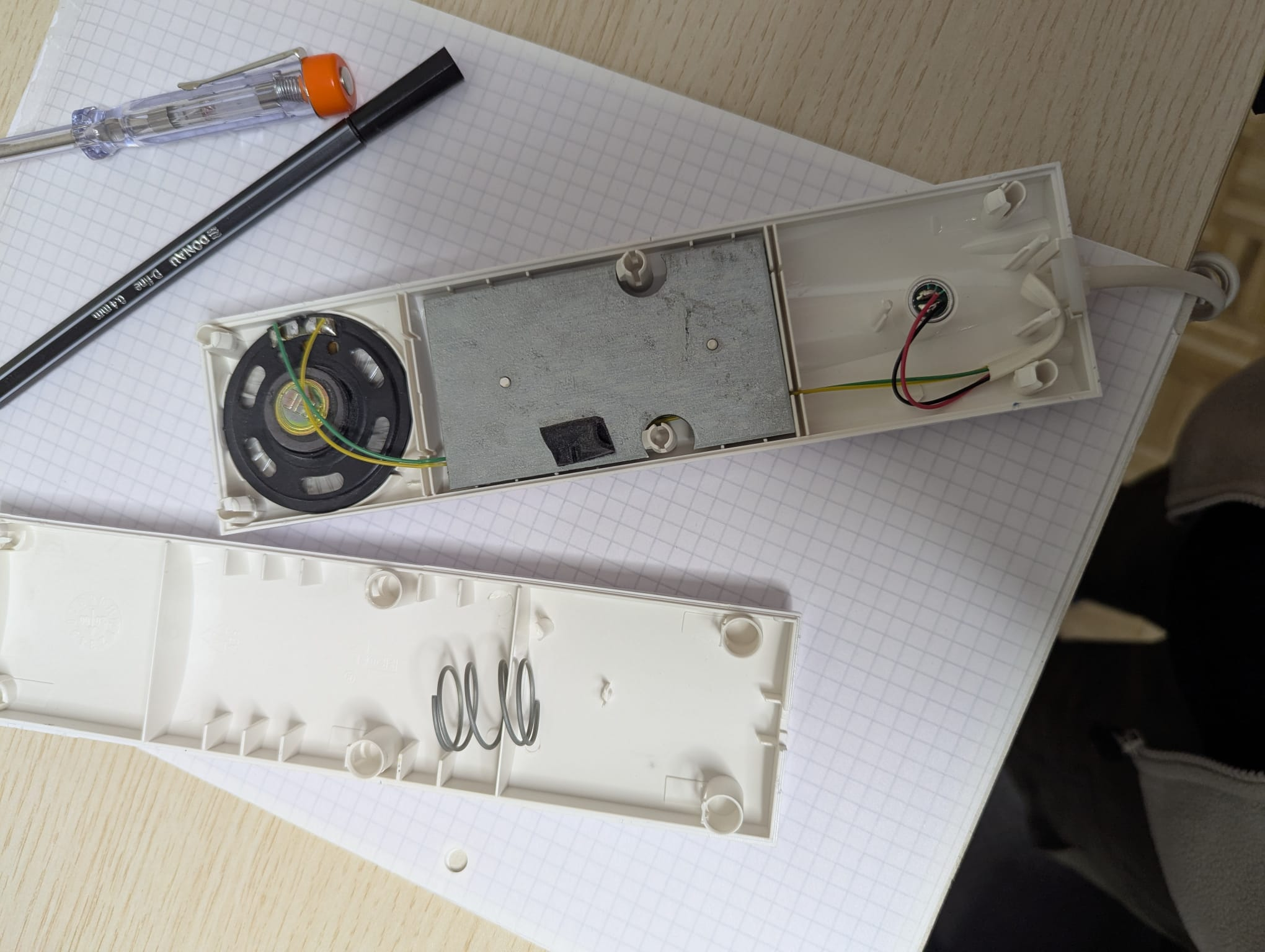

  • #18 21762820
    dast04
    My question is similar - how do you mute the beeping sound when someone opens the door to the building.
    I see that there is a MIC control - I'm guessing this is the microphone volume control.
    Even if there is no such adjustment on this model, where is the sound coming from? Worst case scenario, I'll put a piece of sponge in to dampen the sound.
    Plastic device casing opened to reveal speaker and internal electronics
    Disassembled intercom housing showing PCB and connected wires
    Intercom circuit board with visible connectors, microphone, and MIC potentiometer
  • #19 21762865
    Ircys
    Posts: 6959
    Help: 1340
    Rate: 2078
    The confirmation of code usage can be deactivated programmatically on this uniphone.
    Extract from the instructions:
    2.5 Disabling lock code confirmation
    To disable the confirmation of the lock code, press and hold down the P1 and P2 buttons (for approx
    4 seconds) until a single beep is heard. At this point, release
    p1 and P2 buttons and press P1 briefly. Pressing P1 must occur no later than 1 second
    after releasing the P1 and P2 buttons.
    The deactivation of the lock code confirmation will be signalled by a double beep.
    https://proel.pl/main_libs/files/assets/1/Ins...slugi/Instrukcja%20obslugi%20PC512%20v302.pdf
  • #20 21762968
    CYRUS2
    Posts: 17818
    Help: 1230
    Rate: 3487
    dast04 wrote:
    Even if there is no such adjustment on this model, where is the sound coming from? In the worst case I will put in a piece of sponge to dampen the sound.
    In this telephone the volume of the ringer is set by the user.
    It is possible to lower the ringer volume robustly.
