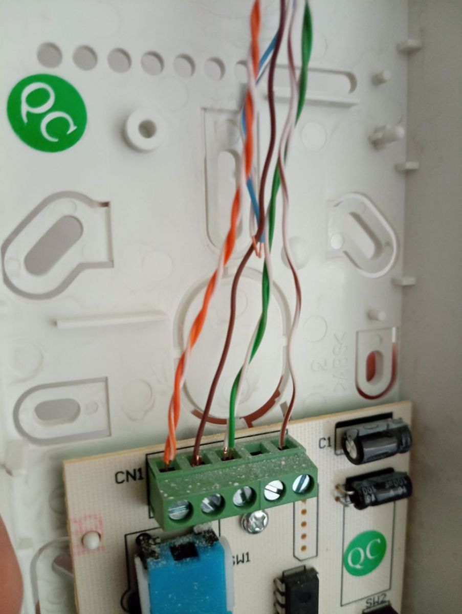

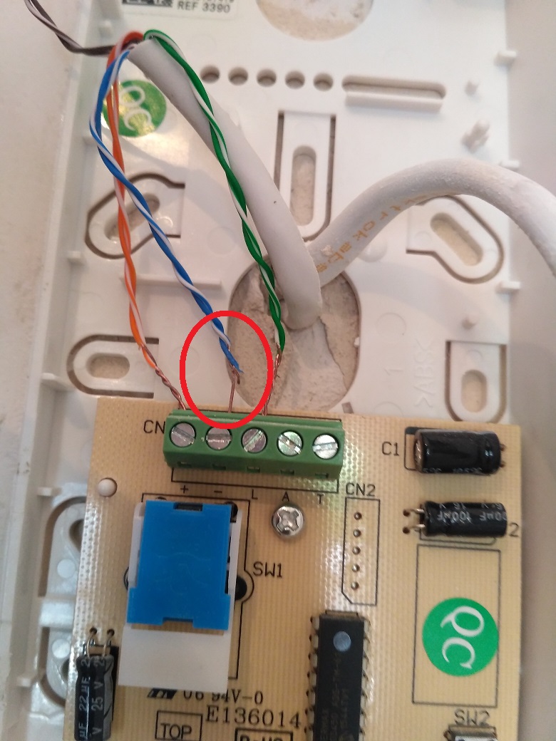

    I have a problem with the intercom, i.e. I can hardly hear or do not hear the person at the entrance door (she hears me very clearly) and the intercom does not open the door (after pressing the door opening button, you can hear the message "door open please close it behind you" and the sound of the electromagnet in the door, but the door does not unlock). Below I am sending a photo of the intercom after opening it and here I would like to ask if there is a need for a connection between the "-" wire and the T terminal as shown in the attached diagram?

    bk1991
    Posts: 21
    I improved this cable but it has not improved

    bk1991 wrote:
    I have a problem with the intercom, i.e. I can hardly hear or can't hear the person at the front door (she can hear me very clearly)
    Report this problem to your administration / manager / cooperative.
    The regulation is in the entry panel, to which regular user has no access. This is what the service does.
    bk1991 wrote:
    intercom does not open the door (after pressing the door opening button, you hear the message "door open please close it behind you" and the sound of the electromagnet in the door, but the door does not unlock).
    As above - fault in the common part - maintenance service
    No - it's called local bell, i.e. shorting the T and contact - will give a bell in the uniphone
    (slightly different than when calling from a cassette).
    greetings

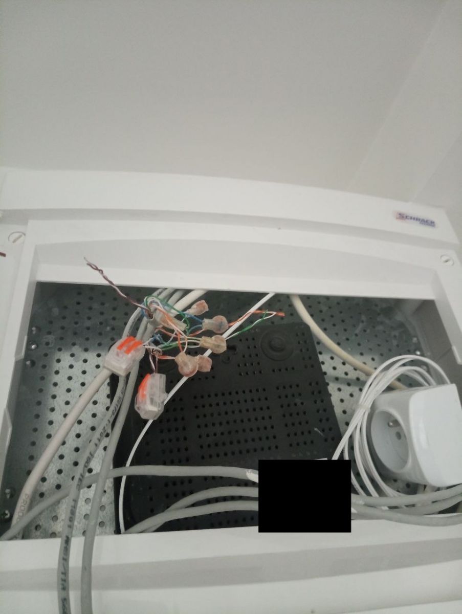

    In the box at the entrance to the flat it looks like this:
    Electrical box with cables and connectors. .
    I know you can't see much, but to my mind this is as it should be, according to the diagram:
    Connection diagram of Fermex ADS intercom ref. no. 3390 and 3391 with terminal markings. .
    I'm wondering if I should take these etons/connectors apart and check the voltages there, or just let it go for my part, as the subject goes beyond the flat area?
    Any suggestions on what to do? What to diagnose? How to diagnose? Need to add something as part of the information?

  • #8 21144472
    Ircys
    Intercoms specialist
    Posts: 6971
    Help: 1342
    Rate: 2085
    Measure the voltage between + and - should be 18V (DC).
    If it's not there, you don't do anything about it yourself but report it to the administration/manager.
