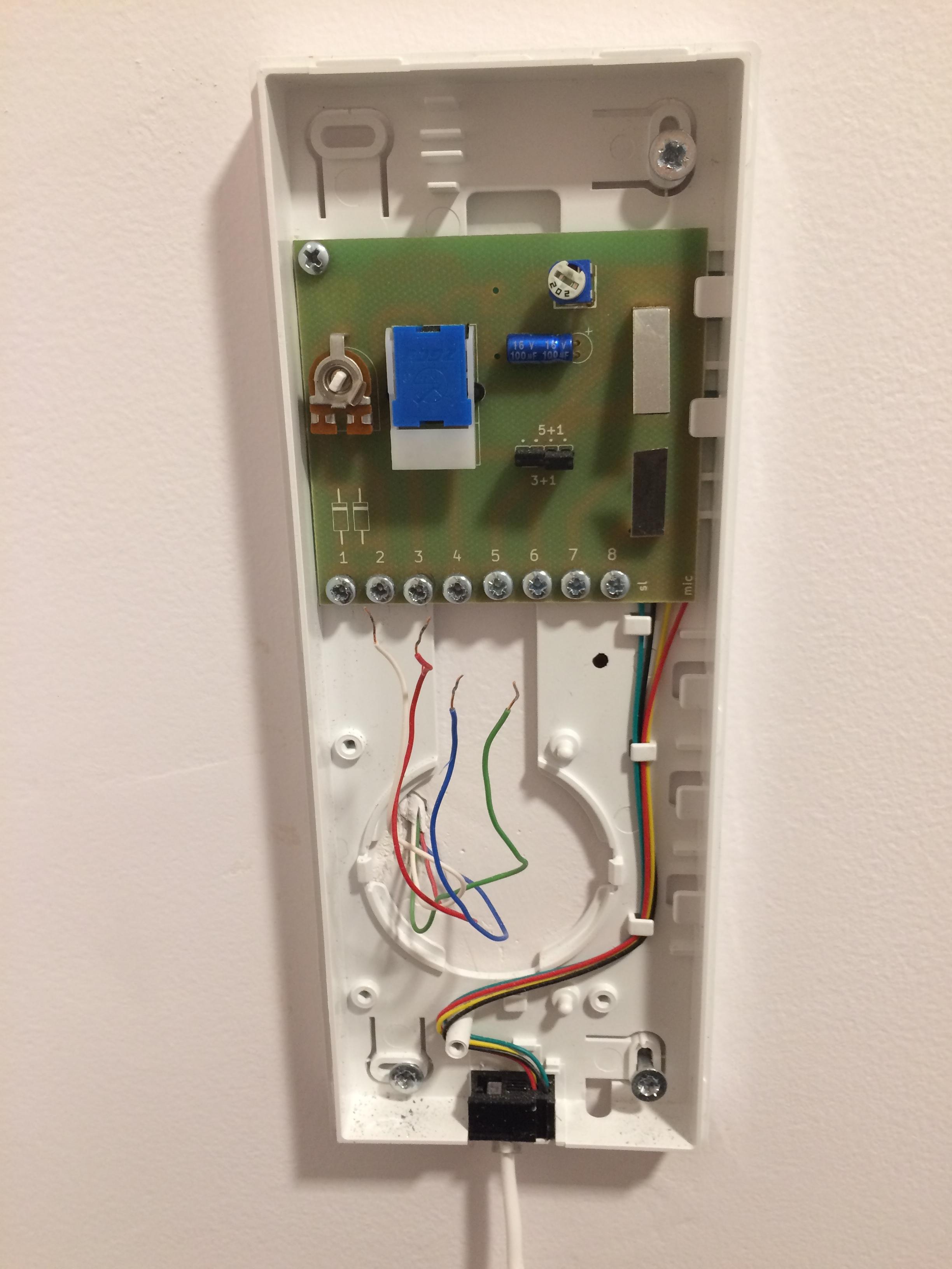

    tomekwsrod wrote:
    Opening the door is always on, constantly.
    Take off the colleague of these jumpers, because the electric strike can not withstand this repair :)
    At the neighbor's side you can see additional equipment in the form of a capacitor and a resistor. At my friend's in the old uniphone they were probably also. Has a colleague?
    More about this in the subject:
    https://www.elektroda.pl/rtvforum/topic1706038.html
    greetings

    tomekwsrod wrote:
    Everything that was from the previous uniphone was discarded during the renovation of the apartment.
    Very prudently.
