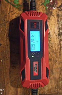

    I bought a battery charger in Lidl. Price 49.90.
    It kind of charges, but it's kind of weird. I have no gassing, it turns off at 14.5 V. Somehow "I don't feel it". The previous one, from Biedronka, recorded beautifully, there was electrolyte gassing, and this one was so strange. It does not show the charging current, I will not measure it with a meter. Some strange charging current that the Meter cannot see. The meter is operational, I checked it. Does anyone have such a device and thoughts after using it? I was tempted, because the total cost of making a straightener would be similar or higher, the dimensions would be larger and I would waste my time.

    A very good auto charger, if there is no gassing, this is how it should be. You have 4 charging levels. I use it and it's great.

    In general, it annoys me that I cannot see the charging current ..

    The charging current is shown at the start of the process right after start-up and is constant as programmed. However, after reaching the maximum voltage (14.8 V), the process is interrupted and restarted when it drops to 12.7 V, probably. During this pause, the battery is not charged and the display shows only the current cell voltage. Such a scheme precisely prevents unnecessary boiling of the electrolyte.

    The charging current of this charger is not constant, at the beginning with a deeply discharged battery, the current is 4.2A-4.5A, but it flies quite quickly to about 3A, and at the end at about 14.5V on the battery, only dismal electrons are left, not the charging current .
    The charger itself is not bad, but it will not charge large batteries in a reasonable time, due to the low charging current and average voltage.

    According to one of the videos showing the charging test of this charger, it charged a fairly discharged battery with a capacity of 100 A for almost two weeks before it reached the proper electrolyte density. I have this charger myself and can recharge a dead battery that has discharged and had no strength to turn the starter, half an hour is enough and the battery regained partial efficiency to start the engine and drive away. Most of the batteries should be charged around the clock to be able to say that they are 100% charged.
