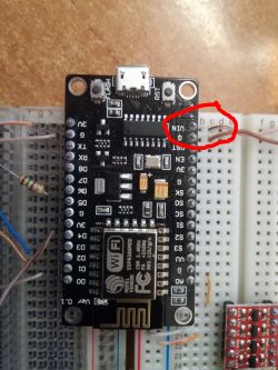

    I have a nodeMCU board as in the picture below. The board is powered from the power supply (+5V) through the Vin and GND connectors (marked in the picture).
    My question: if I want to upload the program to this board, I connect directly to the computer with a micro usb cable and upload the program or do I have to somehow output it from the pins and then to the computer?
    Someone help? I don't want to break the plate.

    It's safer to disconnect Vin power while uploading, and how often you modify the program, use uploading via WIFI - OTA, add a few lines in the code, install a few programs on your computer to detect ESP in the network as an upload port and there is no need to even bring the board around PC. At least that's what you can do with Arduino.

    I would prefer to do it traditionally via cable.
    Unplugging the power supply for the time of uploading will cause the 5V module to stop working.
    Can't upload via UART? By connecting RX, TX with UART1 on the board?
    Then I would have taken care of the 5V power supply and uploading the program.
    UART1 cannot be used for program upload

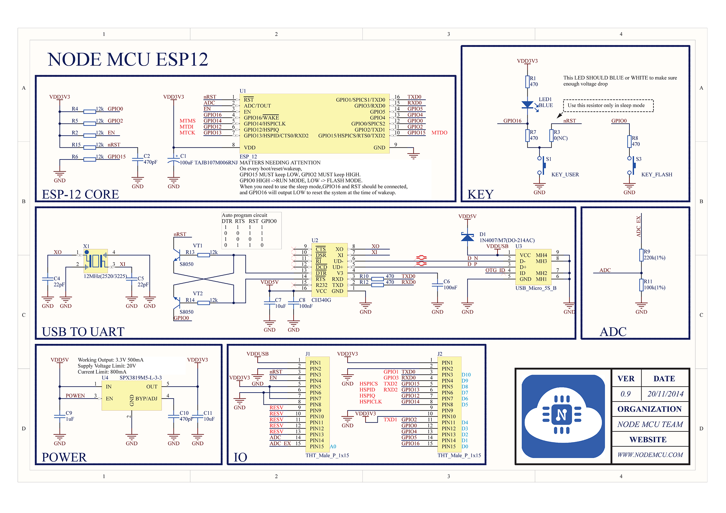

  • VIN and USB 5V appear directly tied on J1

    khoam wrote:
    According to the diagram (below) VDD5V is "separated" from VDDUSB by a 1N4007 diode, so as long as the VDDUSB voltage (from the USB port) is not more than 0.5V higher than the one indicated on the VIN, then nothing bad should happen. So much in theory
    On the first pin of the J1 connector (i.e. VIN) VDDUSB is given so there is no separation! As for me, a terrible lime and I wonder what the friend wanted to achieve. Maybe it was the 5V output from USB to an external chip, and the pin description is a hoax? Or maybe the scheme is wrong or is for a different NodeMcu? For example, the penultimate pin on this connector is described in the diagram as ADC and the print on the board reads "G":-/
