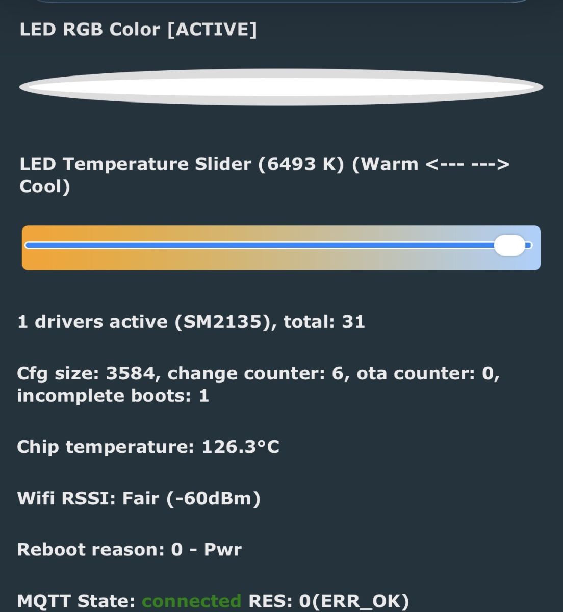

    Openbeken rgb bulbs - extreme temperatures are happening on a couple my bulbs which are small bk7231T chips. Is there a way to get these temps down? I have renewed the thermal glue between the aluminium baseplate but it’s not helped

    You would need to use a larger heatsink, as the current one is probably too small and this is where new paste will not help.
    Added after 34 [seconds]:
    Can you show what it looks like as maybe something can be added.

    Im not no - I thought powersave was just to save power when in an "off" state?
    I would rather not dismantle the bulbs again and break the glue however I will say the "heatsink" is a very cheap piece of aluminium possible 1mm thick. They are not the most robustly built bulbs. They are small too being "candle" e14 style, I dont suffer the problem as much with larger e14 type
    Added after 1 [hours] 34 [minutes]:
    Ive tried the various power and current options, no real change. I think I will retire these bulbs and switch it out to an LED strip (they are in a funky style of lamp which could accommodate a strip without being visible from exterior)

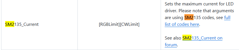

    You need to lower the SM2135 current. This is the solution. Tuya might even used lower current setting, we don't import it, yet. Maybe we should lower the default one.
    I had similar issue on LN882H. Reducing LED driver current through console command in autoexec.bat is the solution.
    I will say even more - you should make it lower than it was in Tuya, this way, your bulb will have much longer lifespan. Those chinese bulbs are always working at their limit and they are more or less designed to fail early, so you can buy next one soon.

    What setting would you recommend? I have
    SM2135_Current 0x00 0x00 in startup

    I don't remember it from memory, but here's how it looks like in our codebase.
    #define SM2135_10MA         0x00
    #define SM2135_15MA         0x01
    #define SM2135_20MA         0x02  // RGB max current (Chip default)
    #define SM2135_25MA         0x03
    #define SM2135_30MA         0x04  // CW max current (Chip default)
    #define SM2135_35MA         0x05
    #define SM2135_40MA         0x06
    #define SM2135_45MA         0x07  // Max value for RGB
    #define SM2135_50MA         0x08
    #define SM2135_55MA         0x09
    #define SM2135_60MA         0x0A
    Defaults:
    static int g_current_setting_cw = SM2135_20MA;
    static int g_current_setting_rgb = SM2135_20MA;
    The only question is do you start SM driver first? If not, it may not get applied.

    Driver is 100% started. I figured to run at the lowest 10ma setting but still temps are 90-100 degrees
