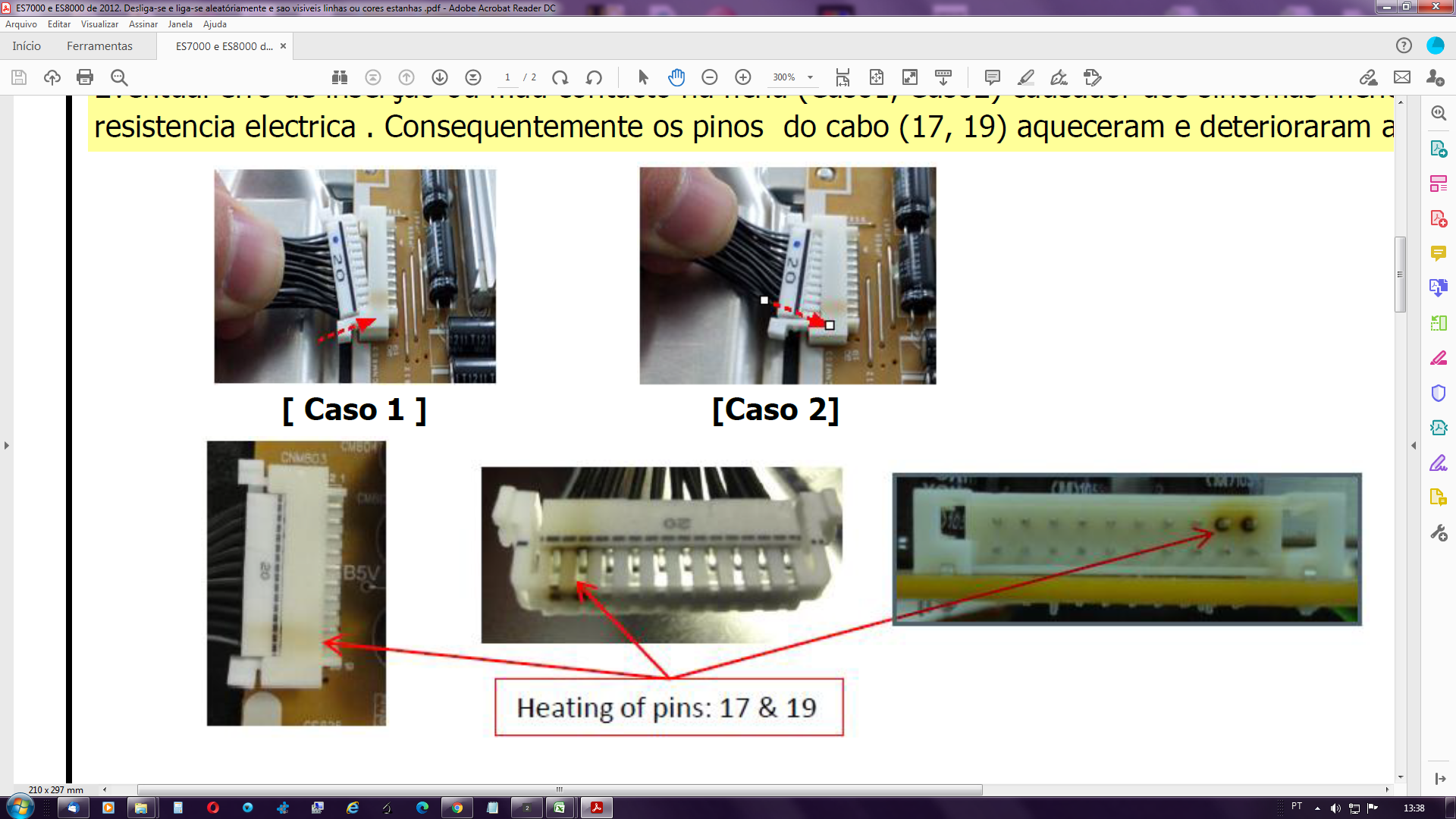

    Check the plug on the power board that connects to the mainboard if it is burnt out

    Check the image.
