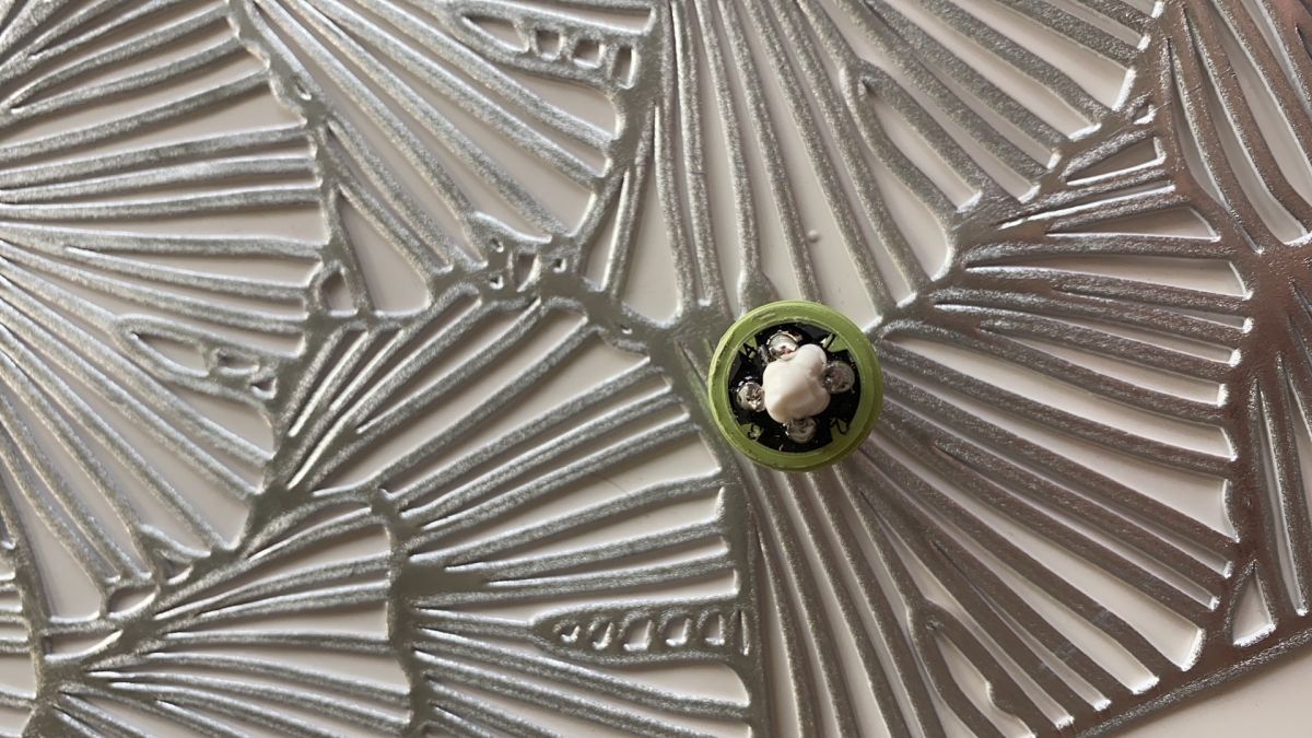

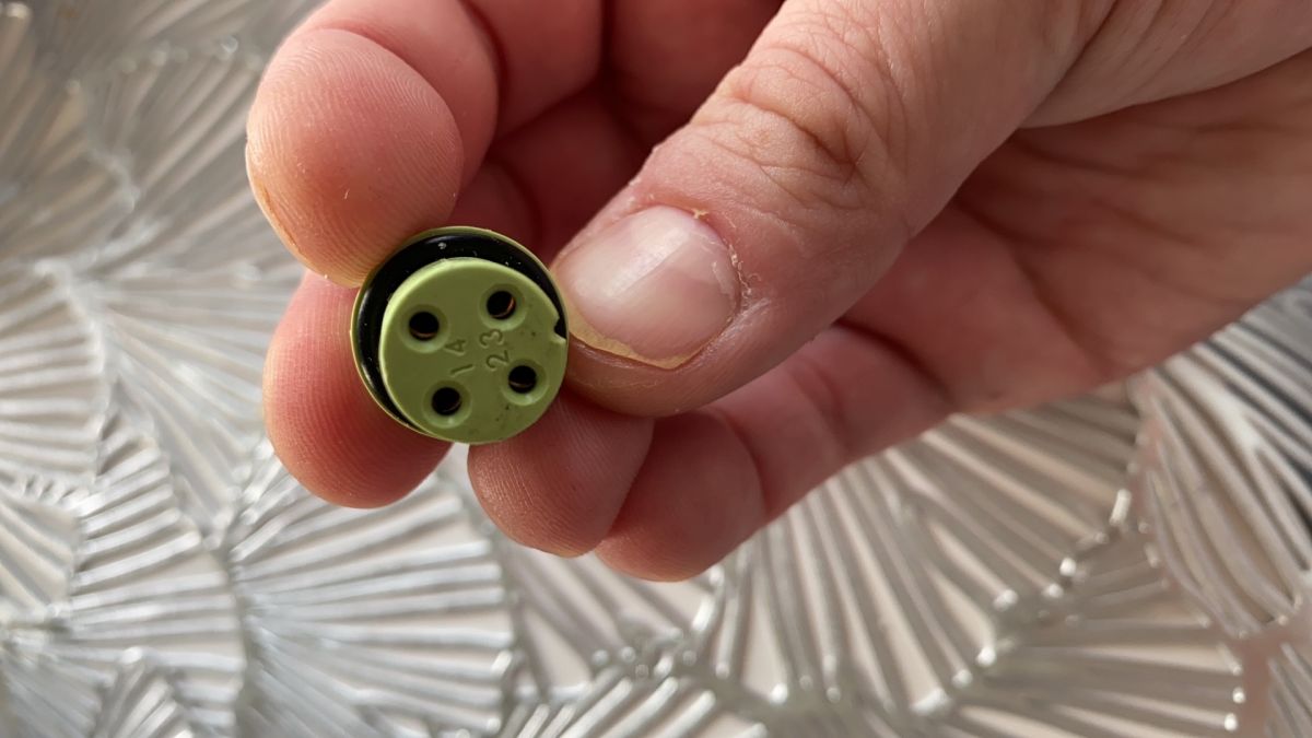

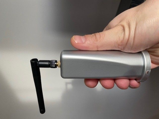

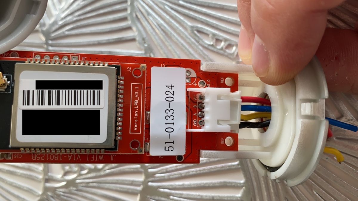

    The cable was broken during the installation of the Wi-Fi module to the Solis inverter, which resulted in connectivity problems some time after commissioning. I disassembled the module and it turned out that the cables are broken. Unfortunately, the last ones broke during disassembly. Do any of you have a diagram of connecting the module board to the socket and COM port? Does anyone know in what order these cables should be soldered to the plug with the markings (1,2,3,4). The following cables come out of the module:
    - VCC (red color)
    - B (blue)
    - A (yellow)
    - GND (black color)
    Attached are photos of my Wi-Fi module and socket ... Any help is appreciated. I would like to solder rather than buy a new one.
    Regards and thank you for your help !!!!

    jdubowski
    Tube devices specialist
    It looks like a USB standard, you can determine VCC and GND with a voltmeter. The other two by trial and error.

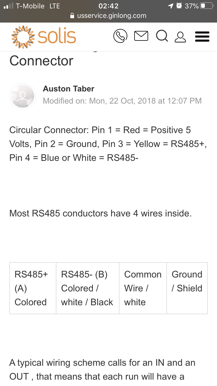

  • #6 19060765
    tralalala81
    pikulski wrote:
    Description in the attachment
    Many thanks !!!!!!! '
  • #7 19608802
    piowi
    Hi. How can you write back to me when you connect these broken cables, i.e. what color to which pin number
  • #8 19608816
    rokbok
    After all, you have been given above, post # 5.
  • #9 19894956
    serviscentrnadvira
    1-red
    2- black
    3- yelow
    4 - blue
