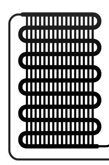

    The item in the picture is an evaporator - you can't remove the ice from it mechanically. Better defrost.
    Can you turn off the freezer independently of the fridge?
