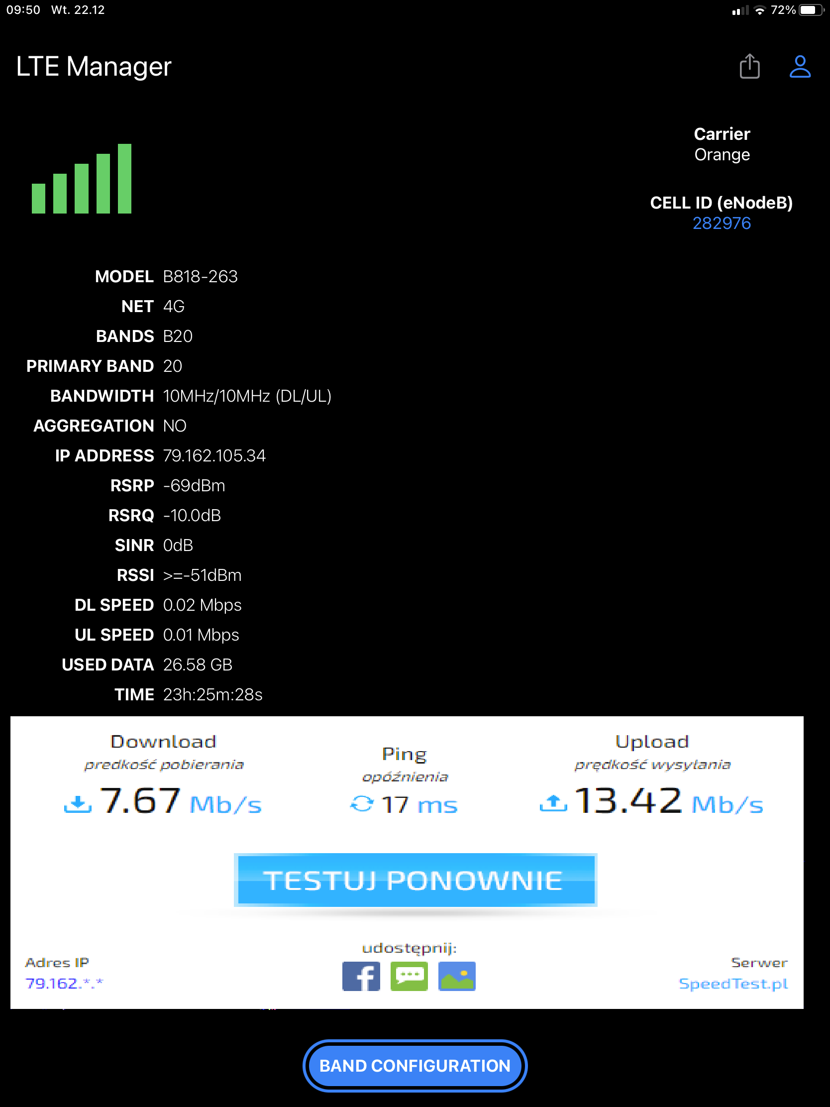

    Good morning ,
    I have a Huawei b818 router and I would like to know what specific bands it aggregates. On the manufacturer's website and on the Internet, I managed to find that it aggregates 4, but I do not know which ones. The router connects to the BTS on which I have the LTE 800, 1800, 2100 and 2600 bands.

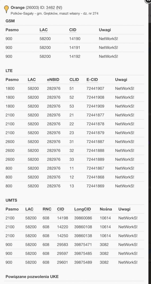

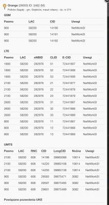

    I have one more question about the external antenna. I currently have an antenna https://all-ant.pl/antena-do-LTE-4g-3g-l4g-mimo-2x15dbi-konfigurator-mapa-zasiegu
    Would like to change to one of these
    https://telkob.pl/pl/p/Antena-ATP-15-MIMO-Pasmo-790-2690-MHz./67
    https://www.wisp.pl/p7574,qupanel-lte-mimo-4x4.html
    Does the exchange make sense? The current antenna and the one I am going to buy are directed towards btsa, the station is visible in a straight line about 3km. I have the best current results by disabling four-band aggregation and using an external antenna signal on 2600

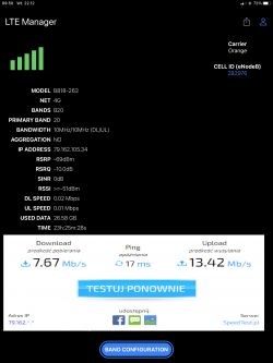

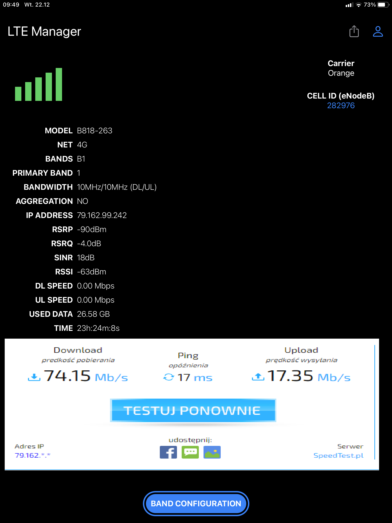

    The antenna is selected after testing individual LTE bands with B818 outdoors and shows screenshots from the Android / Windows application for band management and signal diagnostics on HiLink Huawei, and every evening speedtest. You have a broadband antenna, so for comparison, the tests of these bands with it set to this BTS.

    grzegorzstr2020
    Posts: 36
    Huawei B818 Router: Band Aggregation Details for LTE 800, 1800, 2100 & 2600 Bands Huawei B818 Router: Band Aggregation Details for LTE 800, 1800, 2100 & 2600 Bands Huawei B818 Router: Band Aggregation Details for LTE 800, 1800, 2100 & 2600 Bands Huawei B818 Router: Band Aggregation Details for LTE 800, 1800, 2100 & 2600 Bands
    Tests at different times come out practically the same, it is a signal only from external antennas, sometimes there are better results if I set one external and one internal antenna for the signal (both option) and additionally aggregation, but this is sporadic and the results are up to 70 mb, if you want to exceed this value is only one outer band

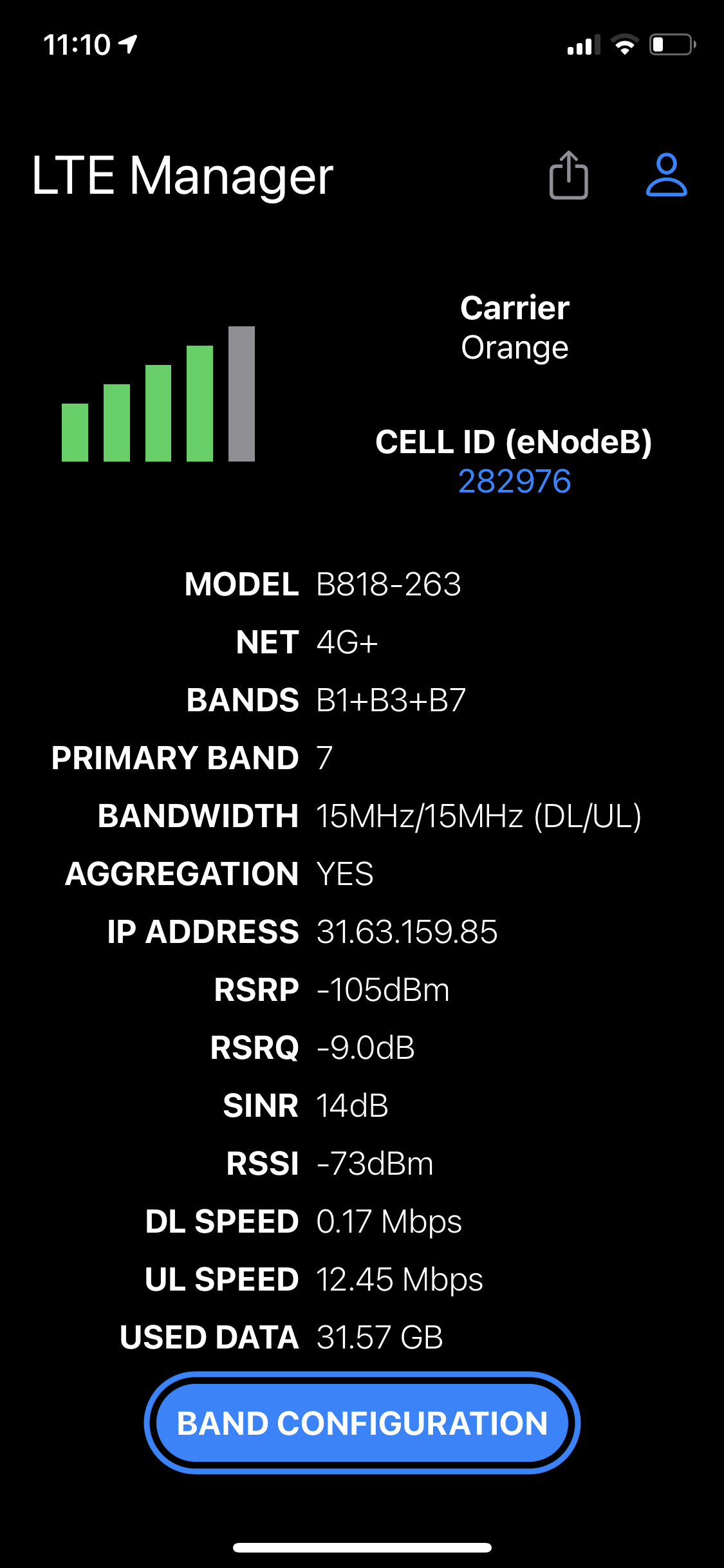

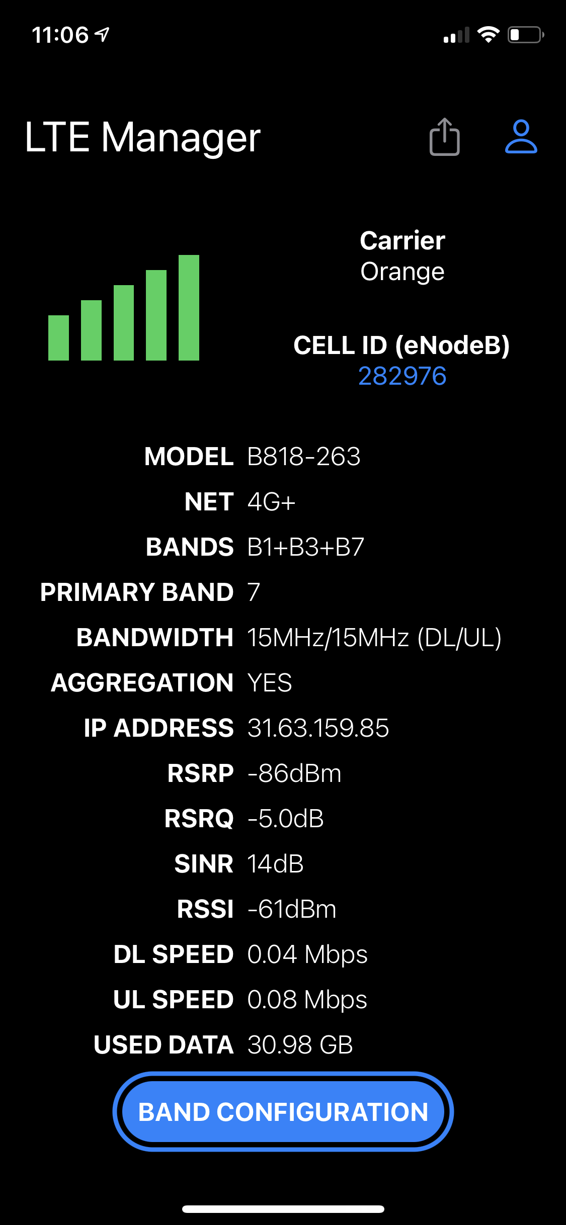

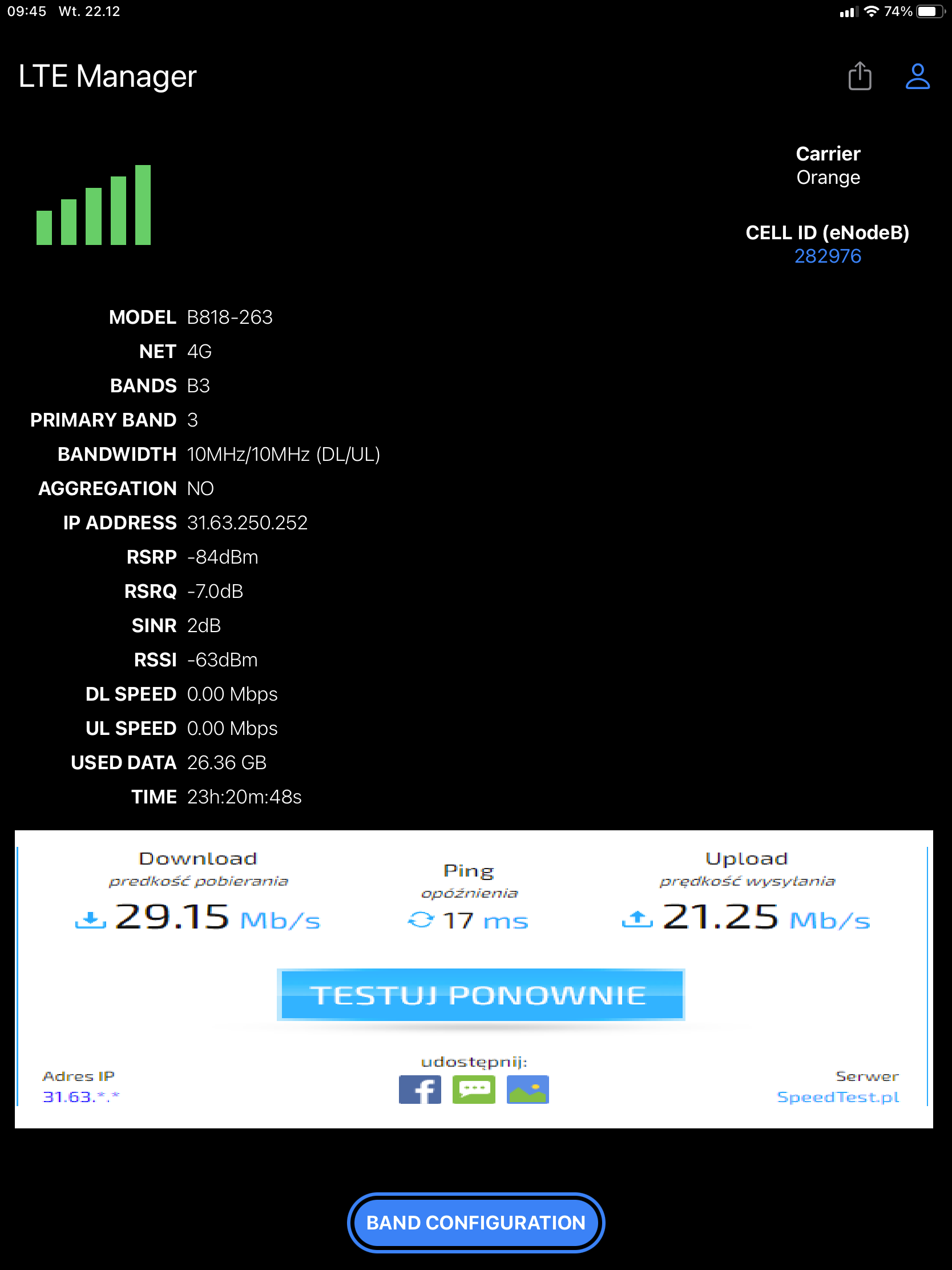

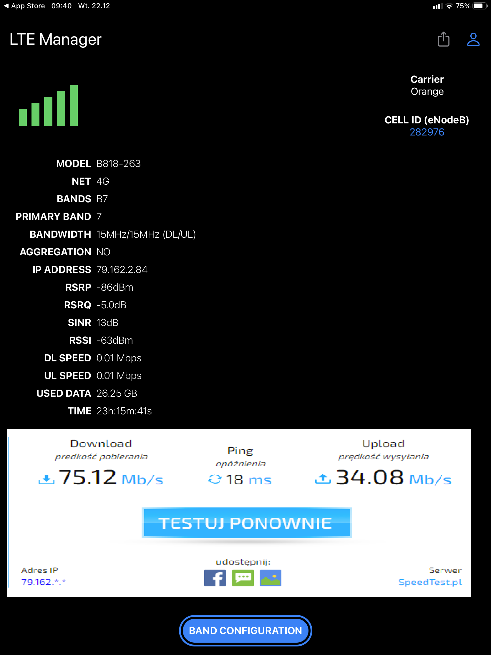

    The signal parameters on all bands are correct, LTE2100 is practically unloaded, so check LTE2600 + 2100 aggregation and then LTE2600 + 2100 + 1800 and see if it turns on, what is the program from the screen, it has the ability to force bands on b818?
  • Questioning whether band aggregation uses only internal antennas
    #13 19130315
    grzegorzstr2020
    Posts: 36
    This is the LTE manager program from the App Store because I have an iPhone, although I checked the correctness of the reading with Android and it is correct. The app has the ability to force four bands and it works well. One photo shows aggregations from an external antenna, only the internal one is expensive, the weaker signal, but despite the fact that the router shows aggregations, it probably only works on internal antennas?
