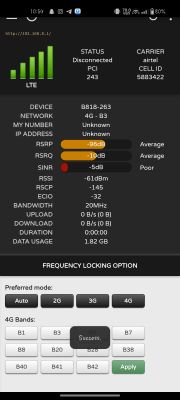

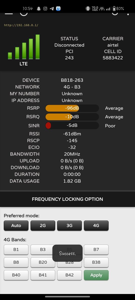

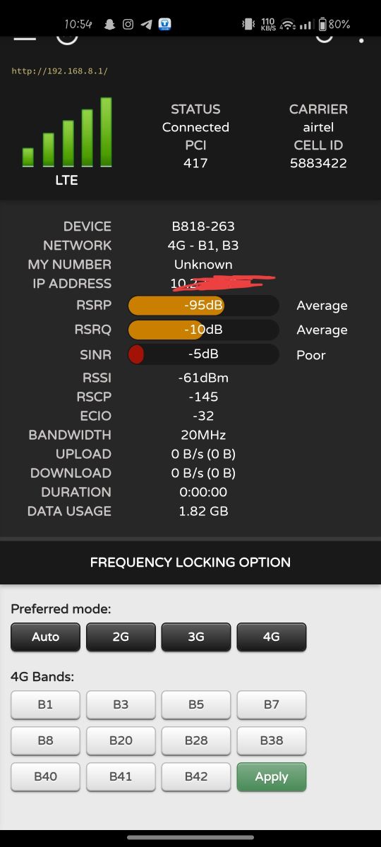

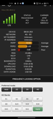

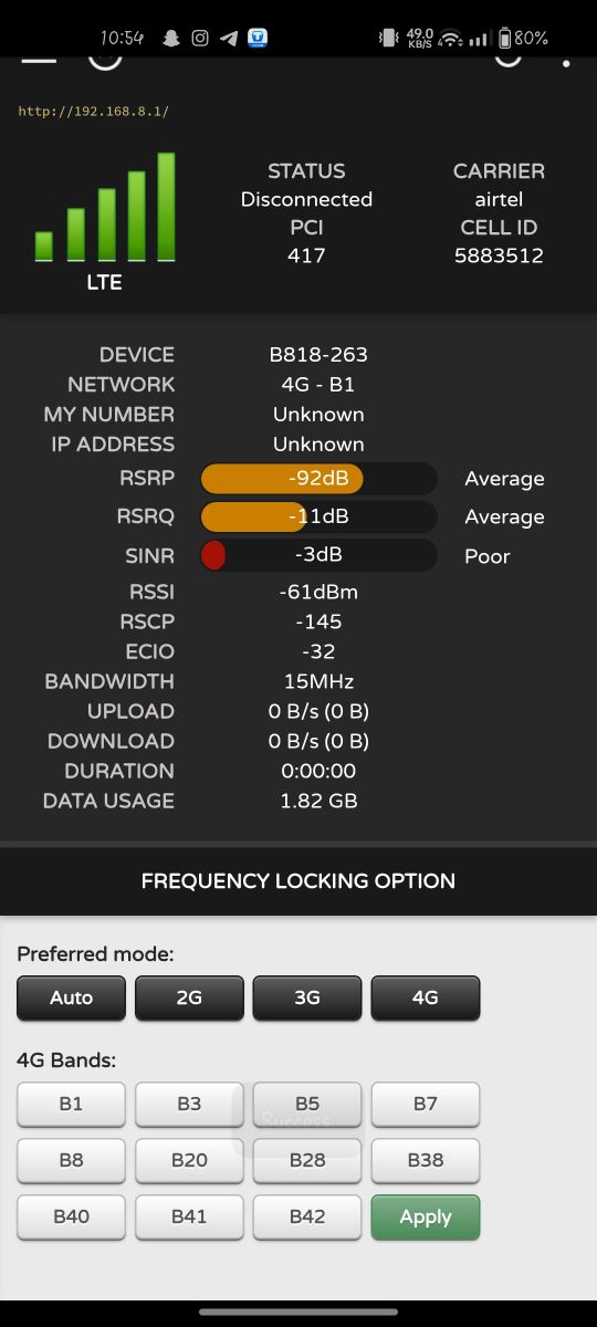

    Screenshot of an LTE router management panel showing connection status and network parameters. Huawei B818-263 Carrier not aggregating. I have good signal for B1 and B3 but both bands not aggregating. Only one band working at a time. I have locked B1 B3, also same results there's no aggregation. Currently on Optus firmware.
