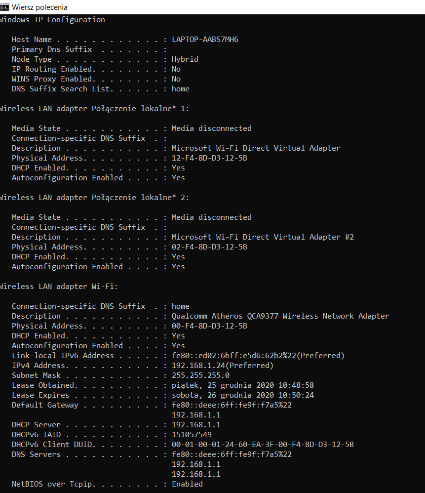

    Here is another screenshot from inSSIDer
    At the router:
    Comparing WiFi Speed on Mi 9T Phone and Computer with Archer T2U, T4U, Huawei B818 Router
    Behind a wall:
    "MI Phone" is the hotspot on my phone. I added for comparison. It seems to give faster transfers, but it's still up to 40mbps and it's hard for me to say whether it's a matter of time. I think I'll try to run some tests on two computers at once.
    Network Properties:
    Here is more information about the protocol:
    Network properties when connected via hotspot on the phone:
    In the meantime, I wrote to her. They have declared that they do not limit the bandwidth for computers.
    Thank you for your help. I hope Christmas has gone well.

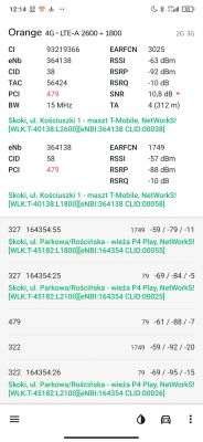

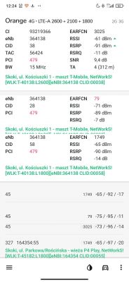

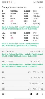

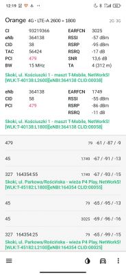

    #17 19149127
    matek451
    Posts: 31258
    Help: 4352
    Rate: 5808
    What you are doing so far is one big misunderstanding, starting with the choice of mobile operator, equipment, antennas that you simply have no idea about and B818 is the least to blame. I wrote volumes on mobile internet on this forum, just read and at the beginning give the location, on the phone with nju do outdoor tests and show the screen from the application https://play.google.com/store/apps/details?id=cz .mroczis.netmonster&hl=pl and speedtest. On this basis, after professional analysis, everything will be known about the Orange network and what further steps should be taken.
  • Field tests from two cell towers and apartment locations
    #18 19149142
    orilion
    Posts: 16
    Rate: 12
    Hey, well... More mercy. I sweated from the above tests, let alone "read volumes" ... But not about that, thanks mothers for joining, I'll do the tests!
    Added after 51 [minutes]:
    Attention, tests are entrusted to professional judgment. Carried by emotion, I drove around my town, so the data comes not only from under the block, but also from under the masts. Top Quality!
    Mast 1 (I can see it from the window), Kościuszki Street:
    Comparing WiFi Speed on Mi 9T Phone and Computer with Archer T2U, T4U, Huawei B818 Router Comparing WiFi Speed on Mi 9T Phone and Computer with Archer T2U, T4U, Huawei B818 Router Comparing WiFi Speed on Mi 9T Phone and Computer with Archer T2U, T4U, Huawei B818 Router
    Mast 2, Parkowa Street
    Under the block on the mast side 1
    Under the block on the mast side 2
    From the cabin:
    Thank you for your help and best regards!

    #19 19149426
    matek451
    Posts: 31258
    Help: 4352
    Rate: 5808
    The test near Kosciuszko is the 4th sector from this BTS in the LTE2600 + 210 + 1800 aggregation, speeds OK, although the ass does not break off. At Parkowa, the connection is still from Kościuszko, because the LTE2600 band has priority, and LTE2100+1800+800 works on BTS Parkowa, the LTE2600 signal from Kościuszko is weaker and in addition sector 1. Again under the Kościuszko block, sector 1 in the aggregation of bands with LTE2600 as the basic . The house is the same, i.e. LTE2600 + 2100 + 1800 from the first sector on Kościuszki and the signal is sufficient, show the speedtest. In general, the aggregation works, the signal parameters are OK, but the speed is not crazy. For such a base station, B818 is the best choice, it aggregates these 3 bands in QAM, it was necessary to test these 3 LTE bands on B818 one by one, using Huactrl or LTE H-monitor and do speedtests, possible external antenna Dual LTE 1800-2600MHz. Where did the idea to use Orange there come from?
