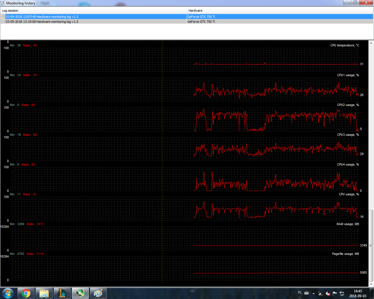

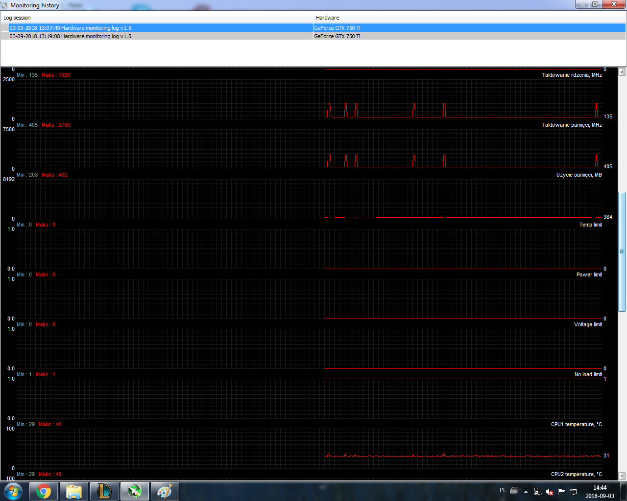

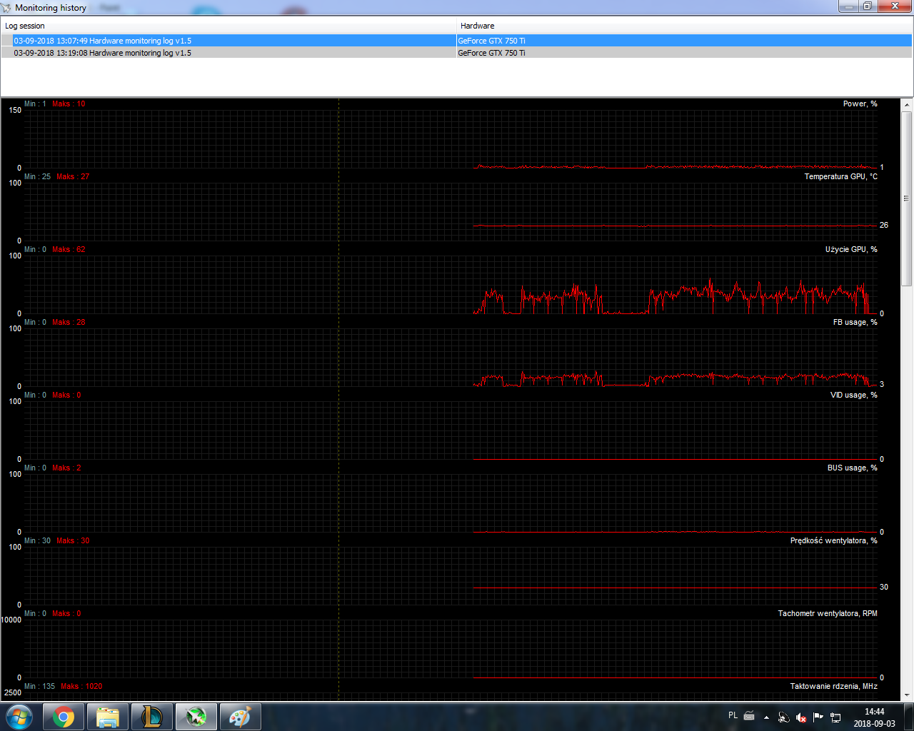

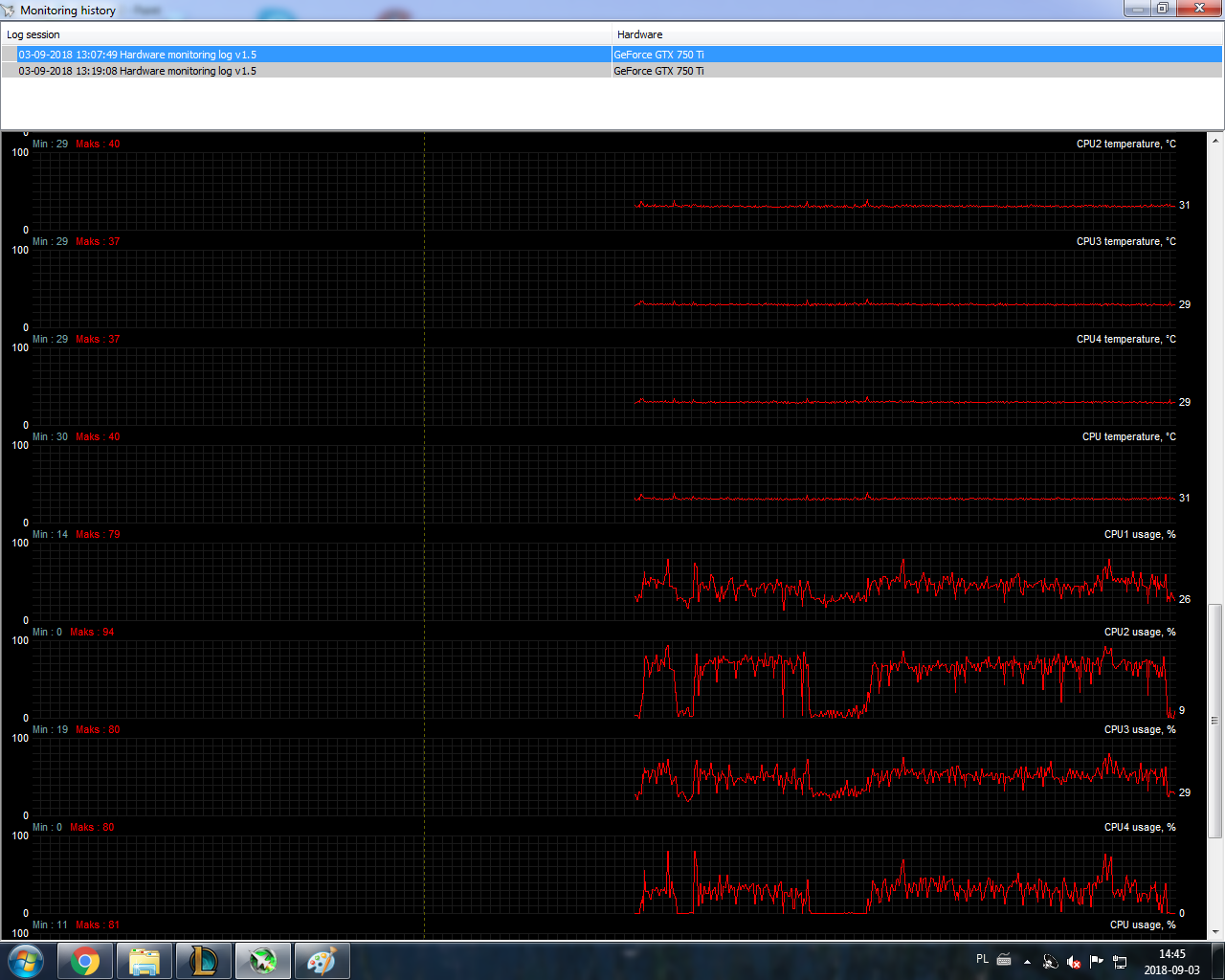

    Hello, let me introduce my PC hardware first:
    Motherboard: MSI H81M-P33 (MS-7817)
    Processor: i3-4160 3.6GHz
    Graphics: NVIDIA GForce gtx 750 ti, memory size 1024MB
    Power supply: CORSAIR VS450
    4GB RAM memory 1 chip
    Windows 7
    Well, after a few days of not using the computer (the computer was on for 2 days) something happened to fps.
    Playing League of Legends I have an average of 45 fps, where previously I was 75. I used to have a similar problem, but after resetting the BIOS everything is back to normal, but now it did not help. I scanned Malwarebytes (I cleared the bugs), HD tune showed everything ok in health. I also noticed a lot of hardware errors in the resource monitor.
    I have a HWinfo log and some afterburner screenshots.

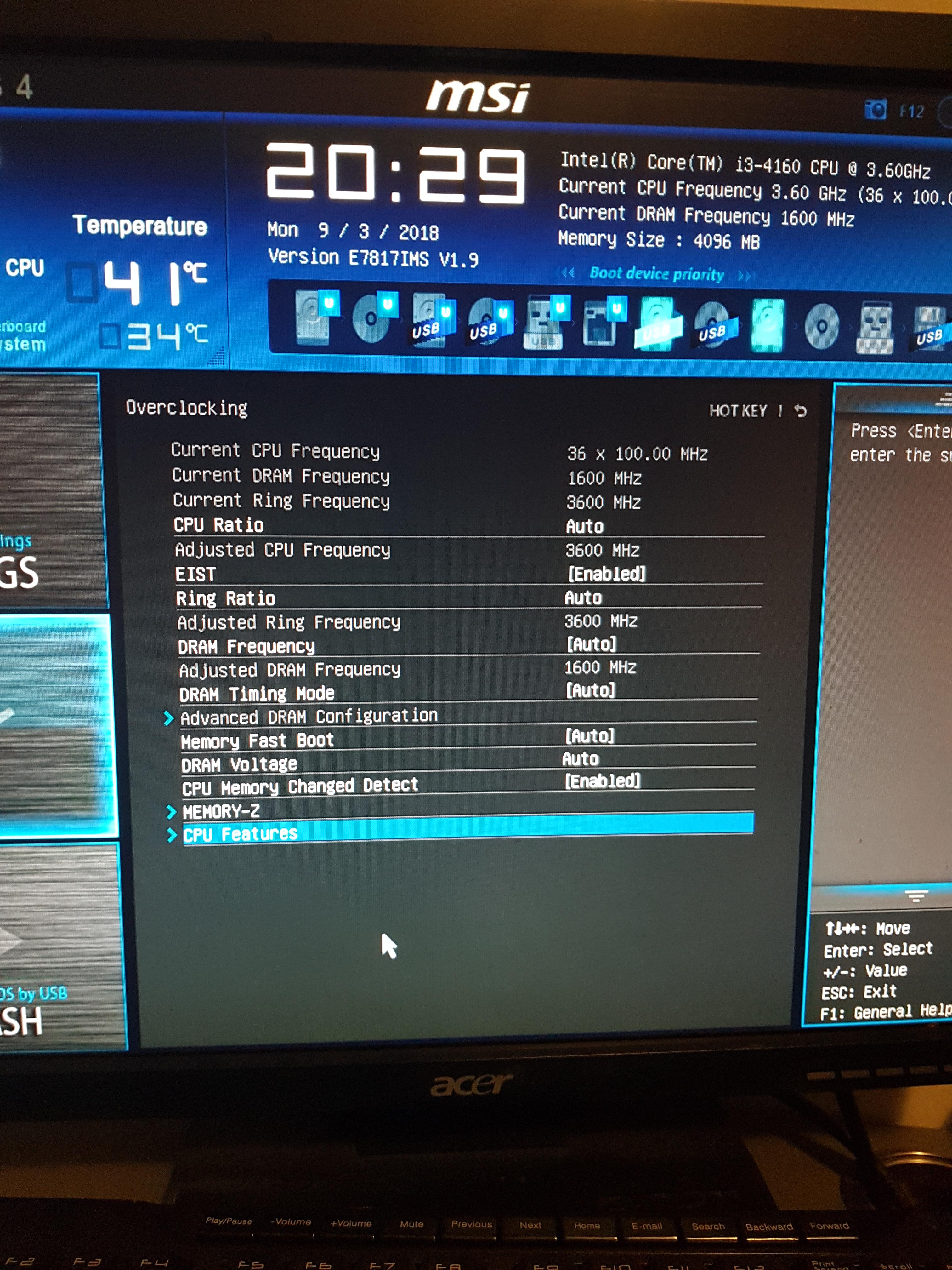

    The CPU drops to 800MHz under load and hence such a weak FPS. Why I do not know - you did not combine in the power profile? Reset bios and possibly insert photos from bios settings.

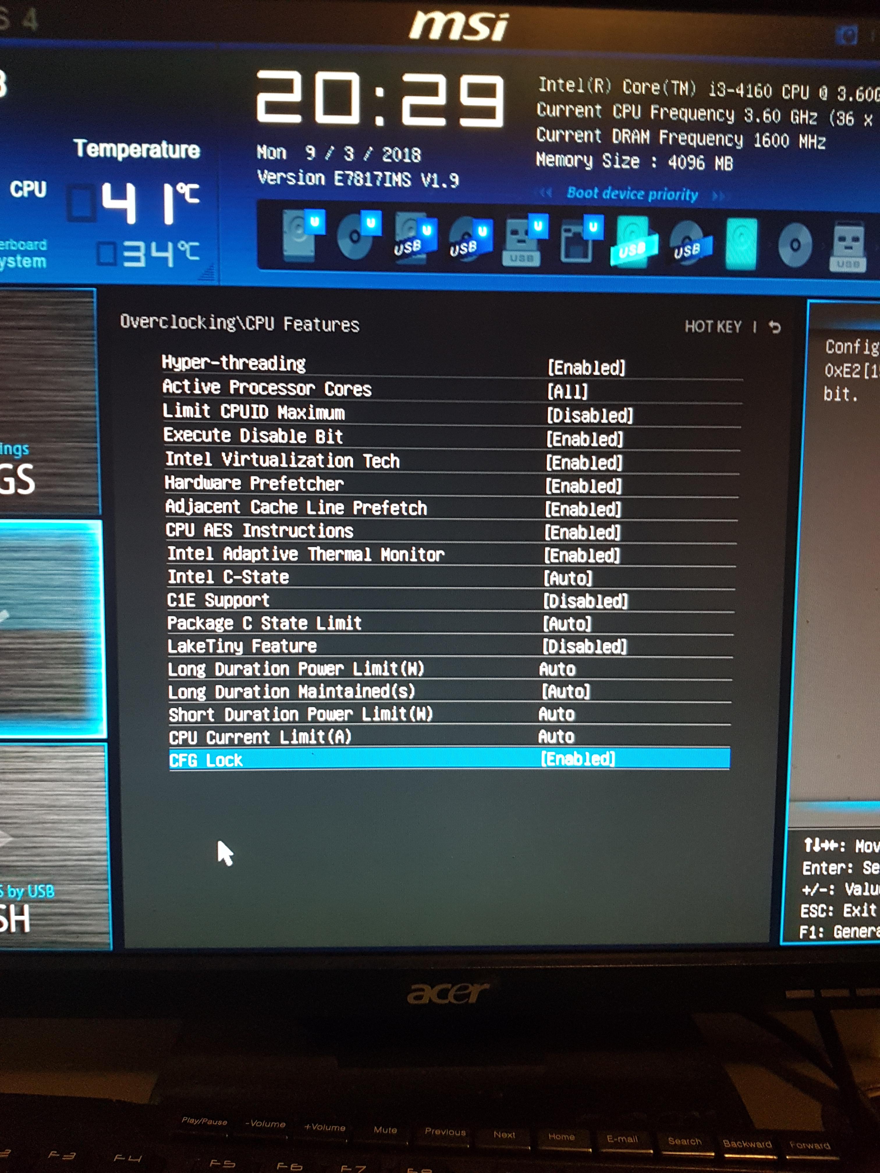

  • #3 17421075
    dawid2111
    Posts: 24
    As for the power profile, I did nothing. It happened overnight. I did a BIOS reset. But it didn't help.
    • Sudden FPS Drop in LoL: i3-4160, GTX 750 Ti, MSI H81M-P33, Corsair VS450, 4GB RAM, Win7 20180903_202924.jpg (1.45 MB) You must be logged in to download this attachment.
    • Sudden FPS Drop in LoL: i3-4160, GTX 750 Ti, MSI H81M-P33, Corsair VS450, 4GB RAM, Win7 20180903_202912.jpg (1.49 MB) You must be logged in to download this attachment.

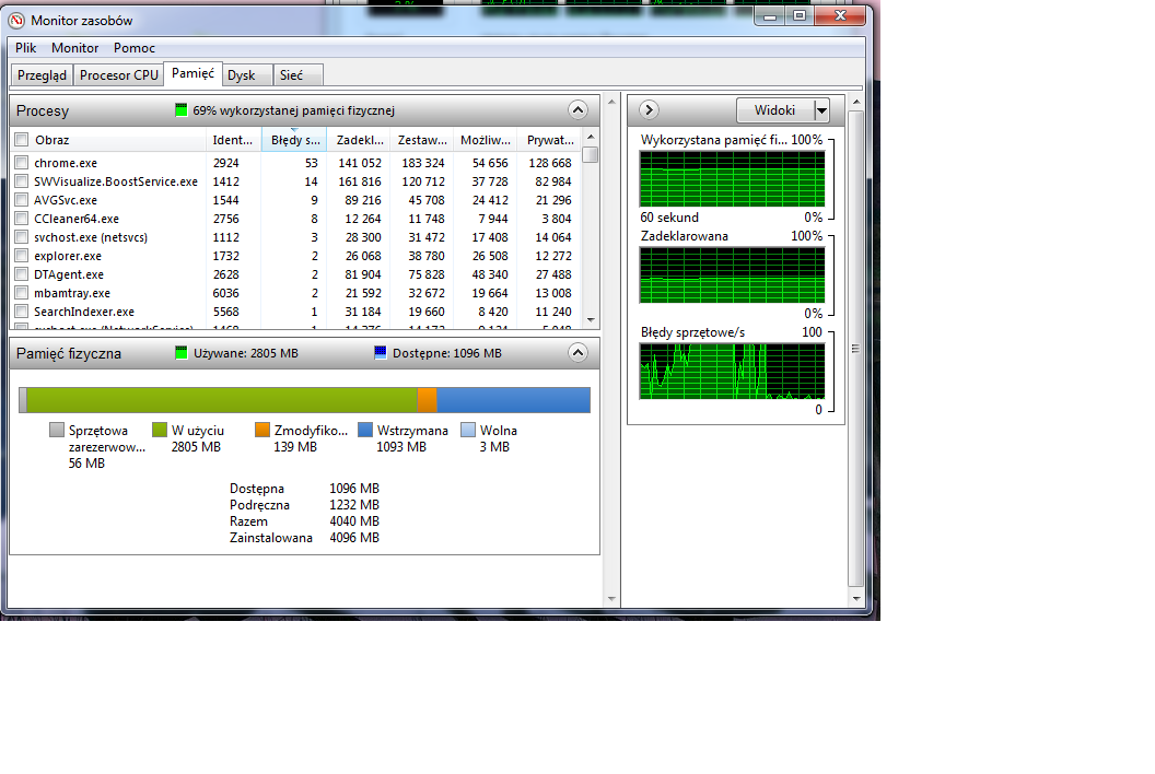

    Provide a screen with hardware errors.

    screen, I don't know if I did it right

    It's probably from using Swap on HDD.
    Fire up the throttlestop and set its multiplier to the max, save and turn on. Fire up the built-in TSBench and see if it will keep the timing or it will immediately drop to 800. All power cables will be properly connected to the motherboard?
