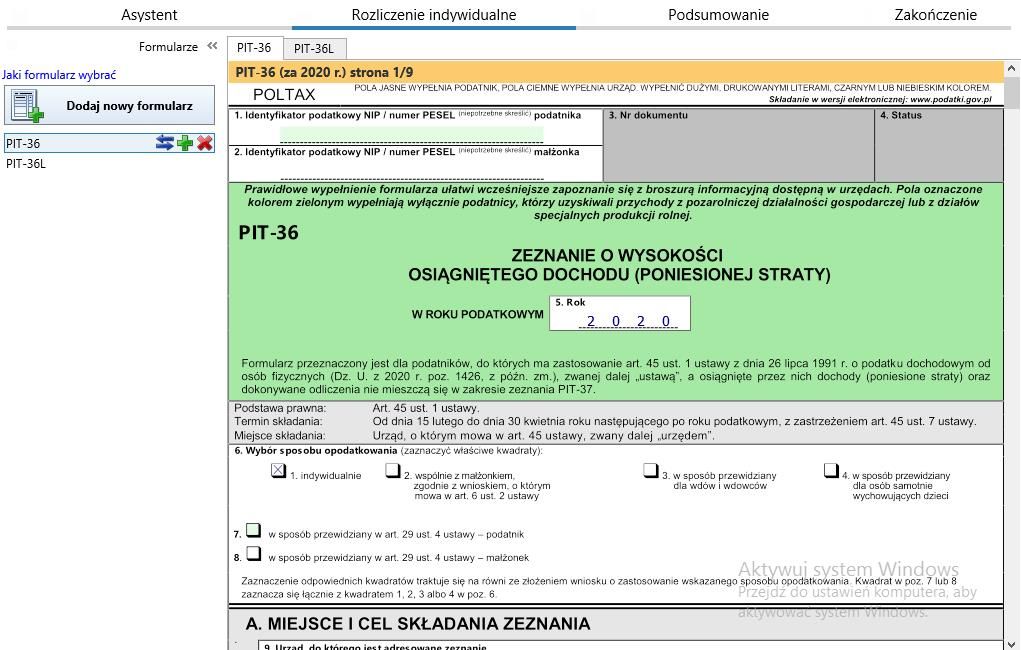

    64JANEK
    Thanks for the help with the e-declaration, I took advantage of it and managed to pass the problem with the "out of date certificate". Unfortunately, the PIT 36 form for 2020 is missing after the update. Has any of the forum members had a similar problem?
  • #33 19288153
    ta_tar
    Posts: 6491
    Help: 699
    Rate: 2052
    There is a lack, because the Ministry of Finance did not manage to prepare PIT36 and PIT 36L
  • #34 19288377
    64JANEK
    Thanks for the info. I was looking for an active PIT36 form on the website taxki.gov.pl but unfortunately it is not there either.
    Has any of the Forum members filled out PIT 36 for 2020 and knows any access path? Thank you in advance for your help.

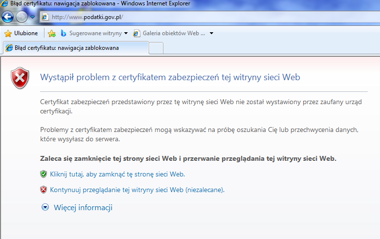

    tapa1
    Posts: 42
    Rate: 7
    I have a similar problem, there is no way I can run the e-declarations program.
    I had been using it on this computer for several years before.
    Yesterday I reinstalled WIN 7 64-bit and I am trying to install e-declarations.
    Default Firefox 78.8.0esr (64 bit)
    1.I downloaded the Adobe Air runtime
    2. There was a big problem to download Acrobat Reader, I finally downloaded it from the official website by hand. Version 21.001 has been installed.
    3. I have downloaded and installed Java applications in 64-bit version
    4. I have installed e-declarations 13.0.0 (message about the lack of certificate)
    5. When starting e-declarations, 3 messages about the lack of certificate and no connection to the Internet.
    E-declarations v13.0.0 Update: Certificate Problem (Mismatch or Invalid) - How to Fix?
    No internet connection all the time. Firefox opens the taxki.gov.pl website, and declarations are blocked.
    I discovered that the internet explorer is blocking the taxki.gov.pl website due to the lack of a certificate and I cannot unblock it in any way.
    Internet explorer, after clicking continue browsing this site, displays only some of the items on this page.
    What else can be done in this situation> Please give me some hints.

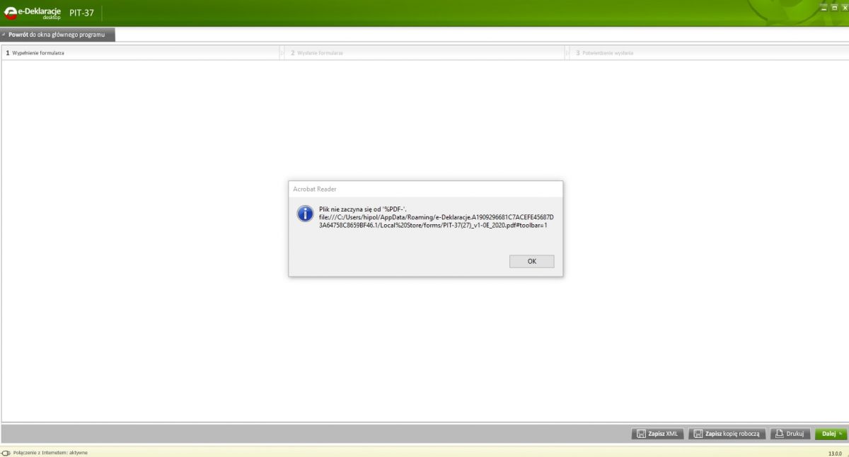

    Lahar
    Posts: 35
    Hello, I do not want to create a new topic, so I will describe my problem here.
    My problem is that I don't want to open the form with pit 37, everyone else fires up without any problem. Maybe someone had a similar problem and knows the solution, below I am throwing screenshots of the above-mentioned situation.
    The latest version of 13.0.0 is installed, plus Acrobat Reader DC.

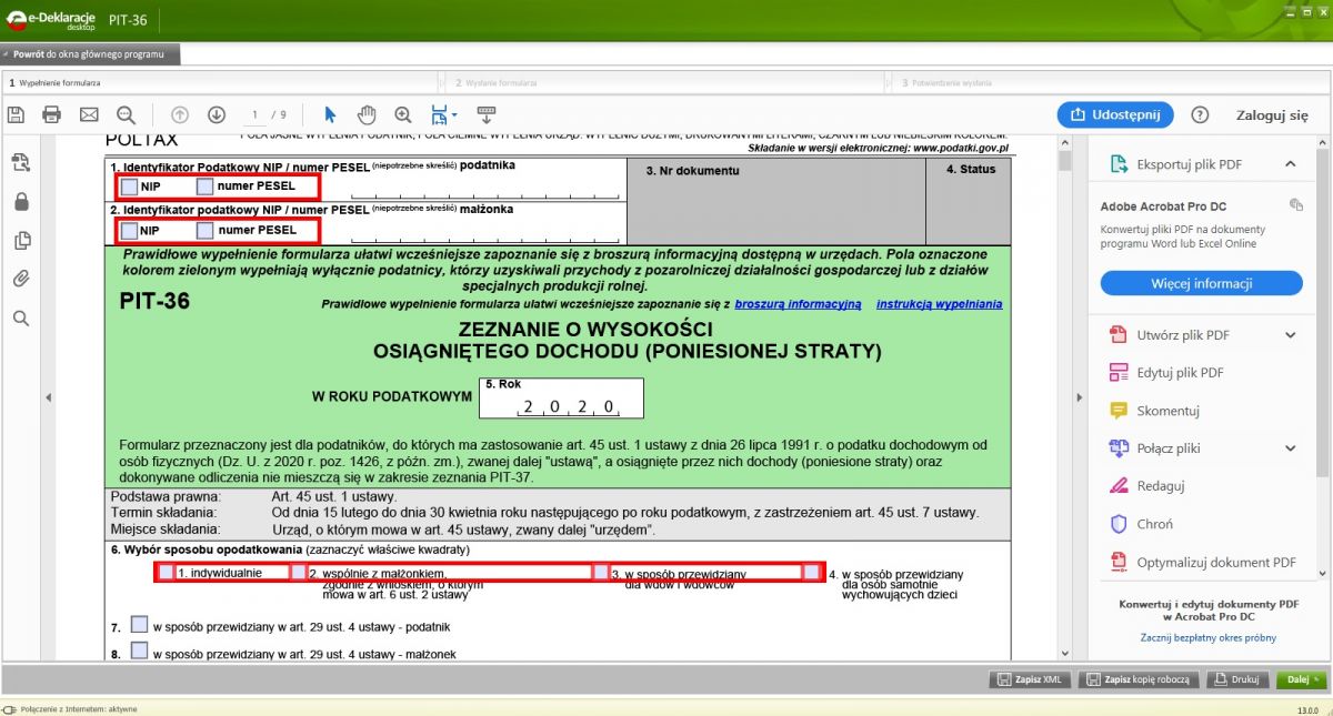

    krix777
    Posts: 14
    Hi,
    dear gentlemen, I am joining the problems with the e-declaration.
    Well, the application, after downloading the new AIR, downloading the e-declaration, gets up and does not communicate problems with the internet, but I am not able to load any form, although they are all on the list:
    Anyone have any idea what is the reason for this? Thanks!!

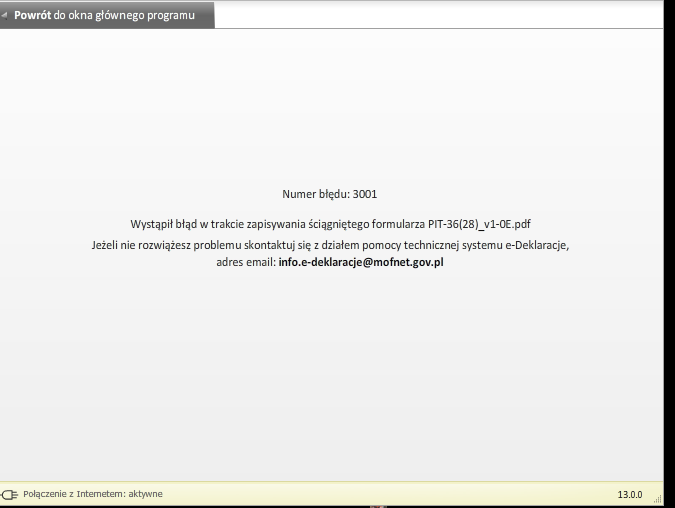

    krix777
    Posts: 14
    I got a reply from the "ministry", but unfortunately the instructions did not solve the problem:
    `In response to the notification, we would like to inform you that in the event of an error 3001 in the e-Deklaracje Desktop application, use the" Cleanup "function in the application's" Program settings "and then" Save settings ". Performing this operation will remove empty forms from the disk and force them to be downloaded again.
    After doing this, reopen the form in question.
    If the above-mentioned the instructions will not work, we recommend that you reinstall the application according to the procedure below.
    All activities should be performed on an account with administrator privileges:
    1. Make a copy of the application data file - settings2011.dat, which should be in: depending on the operating system:
    - for Windows 10, 8, 7: c: \ Users \ USERNAME \ AppData \ Roaming \ e-Deklaracje.A1909296681C7ACEFE45687D3A64758C8659BF46.1 \ Local Store
    2. Uninstall the application (if installed) and Adobe AIR as well as Adobe Reader using add / remove programs.
    3. Download and install the current Adobe AIR environment (https://airsdk.harman.com/runtime).
    4. Install Adobe Reader.
    5. Download the application installer file from https://www.podatki.gov.pl/e-deklaracje/aplikacja-e-deklaracje-desktop/ to the disk and run it from the disk.
    It is also recommended to delete the application data (described in point 1) by deleting the e-Deklaracje directory.
    When you restore data, you replace this new file with the backup file you created in step 1.
    I HAVE! IT WORKS!!
    AVAST antivirus added this folder C: \ Users \ {user} \ AppData \ Roaminge-Declarations.A1909296681C7ACEFE45687D3A64758C8659BF46.1 to block against ransomware :)
    The rule must be deleted. I am adding a screenshot in the attachment.

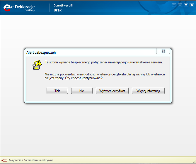

    d2rreq
    heimdall wrote:
    Welcome,
    there is no need to uninstall the E-declarations application. The problem is that the runtime for this application, Adobe AIR, "changed the vendor". Until the end of 2020, it was maintained by Adobe, but only in terms of security patches, while from the beginning of 2021, the Adobe AIR 32 version is no longer completely supported by Adobe. Harman took over the development and maintenance. A new version of Air (33+) is available now, but download the installer from the airsdk website (....)
    So, just follow the steps below:
    1. Make a copy of the data via Program settings> Export data file (just in case!)
    2. Close the E-declarations program
    3. Download the file from the airsdk (...) website and run it (the installer will detect the Adobe AIR version itself and update it)
    4. Restart the operating system (probably the E-declarations program will not start)
    5. After restart, start E-declarations, wait for the update prompt, download and perform the update
    I am following the steps above and there is still a problem with the certificate. In the course of point 5, i.e. update, the message "This application cannot be installed due to a certificate problem. The certificate does not match the certificate of the installed application, does not support updates, or is invalid. Contact the application manufacturer."
    Does anyone know how to solve this problem and update e-declarations?
  • #43 19396181
    jerz8
    For me, it worked only after manually uninstalling the edeklaracje program. Before that, save the backup (export files), uninstall eddeclarations, download the latest version from gov.pl, install and import backup files
