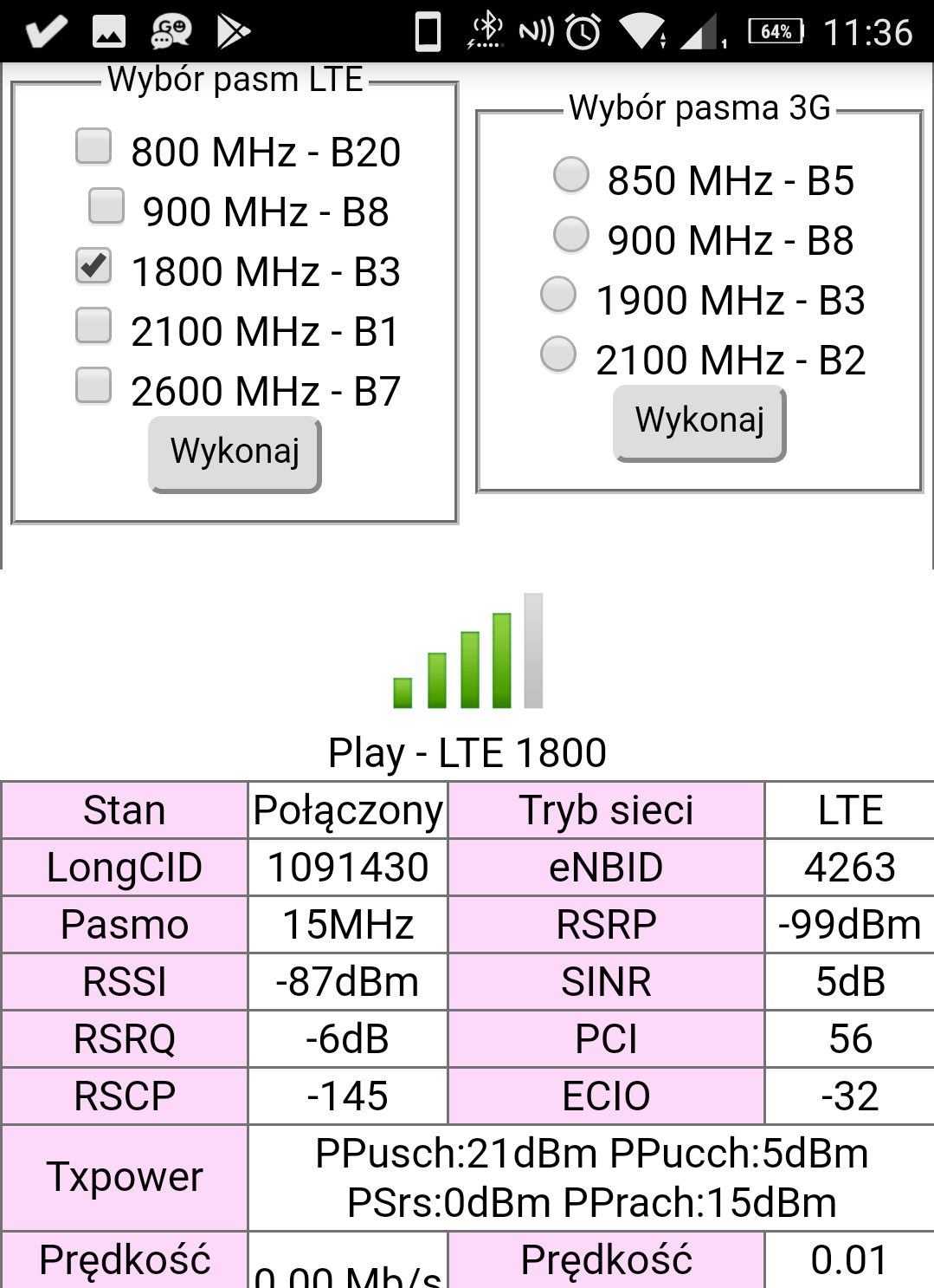

    I have a few questions about choosing a router and optimal parameters.

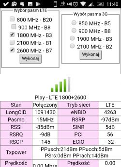

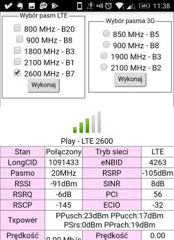

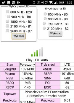

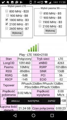

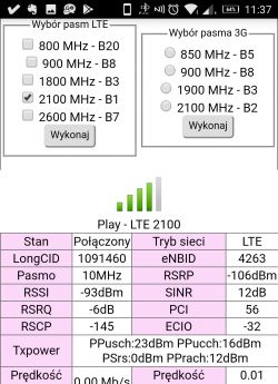

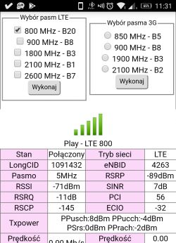

    I am currently using Huawei B715 (cat. 9 - as I understand it aggregates up to 3 bands) on the Play network.
    HManager at the auto setting shows me that:
    - I use BTS in Borowa Góra (1.4 km in a straight line) - info on BTS below
    - sporadically switches to band aggregations (LTE +)
    I forced the individual bands with the following speedtest results:
    Band ping DL UL
    CAR thirty 58,60 6.26
    800 29 1.64 7.04
    1800 29 17.55 4.22
    2100 thirty 22.72 3.97
    2600 thirty 20.22 2.24
    1800 + 2100 33 28.52 5.44
    1800 + 2600 thirty 45.09 4.04

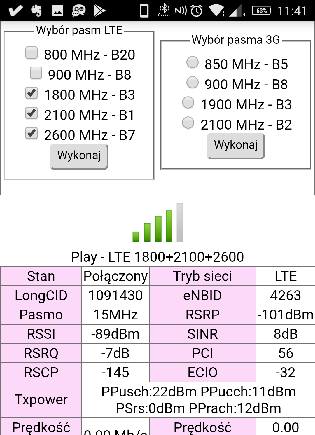

    1800 + 2100 + 2600 27 56,97 5.33
    In the AUTO mode, the result is similar to the aggregation of 3 bands: 1800 + 2100 + 2600, however, HManager does not signal aggregation - with the + sign at LTE (LTE +) (occasionally switches to this state).
    HManager results - below:
    Huawei B715 - settings for Play, replacement, antenna selection
    In this regard, the questions:
    1. Is the optimal solution searching for a router that supports these 3 bands (1800/2100/2600 with the possibility of aggregation)?
    2. This option gives me Huawei B715, which is testing - but nevertheless it is offered mainly by Play and I prefer to buy the device independently - it is not in stores - is there any replacement at a reasonable price?
    3. Is it worth thinking about the antenna in this case - and if so, which one?

    LTE + will be when there is data transmission, e.g. when performing a speed test.
    I suggest buying two antennas, e.g. Telkob ATK504 and using the shortest possible cable.

    rombad
    Posts: 11
