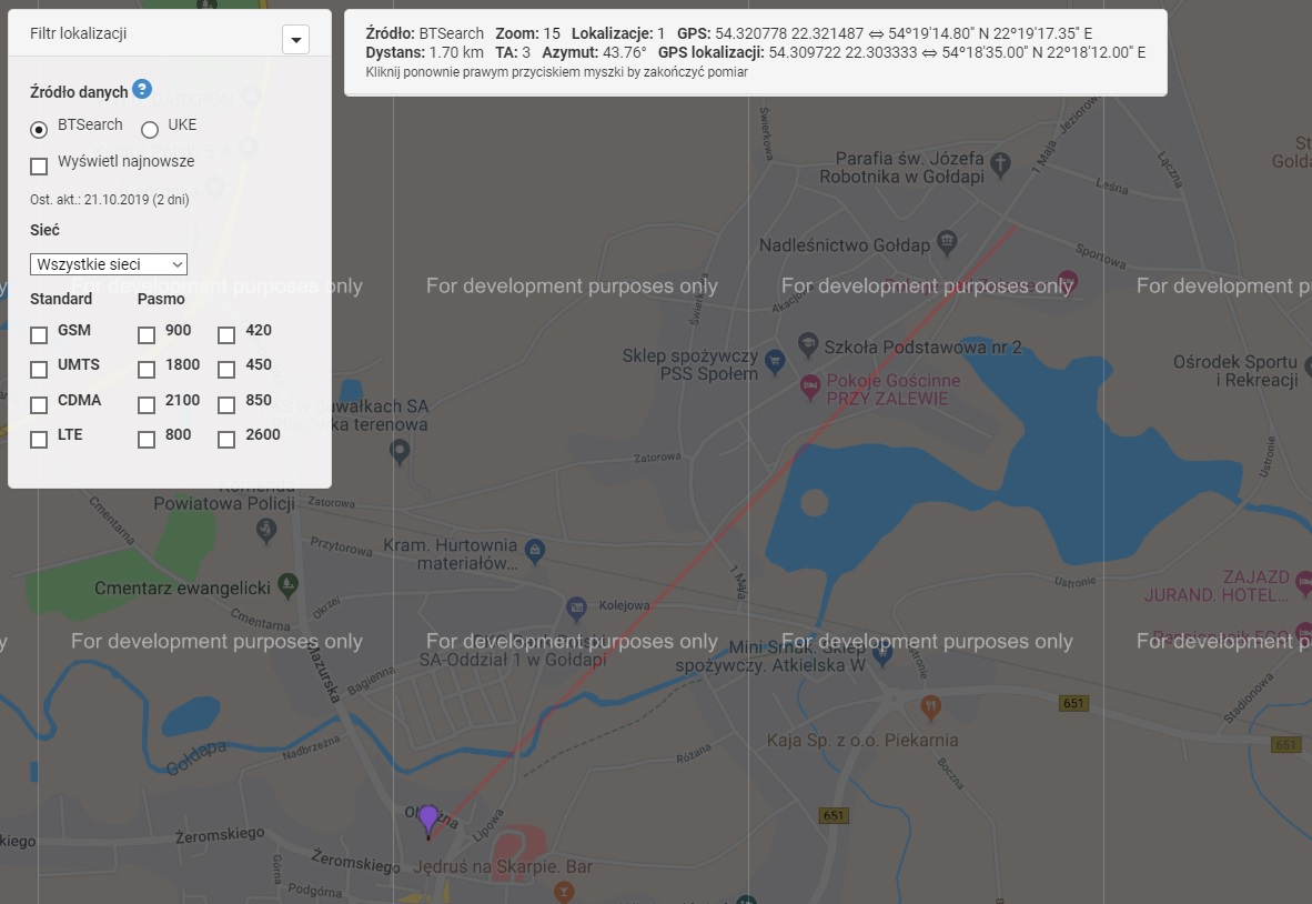

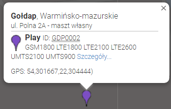

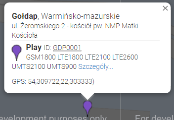

    Play network, the nearest BTS - 1.7 KM from me: Best Antenna for LTE Bands (1800, 2100, 2600) Aggregation: Huawei B715 & Cybertech 17dBi MIMO and 2.4 KM from me another BTS: Best Antenna for LTE Bands (1800, 2100, 2600) Aggregation: Huawei B715 & Cybertech 17dBi MIMO
    Tomorrow I will throw screens because only tomorrow I will have the router at home.

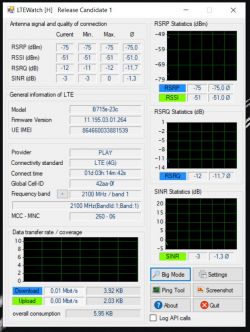

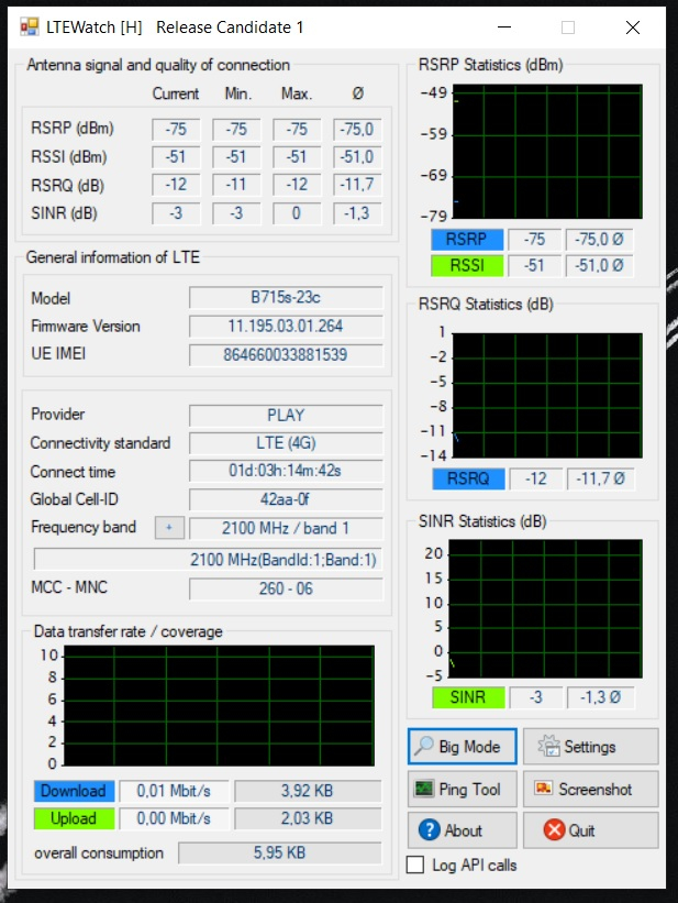

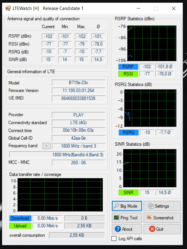

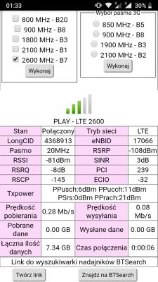

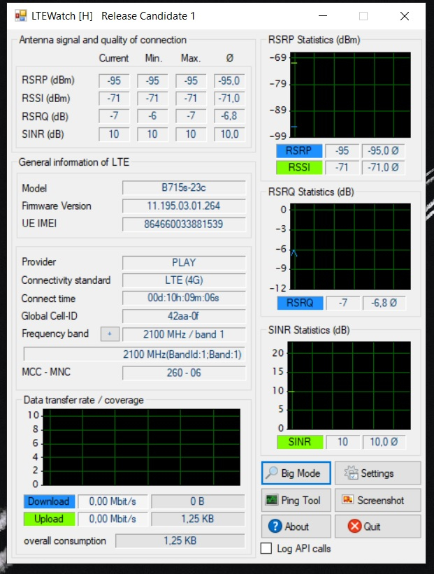

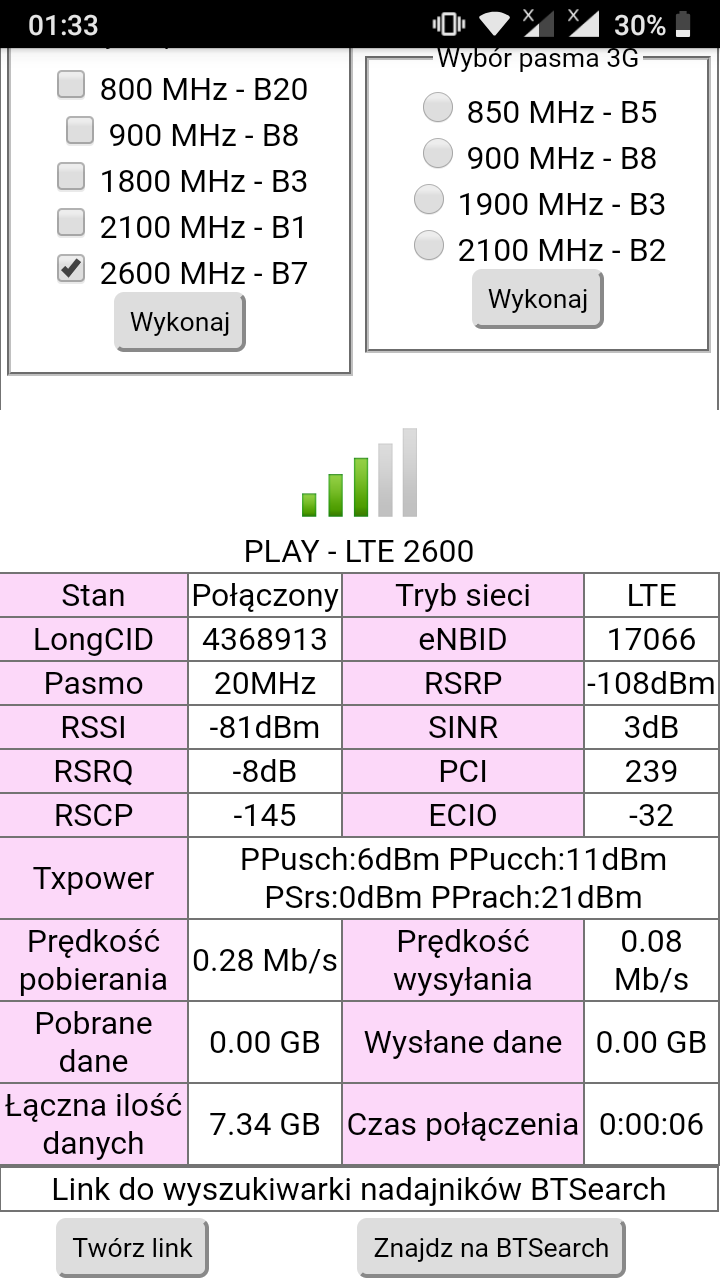

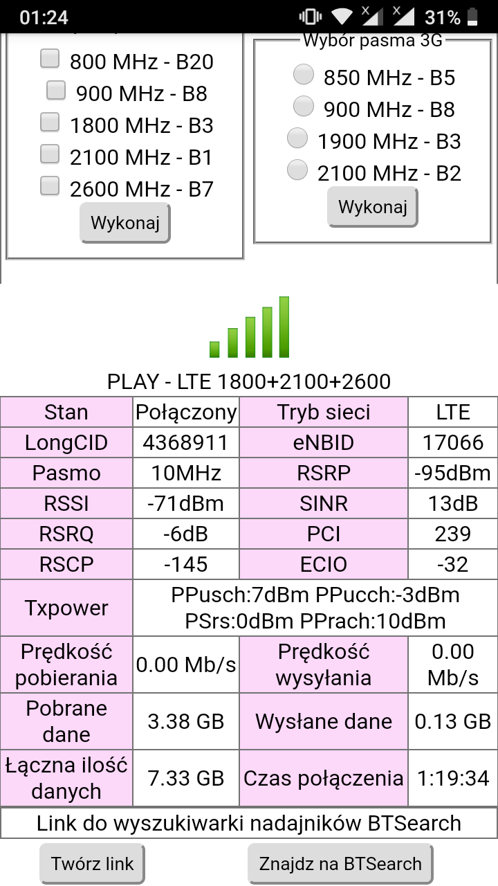

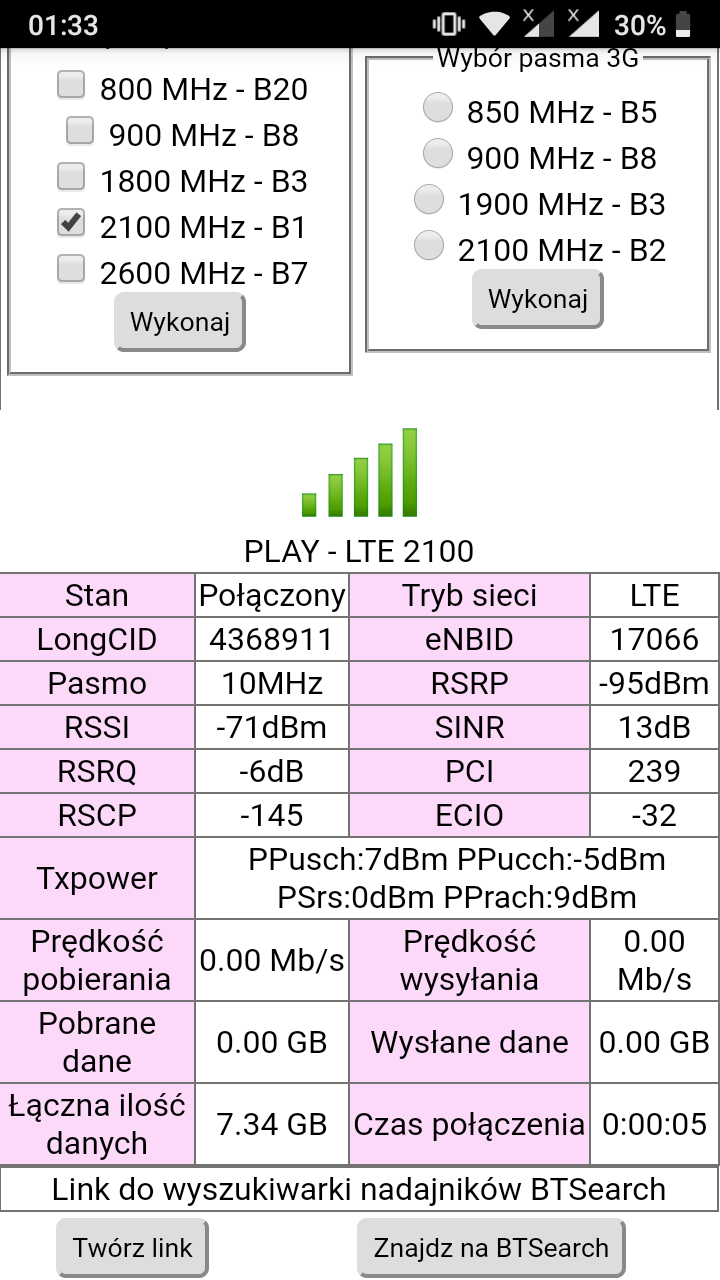

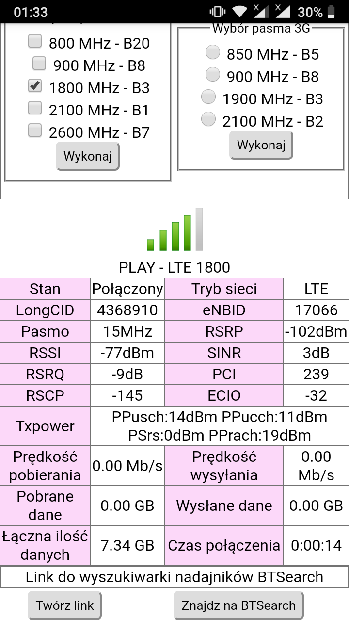

    Home router - no external antenna - 3 band aggregation: Best Antenna for LTE Bands (1800, 2100, 2600) Aggregation: Huawei B715 & Cybertech 17dBi MIMO
    HManager - aggregation of 3 bands: Best Antenna for LTE Bands (1800, 2100, 2600) Aggregation: Huawei B715 & Cybertech 17dBi MIMO
    LTEWatch - 3 band aggregation: Best Antenna for LTE Bands (1800, 2100, 2600) Aggregation: Huawei B715 & Cybertech 17dBi MIMO

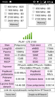

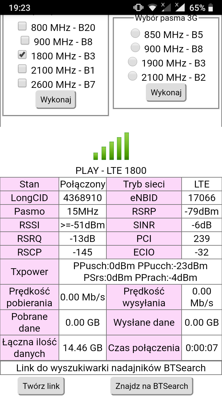

    1800MHz: Best Antenna for LTE Bands (1800, 2100, 2600) Aggregation: Huawei B715 & Cybertech 17dBi MIMO Best Antenna for LTE Bands (1800, 2100, 2600) Aggregation: Huawei B715 & Cybertech 17dBi MIMO
    2100Mhz: Best Antenna for LTE Bands (1800, 2100, 2600) Aggregation: Huawei B715 & Cybertech 17dBi MIMO Best Antenna for LTE Bands (1800, 2100, 2600) Aggregation: Huawei B715 & Cybertech 17dBi MIMO
    2600MHz: Best Antenna for LTE Bands (1800, 2100, 2600) Aggregation: Huawei B715 & Cybertech 17dBi MIMO Best Antenna for LTE Bands (1800, 2100, 2600) Aggregation: Huawei B715 & Cybertech 17dBi MIMO
    I don't know why, but it draws everything from this further BTS which is 2.4 KM from me. Why not pull the one closer - 1.7 KM?
    Today the antenna will come, maybe it will jump to the closer BTS with the antenna.

    The signal parameters on LTE2100 are the best and the bandwidth is therefore basic in 3 CC CA B1 + B3 + B7 (often has priority on BTS Play), worse on LTE1800 and poorly on LTE2600, but it's normal since the router is inside. Connection with BTS Polna because that's probably how the sectors are set on these 2 BTSs. Cybertech's antenna has a horizontal beam angle of 30 degrees, so you can check both BTSs by setting it one by one on them. LTE2600 should also work as a baseband, it is important because it is the widest band and the least loaded, UL on it is by definition 2x higher than on LTE2100, it is often useful, an antenna from Cybertech with a standard h155 cable or with another one and N connectors on the housing?

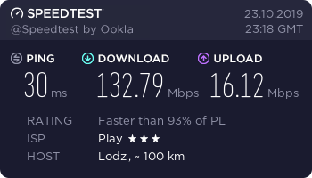

    I ordered an antenna from Cybertech: "Dual antenna LTE-A / 4G 17dBi MIMO 1800-2600MHz", in options I chose: 5 meters of cable - H155 and connector: SMA (m) - directly on the cable. There were no more options on the Cybertech website.
    Somewhere in 2 hours, the courier will bring the antenna and see what it will look like with the antenna.
    Added after 7 [hours] 26 [minutes]:

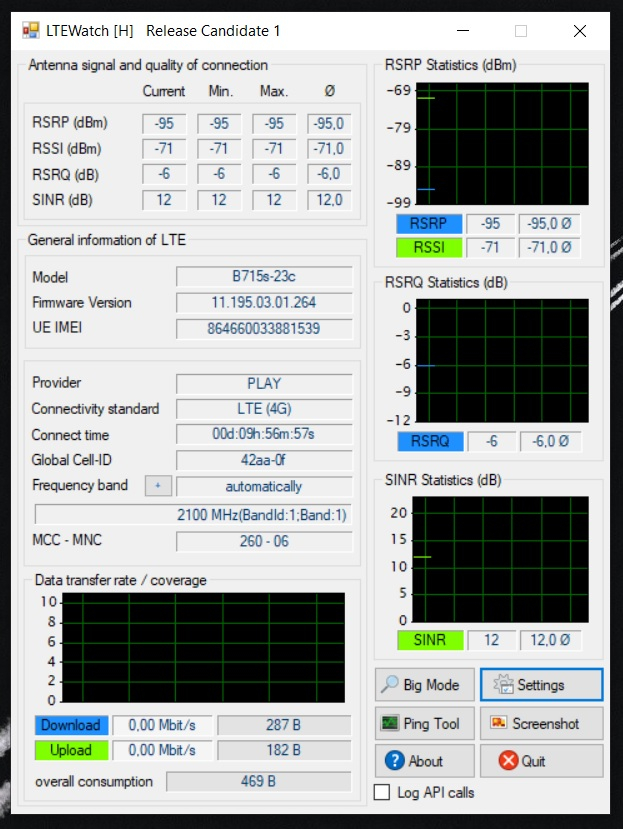

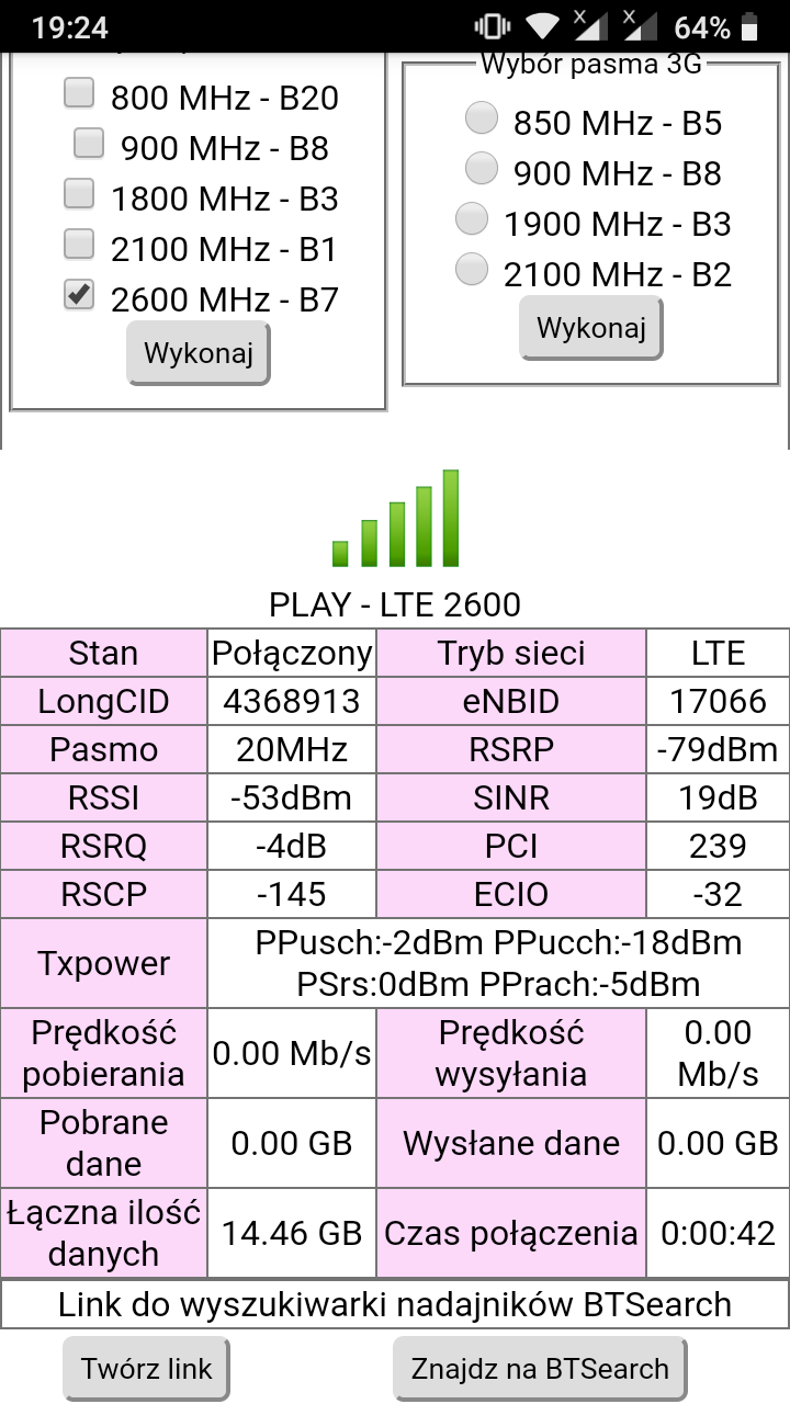

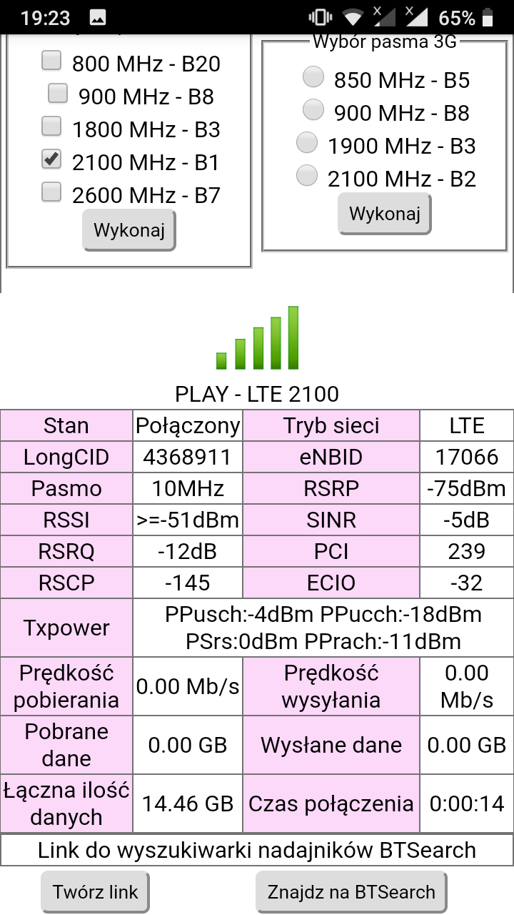

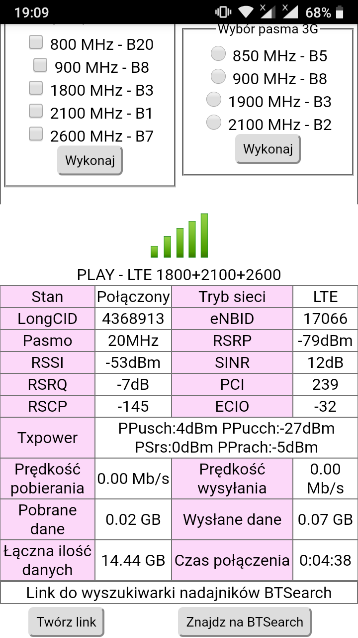

    This is what it looks like with the antenna:
    2100MHz: Best Antenna for LTE Bands (1800, 2100, 2600) Aggregation: Huawei B715 & Cybertech 17dBi MIMO Best Antenna for LTE Bands (1800, 2100, 2600) Aggregation: Huawei B715 & Cybertech 17dBi MIMO
    1800MHz + 2100MHz + 2600MHz: Best Antenna for LTE Bands (1800, 2100, 2600) Aggregation: Huawei B715 & Cybertech 17dBi MIMO Best Antenna for LTE Bands (1800, 2100, 2600) Aggregation: Huawei B715 & Cybertech 17dBi MIMO
    Is it okay or something wrong?
    Today I have a problem with this BTS on aggregation: Best Antenna for LTE Bands (1800, 2100, 2600) Aggregation: Huawei B715 & Cybertech 17dBi MIMO
    Yesterday without an antenna on aggregation it was like this: Best Antenna for LTE Bands (1800, 2100, 2600) Aggregation: Huawei B715 & Cybertech 17dBi MIMO
    #16 18239821
    matek451
    Posts: 31052
    Help: 4314
    Rate: 5708
    The antenna works fine, your signal parameters are perfect. Check how it works on AUTO.

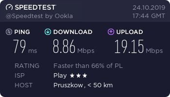

    Hello. I would like to ask for help in choosing the lte antenna.
    Location: Tenczynek 32-067 ul. On the rocks (at the end of the road)
    Router: Tp-Link mr6400
    Operator: Play
    The connection is very unstable and weak, although the tests give results around 6 mega, sometimes it is difficult to open the page, in the evening this net does not work at all.
