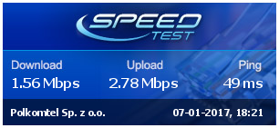

    I forced LTE 1800 one by one and here's the speedtest: Which LTE antenna for Huawei B315 router
    and LTE800: Which LTE antenna for Huawei B315 router
    These speeds dropped and increased slightly but were usually similar to each other.

    In both cases, the connection with BTS at Spichrzowa 12. On LTE1800 the signal parameters are weak, on LTE800 a little better. You should buy the antenna 1.5 years ago. It is generally seen that in both cases BTSs are overloaded (UL> DL). Better results rather on LTE1800Aero2 incline to buy Dual LTE 1800MHz antenna. It will definitely improve the LTE signal parameters but it is difficult to say how it will translate into speed. The directional antenna will also connect to BTS LTE1800Aero2 at Roosevelt, if it works. Maybe it will provide better speed. BTS LTE1800Play and LTE1800NetWorks for Orange and T-mobile also operate at Spichrzowa. Buy Orange starter for PLN 5, register. You will get a 100GB / month bonus and if you provide the address, another 100GB. Check how Orange works. 200GB for 5 PLN is an opportunity. Plus, the Play Pre-paid Internet starter for PLN 9, register and you'll get a 100GB bonus. Check LTE at Play. With this operator you can have LTE internet without limit, without a contract and equipment for 5 PLN / month, already 4 years. What were your reasons for extending your contract at CP? You had E3372 so you could have used this Play offer for 2 beers per month. By when will this contract with CP? Plus / CP is not an operator for this location. And many others. For a long time, he didn't modernize the network, he just sold power like you.
