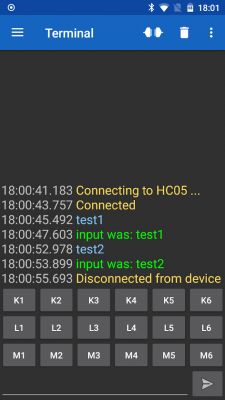

    Serial Bluetooth Terminal is a smartphone app, a terminal simply (like Serial USB). Add a parser to the ESP32 so it understands what you are sending to it and what you want it to do. It can also send you messages.
    Here is a link : Link .

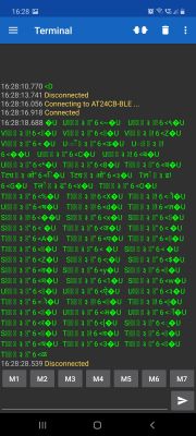

    This terminal I tested, but the counter sends chaff which I cannot process.
    How to Download Data from Electricity Meters via ESP32 Bluetooth? .
    What I want is for the ESP32 to be able to connect to the counter and process the data received, because I don't need all of it.

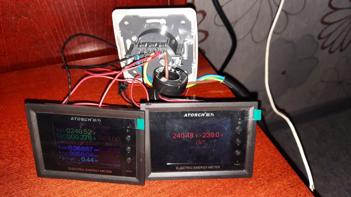

    My question is whether it is possible for one ESP32 to connect to two meters - I would like to download data from the meter on electricity consumption and production.

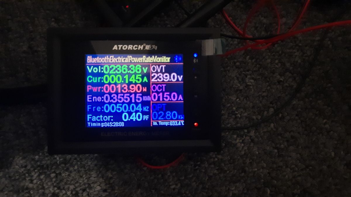

    237.2V * 0.143A = 33.9W and the result shows 13.6 (of what?). Maybe these are Wh (energy) and not W (power)?
    The above figures were with the power supply load from the laptop.
    Count the following data for yourself - heater load.

    I am connecting to two counters at the same time using the program below.
    I don't quite know how to display the received data from the counters now.
