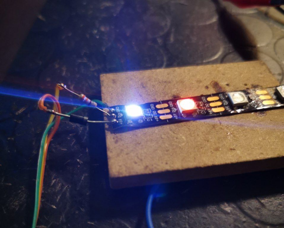

Your setup ended up being a mix of code and hardware issues: after fixing the LED indexing in the code and using the level shifter correctly, the strip started working [#21624203][#21624307] The working FastLED test used `leds[0]`, not `leds[1]`, and `COLOR_ORDER` was `GRB` with the first LED toggled on the chosen GPIO [#21623929][#21624098][#21624307] The ESP32’s 3.3 V output can be marginal for WS2812B at 5 V because the logic-high level should be at least 0.7·Vdd, so the 74AHCT125 is a valid fix; alternatively, lowering LED supply to about 4.4 V can make 3.3 V logic work without a converter [#21622606][#21624440] The thread also suggests the “sacrificed” LED may have been damaged during probing, since touching the data pin with a meter caused random weak lighting and odd behavior [#21624028][#21624203][#21624440] Once the corrected code and shifter were in place, the LEDs worked, so the final diagnosis was not just wiring but also an indexing/code mistake and possibly a harmed LED [#21624307][#21624440]
  • GPIO2 may be a bad WS2812B output pin

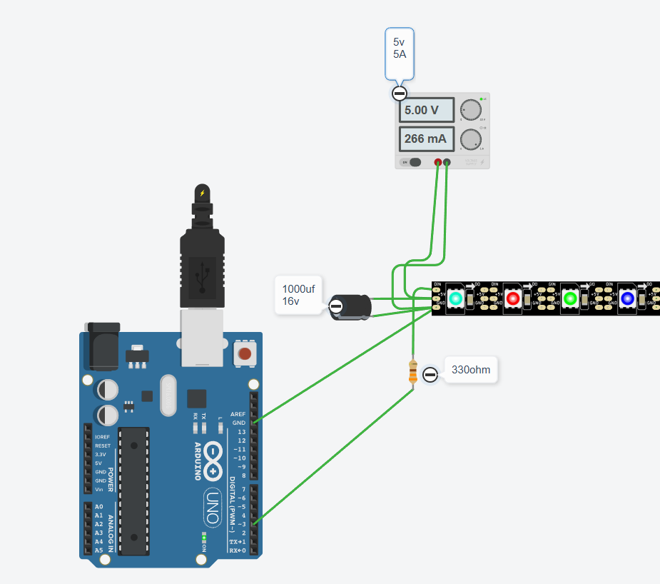

    I started to make myself an "automatic vodka dispenser" and I have almost everything ready, only I have a problem with the leds (WS2812 Link to ali ), neither chinese nor american AI could help me so I decided to create an account here and ask, maybe someone will have an idea. I did something similar on tinkercad.com (the same leds I also tried on my esp32 cp2102). Exactly the same wired leds, the only difference is in esp I tried GPIO2, 5, 13 and 35 no and only one led and on tinkercad it works.... I tried through the capacitor and resistor alone, then through the 74AHCT125 hoping it would work but to no avail, the diode only lit up when I shorted the DIN to GND or when I quickly switched from gnd to din at the diode itself, the faster I did it the brighter it lit up (different colour but still) and I have no idea, maybe someone here can help 🤮.
    admittedly, the project works well without leds, but still, it would be nice if there was such a signalling...
    Wiring diagram of WS2812B LED strip to Arduino with 5V power, capacitor, and resistor .
    AI: How exactly do you power these leds? From what voltage, is the ground of the ESP32 and the leds definitely common, and do you power them directly from the ESP or from a separate power supply? .
    everything as in the picture

    I once wrote something like this on esp32 - it worked.
    In your program there is a definition
    Code: Arduino
    it means that you have a strip with one led !
    Enter there the number of leds in the bar

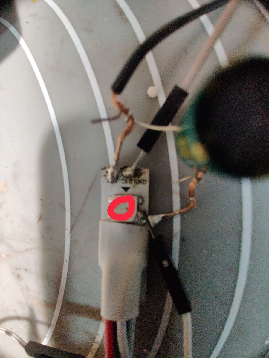

  • Single LED still only faintly lights on power cycle
    #3 21622564
    cototo1991
    Posts: 10

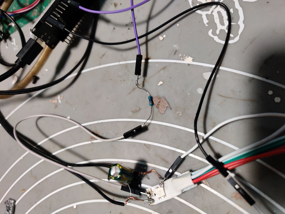

    Thanks, I threw in, changed to 1 diode and a total of 3 different pins (2, 4 and 15) and also zero response, I switched everything on short (burble I know)
    Close-up of loosely connected wires, resistor, and jumper connectors on a work surface .
    The only response is when I unplug and plug it in again, it lights up very faintly, but that too is rare
    Close-up of LED strip connector with provisional wiring and labeled pins .
    I have checked other LEDs from the strip and they respond in the same way

    Strange things a colleague is doing
    how many leds are there in the strip/circuit ?
    which gpio is the control pin connected to ?
    Don't connect in the middle of the circuit only at the beginning - hope you didn't damage the diode.
    The diodes are connected by a single wire data bus in series so you need to connect to the first diode in the circuit.

    Maybe your LEDs don't want to work with 3.3V logic - my strip worked normally powered from 5V and controlled from the esp32 pin (logic3.3V) without a resistor.
    If you have an arduino uno or something else with 5V logic on hand then try it on that. Alternatively try with a 3.3V-5V converter
    or
    https://hackaday.com/2017/01/20/cheating-at-5v-ws2812-control-to-use-a-3-3v-data-line/

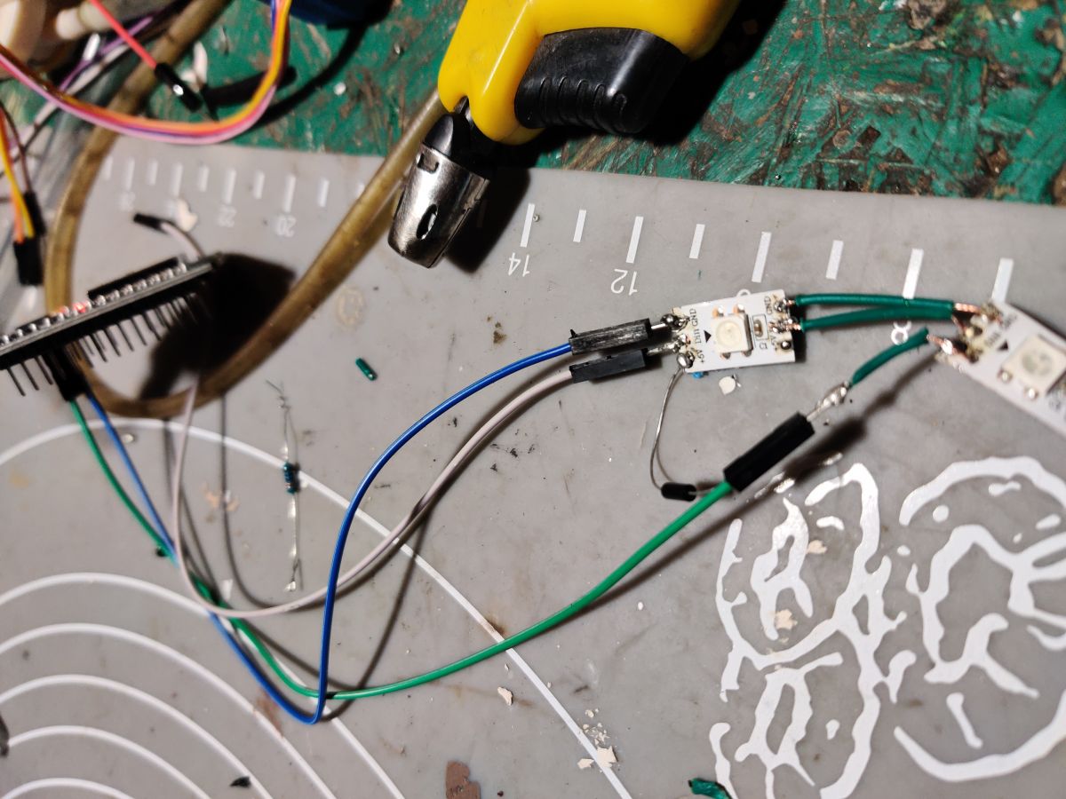

    "Thanks, I've uploaded, changed to 1 LED and a total of 3 different pins (2, 4 and 15) and also zero response, I've switched everything on short (burble I know)" I've tried, I've switched myself to 1 LED and GPIO4 (then put it on 14) but I know it works for sure because on Tinkercad it worked. I'll check this "Cheating At 5V" and let you know.
    Unfortunately it didn't work either, now I tried it with the whole tape ....
    WS2812 LED module wired on a work mat with jumper cables .

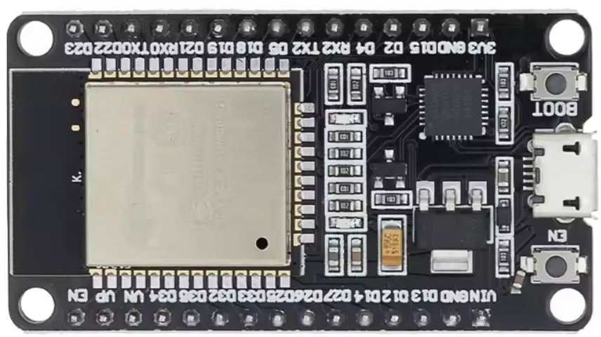

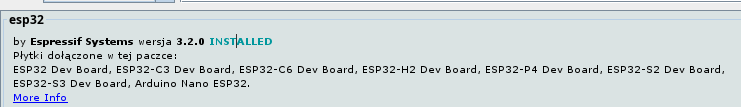

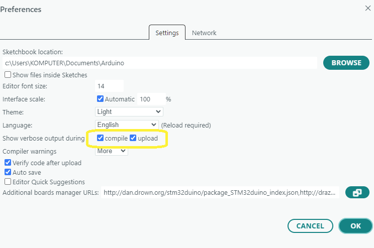

    1. send a clear photo of the microcontroller board so we know exactly what model you have.
    2. additionally, we don't know which platform (in Arduino) you are building your code from and which LED library you are using. Enable the Arduino IDE to print additional build and upload information:
    Arduino IDE settings window with “compile” and “upload” options checked .
    and paste us the build and upload log.

    ESP32 development board with labeled pins and micro USB port .
    tried adafruit and fastled[/img].
    maybe i'll just give up on them and put in the usual 4 pins (5v, g, b, r) because these at least work

    I still had the "LED box ambilight" it has the same leds in it, it under the LED box driver started but under ESP32b not either 🤮 I will try later this loop every 1 sec
    nothing worked either, I've tried every way, even 100% working, attached a picture of how it's all connected together (ugly but everything except the leds works, in the middle is this 74AHCT125) it's a bit good that I forgot about them altogether and finished them, because I probably would have given up because of the leds and now it's a pity

    The pictures are not very clear with regard to the connections. What is connected to the ESP there besides the WS control? Three wires are sufficient to drive the WS. Below is the code that works 100% on the ESP32. Tested on GPIO4 and GPIO14. Works on core 1.0.4 to 3.0.0, ESP32 Dev Module board. It sends a message every second on the UART.
    Once uploaded, the first LED lights up white, the second red. For testing (no oscilloscope), instead of the WS, you can connect a regular LED to the GPIO output of the ESP. Cathode to ground , anode via 330R resistor to GPIO. It should blink weakly every second. If the LED flashes, it should work when the WS is connected. You can also lower the WS supply to 4V and dispense with the driver. It probably can't be any simpler :) .
    Code: Arduino

    I am using 3.2.0 it can go lower (also esp32 dev module)
    Screenshot of ESP32 version 3.2.0 installed in Arduino IDE package manager

    I corrected as you wrote (I thought the 255 was RGB, that's why I changed it that way), but still the only thing it does is that it only lights the LEDs when I put the meter to the DIN of the "sacrificed" LED and DO the "sacrificed" LED.
    Get rid of it and just leave it:
    5V - LED 5V
    GND - GND 5V
    DIN - D4
    Probing WS pins causes interference and random glow

    This 'dedicated' LED should also light up. In code leds[0].
    For testing, there is nothing stopping you from powering all LEDs through the rectifier diode. They will glow a little weaker.
    The driver is then unnecessary.
    I have run out of ideas. This circuit should work from the "kick" :) .
    Touching the WS pins with probes generates some interference and random glow.
    WS2812 LED strip with white and red LEDs on, powered via a rectifier diode
  • WS2812B works after code correction with AHCT shifter
    #20 21624307
    cototo1991
    Posts: 10
    I did exactly as you showed in the picture, corrected in the code and it worked, then plugged back in everything and it works, even left the shifter of that ahct
    Only question now, since it works with the shifter, leave it as it is already? The GPIO then goes as if through two 330 ohm resistors,
    but I think it was a code issue, although I tested on this one: thanks a lot for the help🫡.
