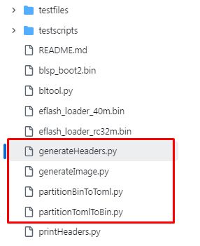

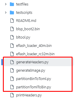

    See this commit message from 5 years ago:
    https://github.com/renzenicolai/bl602tool/commit/d2cf6cf8366dbe859d8436017e8476aab5d062e5
    Add partition tools, generateImage can now generate a valid image (for a single test case)
    Added after 20 [minutes]:
    Or maybe this snippet will be enough? generateImage.py:
    https://github.com/renzenicolai/bl602tool/blob/main/generateImage.py
    Code: Python
  • #8 21617084
    Posts: 4850
    Help: 421
    Rate: 854

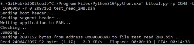

    Is your BL602 the same Ai-Thinker with CH340?
    Added after 3 [minutes]:
    hmm. 2mb read is goes on forever then crash
    I wonder if these eflash loaders have been superseded with newer

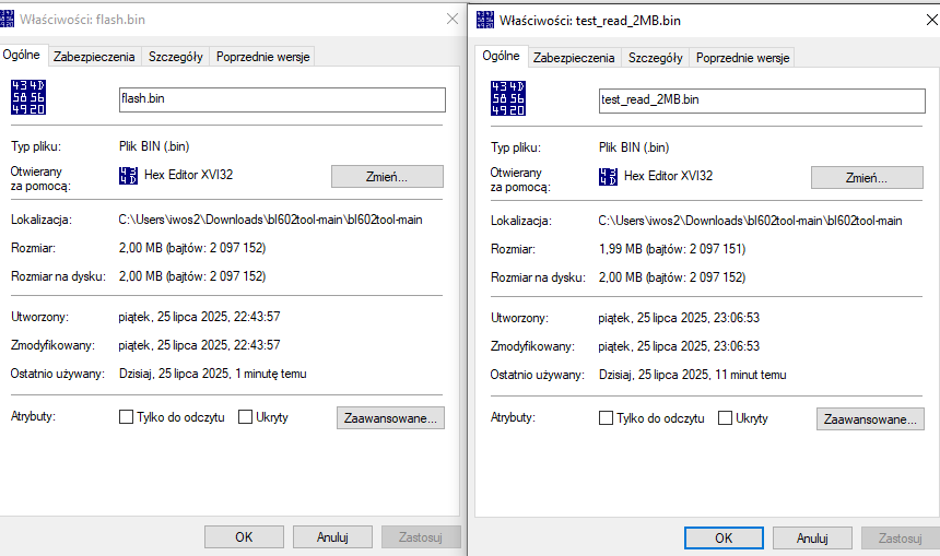

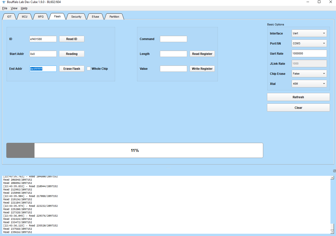

    Ok testing. Dev cube:
    testing bl602tool from renzenicolai for BL602 flash read and write
    renzenicolai tool:
    Downloads\bl602tool-main\bl602tool-main>bltool.py -p COM3 -r 0 65536 test_read_64KB.bin
    Sending boot header...
    Sending segment header...
    Writing application to RAM...
    Checking...
    Jumping...
    Reading 65536 bytes from address 0x00000000 to file test_read_64KB.bin...
    They seem to match:
    I have DT-BL10 dev kit. This one: https://www.elektroda.com/rtvforum/topic3900145.html
    Btw BLDevCube requires 0x1FFFFF flash size, so 2MB - 1

    bltool.py -p COM3 -r 0 2097151 test_read_2MB.bin
    Checking...

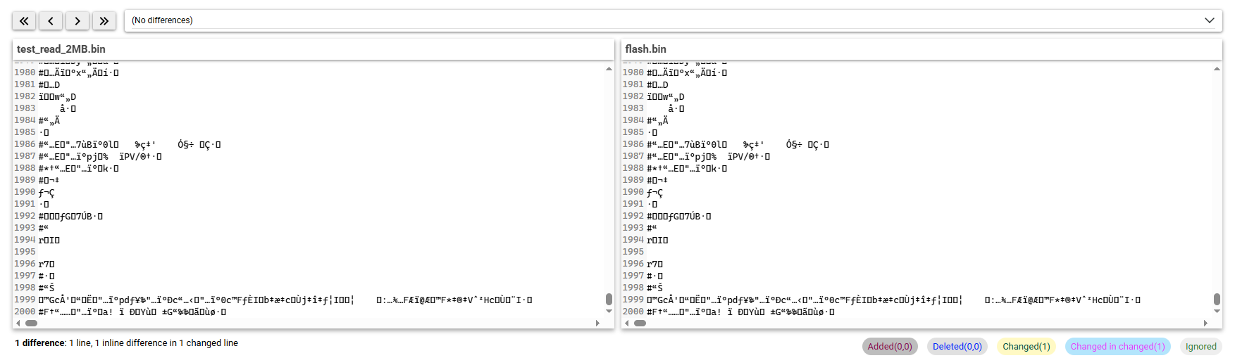

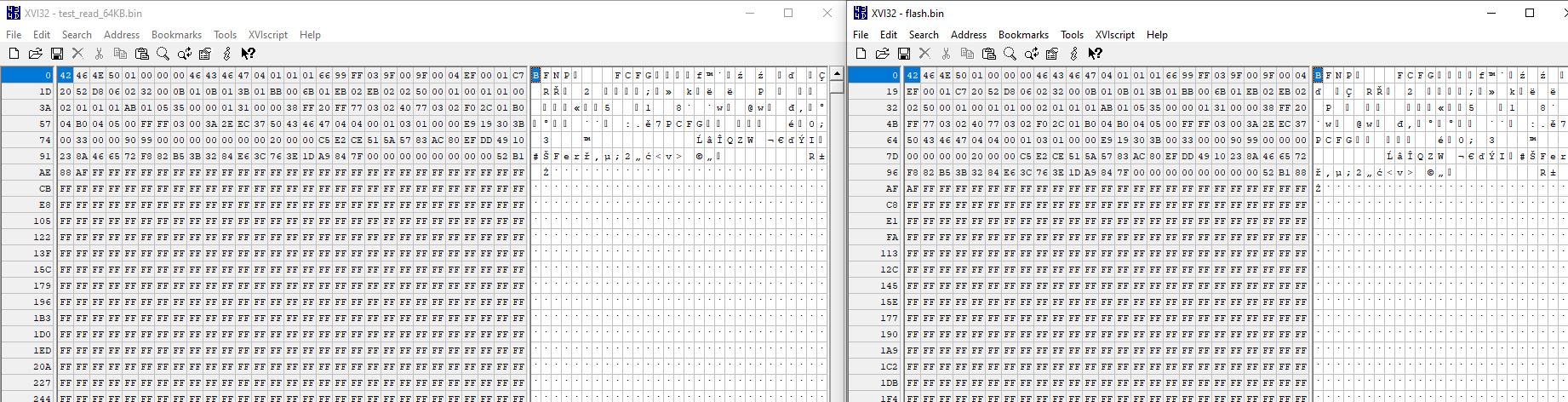

    Jumping...
    Reading 2097151 bytes from address 0x00000000 to file test_read_2MB.bin...
    bl602tool-main>fc /b test_read_2MB.bin flash.bin
    Comparing files test_read_2MB.bin and FLASH.BIN
    FC: FLASH.BIN longer than test_read_2MB.bin
    It seems the only difference is single byte in length at the end of file

    oh i see. I always use these addresses in BLDC:
    my bltool 2mb dump is still going. very slow.
  • #21 21617165

    Rate: 12345
    Your table is interesting. 0x001FFFFF hexadecimal is in reality 2097151 decimal, not 2097152 decimal, but I assume it's on purpose?
  • #23 21617172
    Posts: 14408
    Help: 650
    Rate: 12345
    Hmm so BLdevcube requires size minus 1 byte.... and then reads whole 2MB. Strange. Ok, my full 2MB read finished as well. Now, is there an option to change baud?
    It seems so.

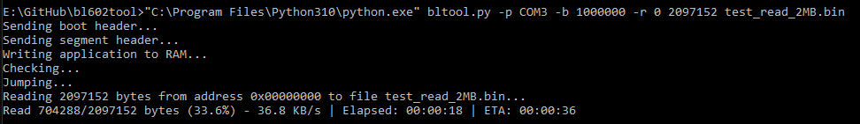

    The first baud that works for me is:
    -b 1000000
    I tried also 1500000 and 2000000 but I also got "no response"
  • #26 21617185

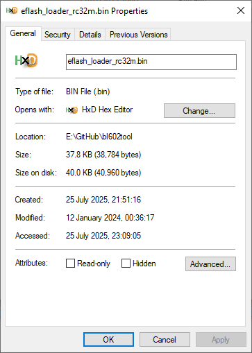

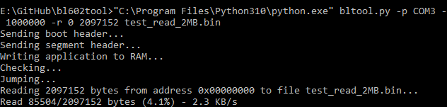

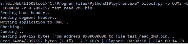

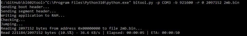

    I asked gpt to make better realtime progress.
    Terminal screenshot showing binary file read using bltool.py at 2.3 KB/s
    have also changed this file for newer in BLDC 1.9.0 but no change
    File properties window for binary file eflash_loader_rc32m.bin in Windows

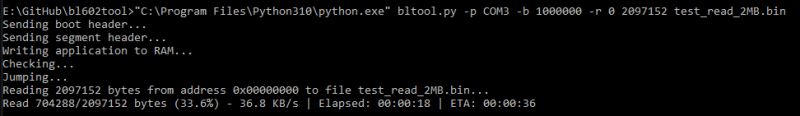

    cool
    Command line shows progress of reading binary file from flash memory
    Code: Python
    Added after 4 [minutes]:
    oh, it's scrolling not writing over previous line
    Added after 7 [hours] 23 [minutes]:

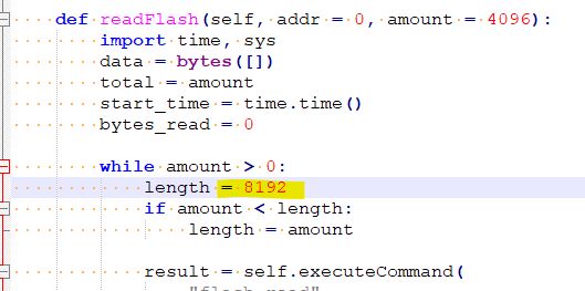

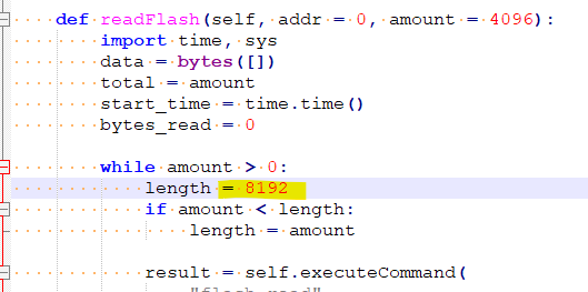

    Terminal screenshot showing flash memory read progress with speed and ETA.
    changed chunk size
    Screenshot of Python code with highlighted line setting length to 8192
    https://github.com/bouffalolab/bl_docs/blob/main/BL602_ISP/en/BL602_ISP_protocol.pdf

    Changing chunk size works? So what is the fastest speed you managed to get?
  • #30 21617442
    Posts: 4850
    Help: 421
    Rate: 854

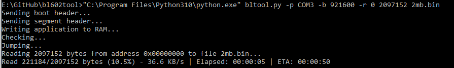

    36k/s with 8192 chunk size
    Terminal screenshot showing bltool.py reading a binary file at 36.6 KB/s
    54k/s 16384 chunk
    32168 doesn't seem to be faster than 16384
    but is it better to have a lower chunk but a working baud rate switch? I've been trying to get script to send baud rate change request at the right moment, but no success.
    BLDC dump vs 16384 chunk bltool dump
    Dialog box stating the chosen files are identical
