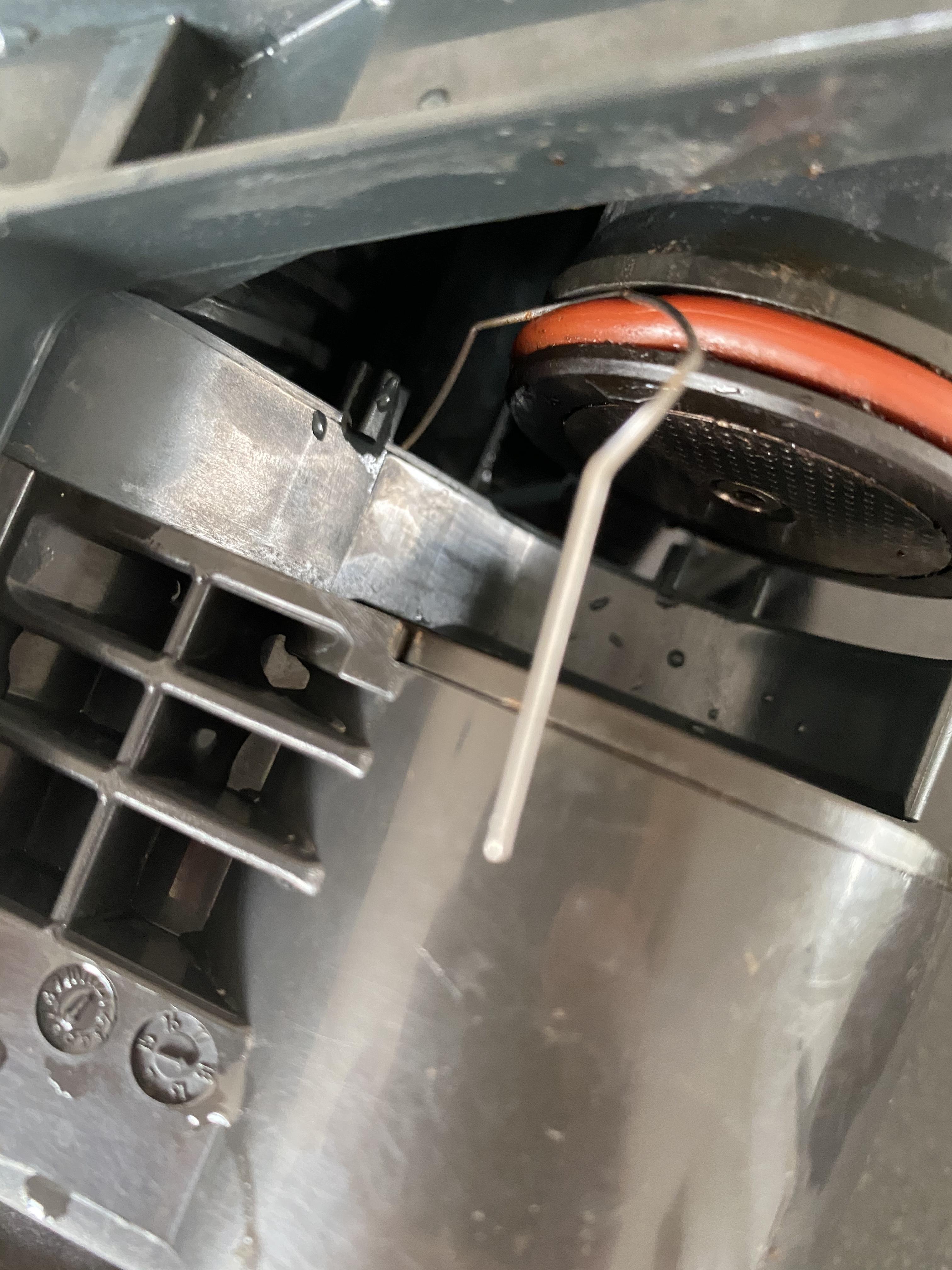

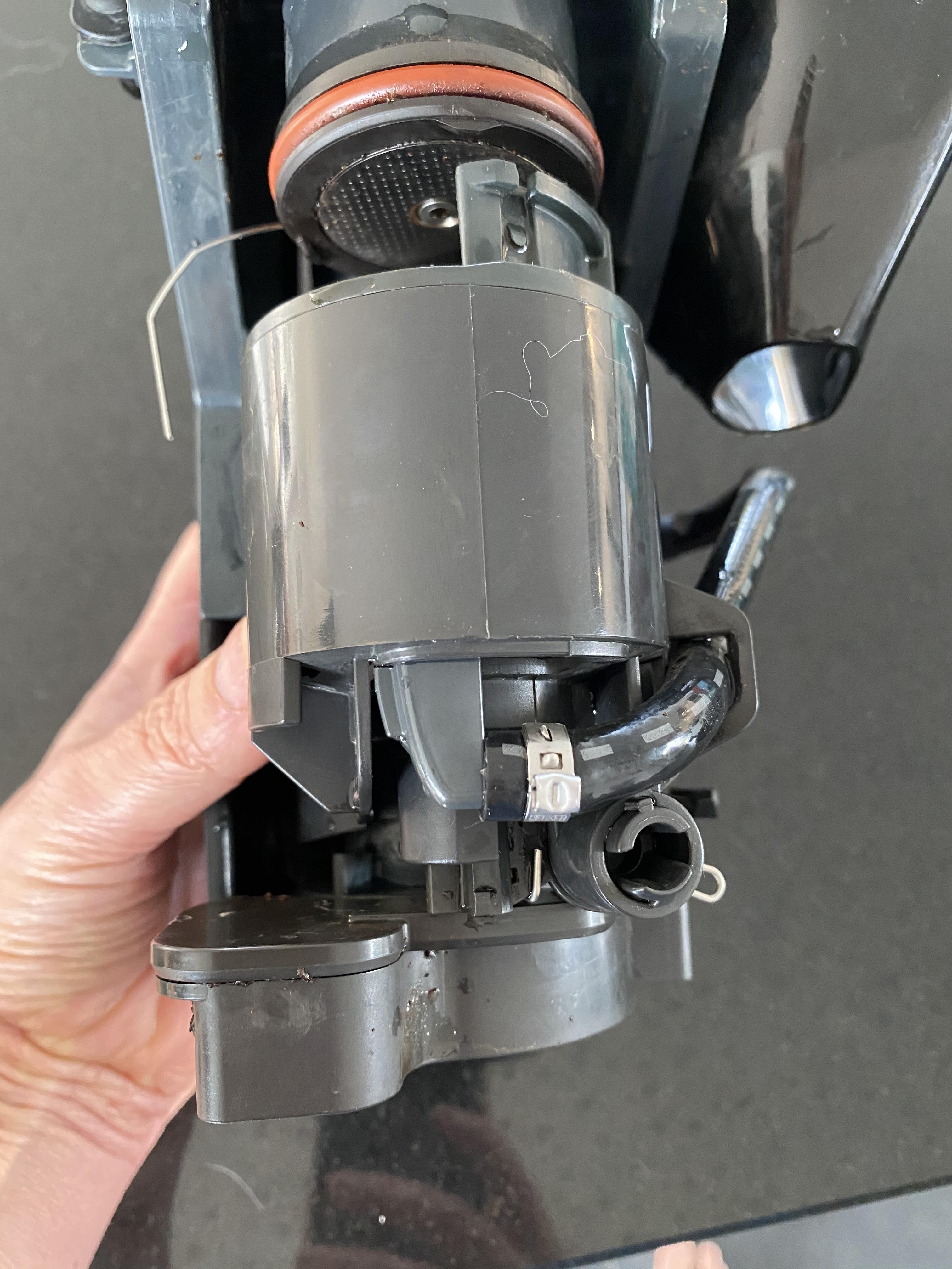

    Hi, our coffee machine seems to be broken. It worked well for a little over 2 years and last week we noticed a metal wire sticking out from the brewing unit.
    It still worked though until today. Today the machine stopped working.
    When I removed the brewing unit it turned out that not only the wire is out but the bottom of the unit that was moving is stuck too.
    Can anyone advise what to do?

    You can just replace the whole brewer unit (~$80-100). Bought on Amazon and Siemens sells brewer units.
    My solution was to use superglue to attach the broken metal wire to the brewer unit body. It has worked fine now for three weeks.

    My wire snapped in the middle; so if Siemens can't replace that specifically, then I will solder it together again. If that does not work, then I guess I'll be forced to replace the entire unit.
    Will post their feedback here when I receive it.
