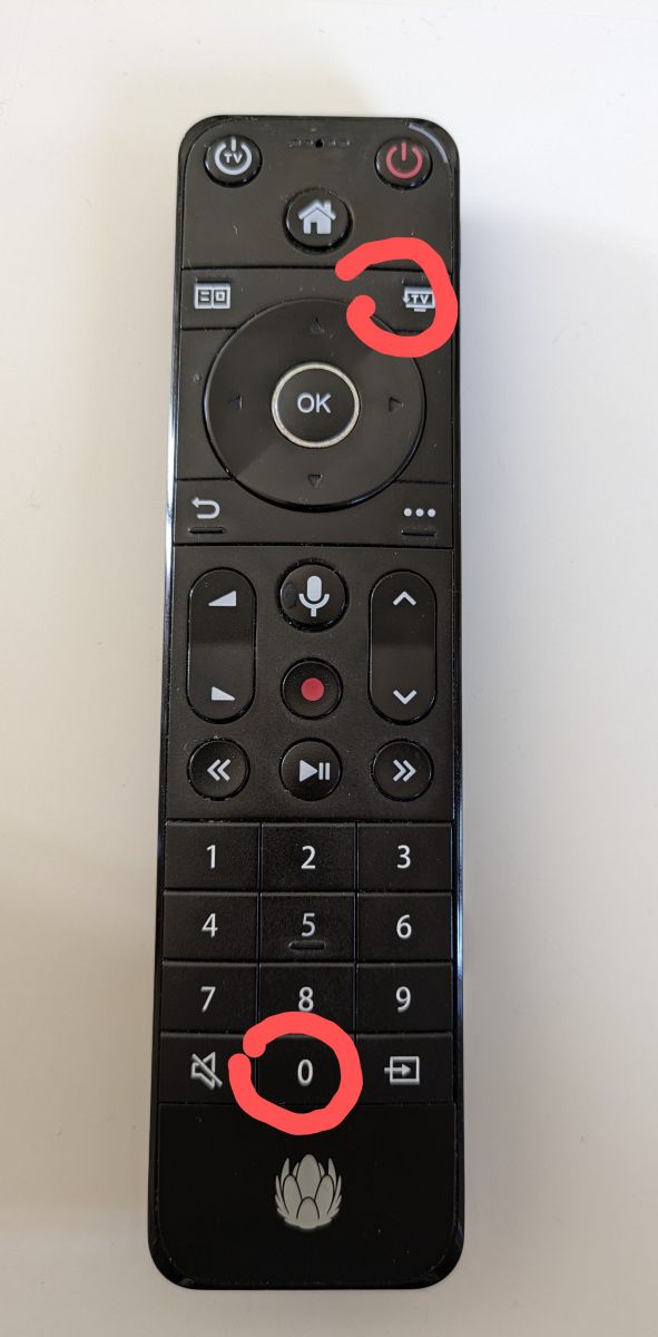

    Hello, I have a problem with the UPC BOX 4K decoder. Yesterday everything worked, in the evening I turned off the TV, and this morning the remote control just stopped responding .... it changes the volume, but you can't switch programs or open the menu. The second remote from the TV works normally. I've already tried resetting the decoder and even factory resetting the TV. The hotline cannot be reached by phone, there are no free consultants, and I would like to turn on something other than the children's channel for Christmas... Maybe there are some solutions that I haven't considered, please help ?

    Hello. I don't know if I understood your problem correctly, but it seems that the remote control is not paired with the decoder. On page 8 of the manual, I found information that to pair the remote control with the set-top box, you must simultaneously press and hold the TV button and the number 0 for 10 seconds. After these 10 seconds, select the POWER button for 5 seconds. This is what the manual I found online says. Good luck.

    I've seen the instructions, paired the remote a dozen times, it connects to the TV, but nothing but volume or mute completely won't turn on

    It is not written anywhere, but this power button must be held down on the set-top box. It helped me :)

    I had the same problem. I held down the decoder's power button and clicked the button on the side of the remote, and it worked

    Hello. I had the same problem. The white LED only flashed above the on/off button and the volume button worked. The manual said to hold down the number "0" button and the "Return to the program you were watching" button at the same time for 10 seconds and then the power button on the set-top box for 5 seconds. I did these steps but it didn't work.
    Try the other way around? First press the power button for 5 seconds, then these 2 buttons on the remote control for 10 seconds (this will be exactly shown in the paper manual or displayed on the TV). It worked for me.

    Remote control with red circles around the TV and 0 buttons.
    These 2 buttons together, the diode starts flashing for 10 seconds, it is best to do it from a distance of half a meter, then hold the switch on the decoder for 5 seconds. This happens when the batteries are weak or replaced, you need to reconnect the devices.
