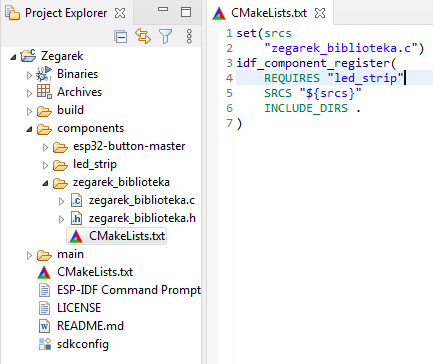

    I am able to add a library that is in the C:\esp-idf directory "led_strip.h" by adding the following entry to CmakeLists.txt:
    set(EXTRA_COMPONENT_DIRS $ENV{IDF_PATH}/examples/common_components/led_strip)
    then #include "led_strip.h" is seen in main.c and everything compiles
    How do I do the same, but with my own library which is in the project folder (eclipse workspace) and not in the C:³³³-idf directory?
    Doesn't work:
    -include itself (can't see)
    -adding the path as above leading to the project folder
    Add local component directory to EXTRA_COMPONENT_DIRS

    Thanks, this is exactly what I was looking for. Compilation successful. Esp-idf v4.2

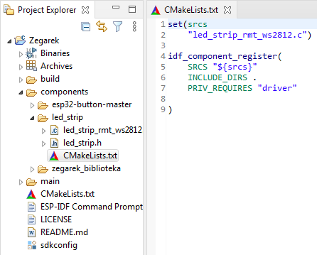

    Two words of conclusion.
    -Solution given by khoam
    You need to make a components folder inside a folder named libraries and in it CMakeLists.txt as below:
    [esp-idf] Adding a custom library from the project folder to CmakeLists.txt .
    -When we want to attach a component to a component, we have to add the following in CMakeLists.txt
    REQUIRES "nazwa_biblioteki"
    -When we want to attach a component to a component, we have to write in CMakeLists.txt.
