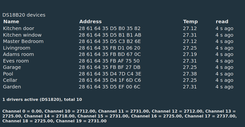

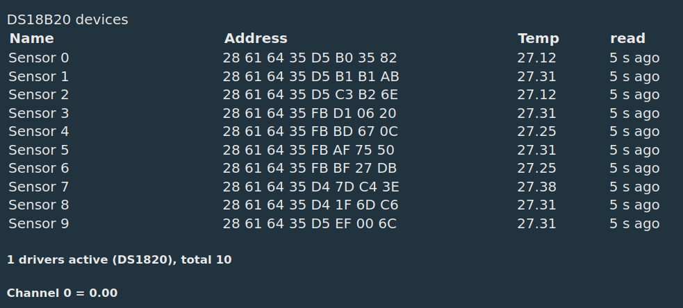

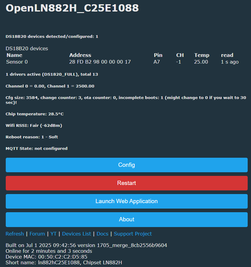

    So, how does it look like?
    This is the main page after starting the driver with 10 (not configured) DS18B20 clones:

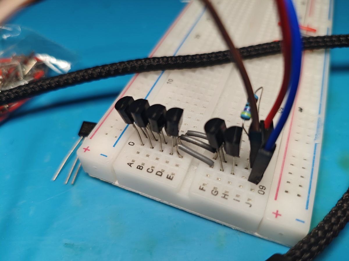

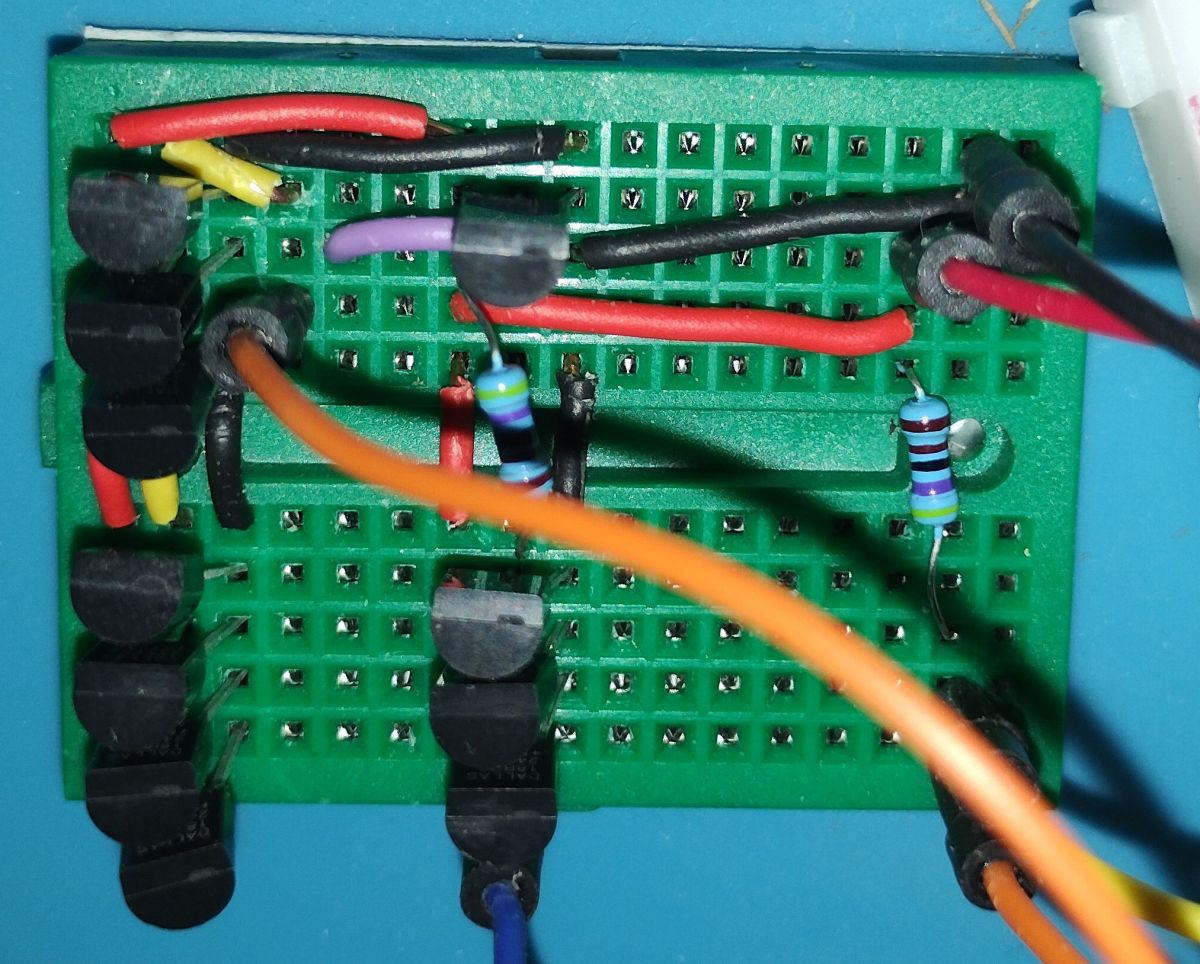

    Maybe you want an idea of how my setup looks like? I made a small "testing breadboard" that will provide two "buses" with 7 and 3 sensors, and one "single" sensor. The 7 and single sensors are meant to be used exclusively; they share the 4.7kΩ resistor (thanks to git user "rpv-tomsk" - see PR PR #1579 - using "HAL_PIN_Setup_Input_Pullup" it might also work without an external pullup).

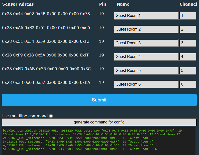

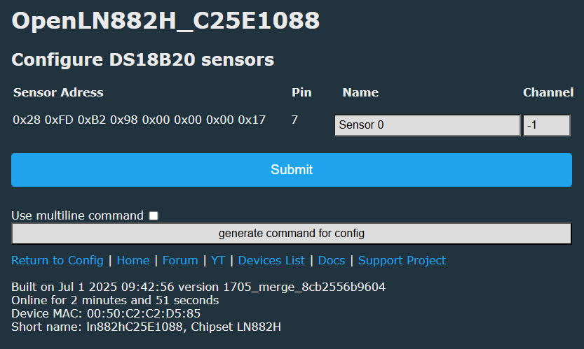

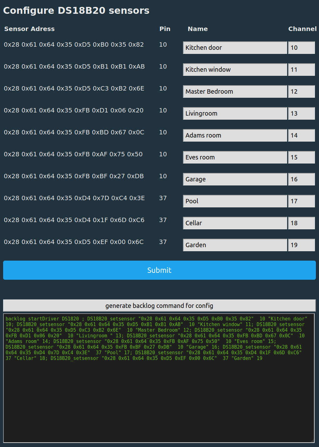

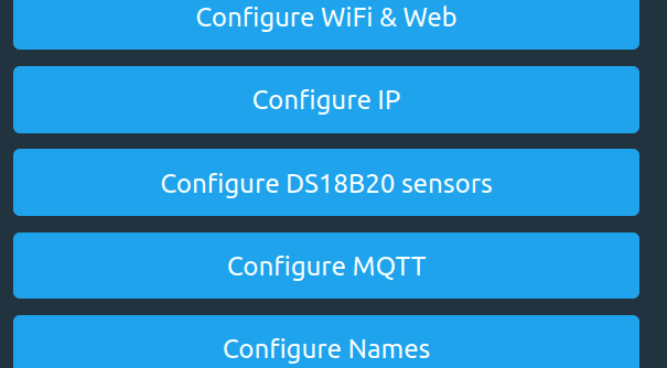

    Since I like it easy, I also added a simple configuration page to do all the settings:
    Extending DS18(B)20 driver - multiple GPIOs and multiple sensors per GPIO
    It also allows to generate a "backlog command" of all the configuration. This way, you can easily copy and paste this to autoexec or as a startup command and preserve the settings over a reboot. In my case, the resulting command is:
    backlog startDriver DS1820 ; DS18B20_setsensor "0x28 0x61 0x64 0x35 0xD5 0xB0 0x35 0x82"  10 "Kitchen door" 10; DS18B20_setsensor "0x28 0x61 0x64 0x35 0xD5 0xB1 0xB1 0xAB"  10 "Kitchen window" 11; DS18B20_setsensor "0x28 0x61 0x64 0x35 0xD5 0xC3 0xB2 0x6E"  10 "Master Bedroom" 12; DS18B20_setsensor "0x28 0x61 0x64 0x35 0xFB 0xD1 0x06 0x20"  10 "Livingroom " 13; DS18B20_setsensor "0x28 0x61 0x64 0x35 0xFB 0xBD 0x67 0x0C"  10 "Adams room" 14; DS18B20_setsensor "0x28 0x61 0x64 0x35 0xFB 0xAF 0x75 0x50"  10 "Eves room" 15; DS18B20_setsensor "0x28 0x61 0x64 0x35 0xFB 0xBF 0x27 0xDB"  10 "Garage" 16; DS18B20_setsensor "0x28 0x61 0x64 0x35 0xD4 0x7D 0xC4 0x3E"  37 "Pool" 17; DS18B20_setsensor "0x28 0x61 0x64 0x35 0xD4 0x1F 0x6D 0xC6"  37 "Cellar" 18; DS18B20_setsensor "0x28 0x61 0x64 0x35 0xD5 0xEF 0x00 0x6C"  37 "Garden" 19

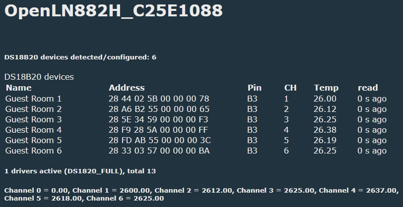

    The main page will reflect the changes:
    you can see the description per sensor and the channels are updated.

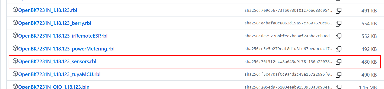

  • Suggesting OBK-Sensors-only merge with single-file ifdefs
    #2 21585831
    Posts: 14770
    Rate: 12912
    Thank you for this interesting presentation. The UI idea and naming is very nice, altough I would consider doing it in Web App. Still, since it's already ready...
    My suggestion is to merge it now as-is, but keep it enabled only in OBK-Sensors:

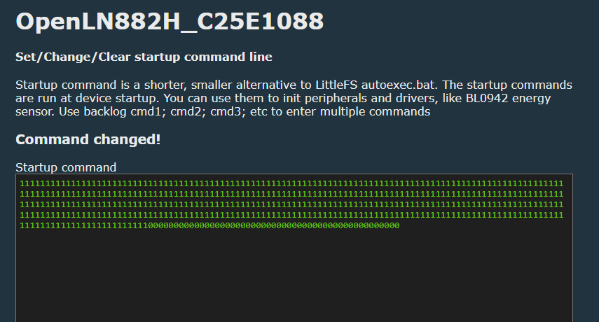

    The command generator is nice, but I think newer OBK does not require backlog, you can put each command in next line.

  • Multiline startup commands require OBK scripting enabled

    Well, that's a fair point. Maybe you can then just add a checkbox to choose between formats...
    Multiline command line is treating text as script file so it requires OBK scripting backend enabled, while backlog runs without it and is more lightweight and simple.
    The startup command can be multiline only if ENABLE_OBK_SCRIPTING is enabled in obk_config.h

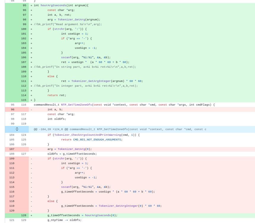

    I also saw you done breaking change to allow time offset in minutes - i can merge it but first can you revert to hours and then just allow fractional parts?
  • Fractional hour offset for backward-compatible DST command
    You mean PR #1485?
    Did I understand that right, you want to change the command to be "backward compatible" by not setting the total minutes, but set them e.g. as "0 hour and 30 minutes" like

    Flash size matters much in the main build (single DS18B20 version). In sensors build flash size is not top priority, because for sensors build we strip TuyaMCU driver, power metering drivers, etc, LED driver.

  • Helper function enables shared parsing for multiple commands
    #8 21586410
    max4elektroda
    Posts: 758
    Help: 49
    Rate: 189
    The code for parsing is already there, I only moved it to a helper function, so it can be used by multiple commands.

    Hm ok but the question would be how much flash parsing with : consumes. Still, if that's not much, then it's acceptable.
  • Measured firmware size impact of DST offset check
    #10 21586422
    max4elektroda
    Posts: 758
    Help: 49
    Rate: 189
    Let me check the size. Will report here.
    I will do the "review" of DS18B20 next week (I hope). Will be quite busy the next time.
    Added after 1 [hours] 9 [minutes]:
    Just checked some file sizes:
    No visible size change for Beken-N -- is it padded?
    W800 is 128 bytes enlarged
    BL602 is 144 bytes enlarged
    This is including the new sanity check for DST offsets > 2h (including an error message, which alone is 93 characters long).
       int off = Tokenizer_GetArgsCount() < 9 ? 60 : hourArg2seconds(8)/60;
       if (off != off%121) {
          ADDLOG_ERROR(LOG_FEATURE_RAW, "CLOCK_CalcDST: DST offset must be <= 2 hours, but is %i minutes. Setting to default of 1 hour",off);
          off=60;
    Two things to remember:
    This feature is off for all platforms (despite simulator - we need it enabled to test)
    As I pointed out earlier: This PR is not high priority or might be ignored for it's use case very low.
    Only the sanity check might be useful, but since we don't check the other arguments ....
    So it's up to you, I really don't mind if this PR is not merged, our discussion (don't get me wrong, I enjoyed it) was longer than the time I spend with the code.

    Actually I favor to have two separate drivers, opened https://github.com/openshwprojects/OpenBK7231T_App/pull/1705 for this.
    Two differences to the other PR:
    Only changed DS1820 code, not timing for usleep, that should be a separate thread. For me, DS 18B20 on BK7238 don't work, exactly like release version.
    I also made a checkbox to allow multi line commands.
    Now it's only testing of both versions on all platforms and later change obk_config.h to enable full driver only e.g. in sensors release.
    Sadly I don't have any possibly to test, so maybe I can ask @divadiow for support again?
    There are two drivers, the original and DS1820_FULL, both are mutually exclusive.

    Added after 22 [minutes]:
    LN882H - IO A7
    Extending DS18(B)20 driver - multiple GPIOs and multiple sensors per GPIO Extending DS18(B)20 driver - multiple GPIOs and multiple sensors per GPIO Extending DS18(B)20 driver - multiple GPIOs and multiple sensors per GPIO
    Simple ALL log
    Full ALL log
    Multiple DS18B20s on one GPIO still miss the last sensor

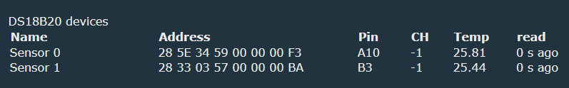

    #26 21601211
    Posts: 5220
    Help: 449
    Rate: 918
    I thought I should go back and read your first post. I assumed (!) each sensor was to be on its own gpio. I'll remake like your breadboard. Interesting though that with full it will detect the first two but never the last of the 3 I have set, whatever gpio above the second one.
    Anyway, I'll change it up.
    Added after 33 [minutes]:
    Spoiler:
    Info:SENSOR:DS1820 - Sensor 0x28 0xA6 0xB2 0x55 0x00 0x00 0x00 0x65 on B3 reported 26.19
    Debug:SENSOR:DS1820 - Found device at index 2 - GPIO=19
    Debug:SENSOR:DS1820 - GPIO found for device - DS18B20_GPIO=19
    Debug:SENSOR:DS1820 - ds18b20_readScratchPad returned 1 - Crc8CQuick=121 / scratchPad[SCRATCHPAD_CRC]=121
    Debug:SENSOR:DS1820 - ds18b20_Scratchpat2TempC: family=28, raw=3376 (12 bit resolution)
    Debug:SENSOR:DS1820 - Device 2 (0x28 0x5E 0x34 0x59 0x00 0x00 0x00 0xF3) reported 26.38
    Info:SENSOR:DS1820 - Sensor 0x28 0x5E 0x34 0x59 0x00 0x00 0x00 0xF3 on B3 reported 26.38

    Info:SENSOR:DS1820 - Starting conversion
    Debug:SENSOR:DS1820 - .. Pin 19 found! dsread=1
    Info:SENSOR:DS1820 - Reading temperature from 6 DS18B20 sensor(s)
    Debug:SENSOR:DS1820 - Found device at index 0 - GPIO=19
    Debug:SENSOR:DS1820 - ds18b20_readScratchPad returned 1 - Crc8CQuick=86 / scratchPad[SCRATCHPAD_CRC]=86
    Debug:SENSOR:DS1820 - ds18b20_Scratchpat2TempC: family=28, raw=3336 (12 bit resolution)
    Debug:SENSOR:DS1820 - Device 0 (0x28 0x44 0x02 0x5B 0x00 0x00 0x00 0x78) reported 26.06
    Info:SENSOR:DS1820 - Sensor 0x28 0x44 0x02 0x5B 0x00 0x00 0x00 0x78 on B3 reported 26.06
    Debug:SENSOR:DS1820 - Found device at index 1 - GPIO=19
    Debug:SENSOR:DS1820 - ds18b20_readScratchPad returned 1 - Crc8CQuick=65 / scratchPad[SCRATCHPAD_CRC]=65
    Debug:SENSOR:DS1820 - ds18b20_Scratchpat2TempC: family=28, raw=3352 (12 bit resolution)
    Debug:SENSOR:DS1820 - Device 1 (0x28 0xA6 0xB2 0x55 0x00 0x00 0x00 0x65) reported 26.19
    Debug:SENSOR:DS1820 - Found device at index 3 - GPIO=19
    Debug:SENSOR:DS1820 - Device 3 (0x28 0xF9 0x28 0x5A 0x00 0x00 0x00 0xFF) reported 26.38
    Info:SENSOR:DS1820 - Sensor 0x28 0xF9 0x28 0x5A 0x00 0x00 0x00 0xFF on B3 reported 26.38
    Debug:SENSOR:DS1820 - Found device at index 4 - GPIO=19
    Debug:SENSOR:DS1820 - ds18b20_readScratchPad returned 1 - Crc8CQuick=85 / scratchPad[SCRATCHPAD_CRC]=85
    Debug:SENSOR:DS1820 - ds18b20_Scratchpat2TempC: family=28, raw=3360 (12 bit resolution)
    Debug:SENSOR:DS1820 - Device 4 (0x28 0xFD 0xAB 0x55 0x00 0x00 0x00 0x3C) reported 26.25
    Info:SENSOR:DS1820 - Sensor 0x28 0xFD 0xAB 0x55 0x00 0x00 0x00 0x3C on B3 reported 26.25
    Debug:SENSOR:DS1820 - Found device at index 5 - GPIO=19
    Debug:SENSOR:DS1820 - Device 5 (0x28 0x33 0x03 0x57 0x00 0x00 0x00 0xBA) reported 26.19
    Info:SENSOR:DS1820 - Sensor 0x28 0x33 0x03 0x57 0x00 0x00 0x00 0xBA on B3 reported 26.19
    Debug:SENSOR:DS1820 - .. Pin 19 found! dsread=0
    Debug:SENSOR:DS1820 - ds18b20_readScratchPad returned 1 - Crc8CQuick=87 / scratchPad[SCRATCHPAD_CRC]=87
    Debug:SENSOR:DS1820 - ds18b20_Scratchpat2TempC: family=28, raw=3344 (12 bit resolution)
    Debug:SENSOR:DS1820 - Device 0 (0x28 0x44 0x02 0x5B 0x00 0x00 0x00 0x78) reported 26.12
    Info:SENSOR:DS1820 - Sensor 0x28 0x44 0x02 0x5B 0x00 0x00 0x00 0x78 on B3 reported 26.12
    Debug:SENSOR:DS1820 - ds18b20_readScratchPad returned 1 - Crc8CQuick=225 / scratchPad[SCRATCHPAD_CRC]=225
    Debug:SENSOR:DS1820 - ds18b20_Scratchpat2TempC: family=28, raw=3328 (12 bit resolution)
    Debug:SENSOR:DS1820 - Device 0 (0x28 0x44 0x02 0x5B 0x00 0x00 0x00 0x78) reported 26.00
    Info:SENSOR:DS1820 - Sensor 0x28 0x44 0x02 0x5B 0x00 0x00 0x00 0x78 on B3 reported 26.00
    Debug:SENSOR:DS1820 - ds18b20_readScratchPad returned 1 - Crc8CQuick=120 / scratchPad[SCRATCHPAD_CRC]=120
    Debug:SENSOR:DS1820 - ds18b20_Scratchpat2TempC: family=28, raw=3368 (12 bit resolution)
    Debug:SENSOR:DS1820 - Device 3 (0x28 0xF9 0x28 0x5A 0x00 0x00 0x00 0xFF) reported 26.31
    Info:SENSOR:DS1820 - Sensor 0x28 0xF9 0x28 0x5A 0x00 0x00 0x00 0xFF on B3 reported 26.31
    Debug:SENSOR:DS1820 - Device 5 (0x28 0x33 0x03 0x57 0x00 0x00 0x00 0xBA) reported 26.25
    Info:SENSOR:DS1820 - Sensor 0x28 0x33 0x03 0x57 0x00 0x00 0x00 0xBA on B3 reported 26.25
    Debug:SENSOR:DS1820 - Device 1 (0x28 0xA6 0xB2 0x55 0x00 0x00 0x00 0x65) reported 26.12
    Info:SENSOR:DS1820 - Sensor 0x28 0xA6 0xB2 0x55 0x00 0x00 0x00 0x65 on B3 reported 26.12
    Debug:SENSOR:DS1820 - Device 2 (0x28 0x5E 0x34 0x59 0x00 0x00 0x00 0xF3) reported 26.31
    Info:SENSOR:DS1820 - Sensor 0x28 0x5E 0x34 0x59 0x00 0x00 0x00 0xF3 on B3 reported 26.31
    Debug:SENSOR:DS1820 - Device 5 (0x28 0x33 0x03 0x57 0x00 0x00 0x00 0xBA) reported 26.12
    Info:SENSOR:DS1820 - Sensor 0x28 0x33 0x03 0x57 0x00 0x00 0x00 0xBA on B3 reported 26.12
    Debug:SENSOR:DS1820 - Device 4 (0x28 0xFD 0xAB 0x55 0x00 0x00 0x00 0x3C) reported 26.19
    Info:SENSOR:DS1820 - Sensor 0x28 0xFD 0xAB 0x55 0x00 0x00 0x00 0x3C on B3 reported 26.19
    Debug:SENSOR:DS1820 - Device 3 (0x28 0xF9 0x28 0x5A 0x00 0x00 0x00 0xFF) reported 26.25
    Info:SENSOR:DS1820 - Sensor 0x28 0xF9 0x28 0x5A 0x00 0x00 0x00 0xFF on B3 reported 26.25
    there's something weird with the startup command though - multi-line and not. when saving it'll stop at "WIFI_GetMacAddress" then reboot

    Thanks, I'll take a look into the issues you found.
    The search routine is in fact not always reliable, but you can restart it with "DS1820_FULL_scansensors".
    So main results are: crashes ESP32 and the command. Did I get it right that it's not the command itself but saving the command? So maybe it's just to large?
    This was with LN882H in the test, or with other platforms, too?
    Once again, thanks for your support.
    I will do testing on BL602 and W800 - on BK7238 I never managed to get DS1820 to work (with the "original" simple driver), only with changes to HAL_Delay_us, and I don't want to mix this here.

    after ESP32 everything below that is with LN882H. I can do more granular stuff with start-up command - fresh flash, shorter commands, more tries etc
    Added after 25 [minutes]:
    on ln882h it is the length. at 497 characters it will save OK. at 498 it does the reboot

    I can try to strip down the commands, especially the detailed address could be simplified from e.g "0x28 0x61 0x64 0x35 0xD4 0x7D 0xC4 0x3E" to "28616435D47DC43E" and the command itself maybe from "DS1820_FULL_setsensor" to something like "setDS1820".

    cool. 2s test with BL602 looks to be a similar thing. too long and it'll error with:
    (standard BLDC 1.9.0 toml - not insmod XtremeToml©)
    but it does not reboot like LN882H
    cut the startup command in half and it saves
