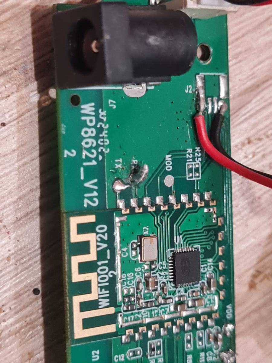

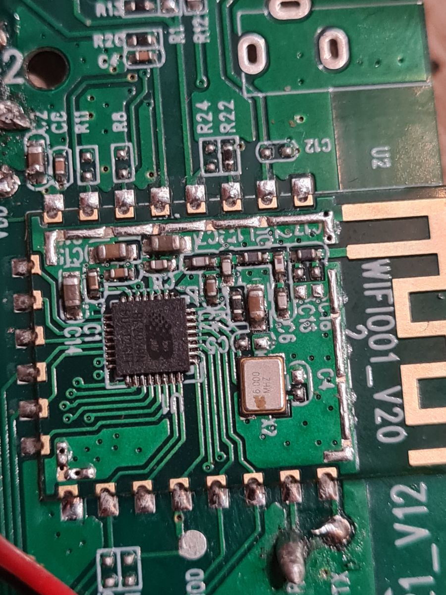

    I have this device
    Xiaomei Fish Feeder with built-in WIFI002_V20 Belon BL2028N here.
    I can't get any further with the BK72311N flasher and the OpenBK7231N...
    I get the file when I do
    OpenBK7231N_QIO_1.17.594.bin flash , the message successful
    But despite the setting under Wifi data, the device does not appear in the Fritzbox or in the Point overview
    The same with fixed IP
    I managed it with esphome through the thread
    https://discord.com/channels/967863521511608370/1230509832029601793
    But I would like to do it with the OpenBK7231T_App if possible
    Close-up of a circuit board with electronic components. I get this message via Button Read only OBK config
    CRC matches 0xEAB98F5!
    All read!
    Loaded total 0x1000 bytes
    It's not an OBK config, header is bad
    OBK config load failed.
    About Extract Config from Tuya binary
    Failed to extract Tuya keys - magic constant header not found in binary
    Add the backup file as an attachment
    and pictures of the board

    Close-up of the PCB from a Xiaomei Fish Feeder showing traces, an integrated circuit, and markings.
    Close-up of Xiaomei Fish Feeder PCB with component labels and pinouts.

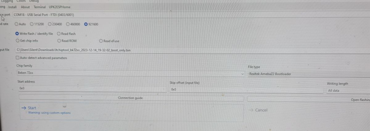

    #11 21107162
    Nordlicht77
    Posts: 67
    Hi
    I got further with the help of @divadiow
    Thanks for that
    I did the following
    I downloaded the bootloader from @Oranż Metylowy from discord
    https://discord.com/channels/967863521511608370/1230509832029601793/1230615302916804651
    Then I flashed the file with the software ltchiptool-v4.11.1.exe with the settings in the picture
    Computer screen displaying the opened ltchiptool-v4.11.1.exe program, used for flashing files onto Beken 72xx chips, with settings for USB port and other parameters.
    A reboot was carried out
    I downloaded the build file test20240601.zip from @p.kaczmarek2 from this forum
    https://www.elektroda.com/rtvforum/topic4056377.html#21103288
    After the final packaging I took the file from the archive OpenBK7231N_App_UA_1.0.0.bin
    Then I flashed the file using the software ltchiptool-v4.11.1.exe with the settings in the picture
    The image shows a computer screen displaying the ltchiptool-v4.11.1 program.
    Then I looked to see if the access point appeared in the Wifi list, it was listed there
    I then connected to this point and I was automatically sent to the URL 192.168.4.1
    I set up Wifi there and saved it
    I looked in the Fritzbox to see which IP the device received and called up this URL
    And lo and behold it works

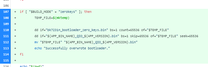

    So it's another device with 00000000000000000000000000000000 keys?
    I've been adding support of building that to N platform script, but my linux knowledge is rusty, I am C guy. Here is what I do. First build firmware with 0000 keys:
    Screenshot showing changes in the script file for firmware building.
    (edit: this screenshot above is not fully correct, I am not using zerokeys binary at this stage anymore, as it caused combine to fail)
    Then manually merge our QIO with original dogness bootloader (sent by another user):
    A code snippet from a script for building firmware using zerokeys for the Beken BK7231N device.
    I tried to follow these steps:
    Screenshot from a forum about device flashing issues.
    Can you make a full 2MB backup of your device and test my binary? I don't have this type of Beken to test
    • OpenBK7231N_App_QIO_1.0.0-test20240604.zip (595.16 KB) You must be logged in to download this attachment.
