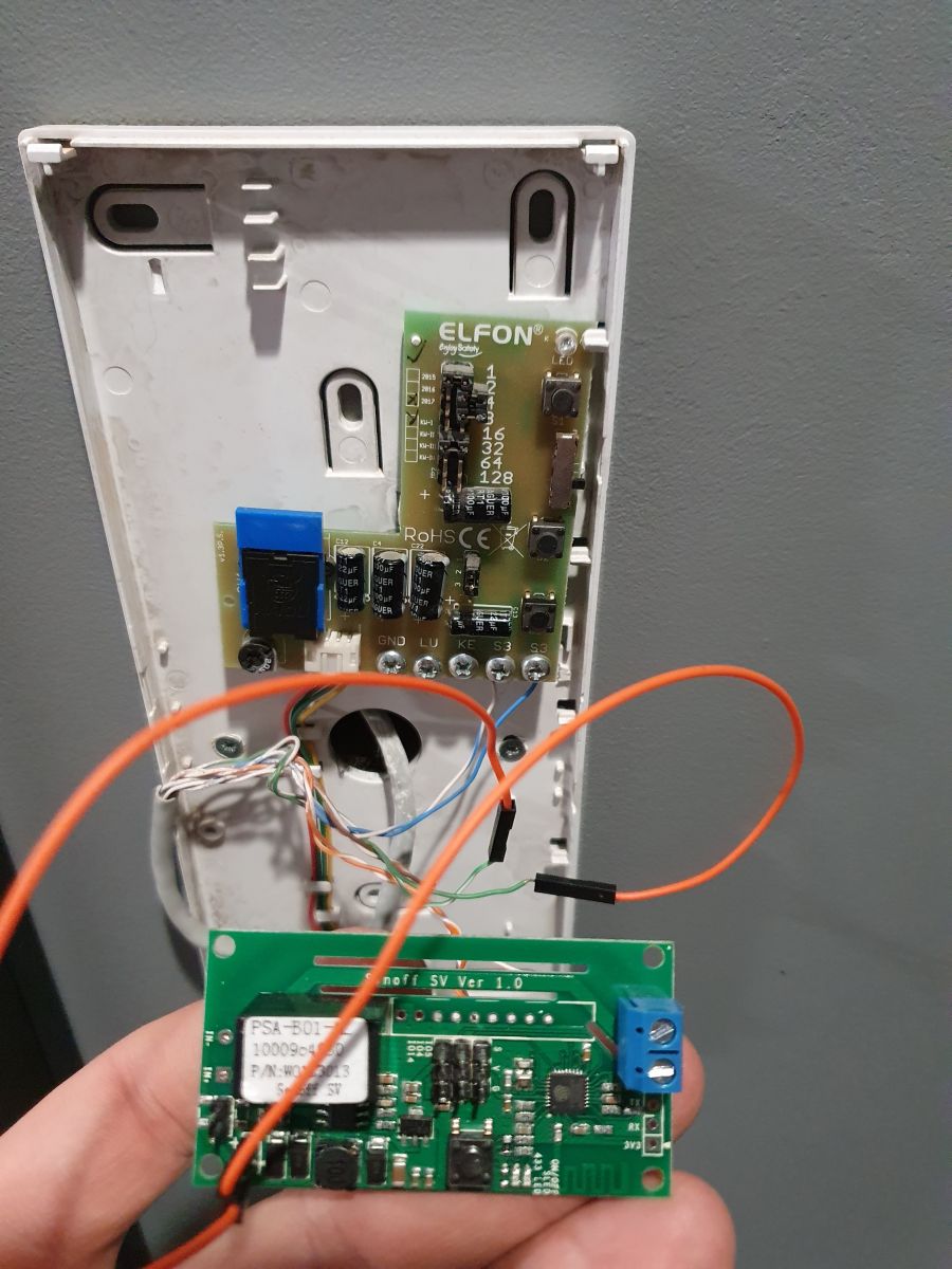

    skorek1989
    I have purchased a Sonoff SV to open the gate from the intercom. I have 9V connected to the intercom. Does anyone know why the voltage drops when connected to the Sonoff? The light sometimes blinks as if it wants to power up but can't.
  • #3 19456427
    skorek1989
    The intercom probably doesn't matter as I haven't connected it yet. I have a problem with the power supply of the Sonoff. I normally connect to a - 5-24V power supply. I have a 9.67V power supply with which the intercom is normally supplied, but I have not yet incorporated it into the circuit because I have a problem with the Sonoff. It is in 'isolated' mode

  • #5 19456538
    skorek1989
    I unplugged the power supply from the intercom/intercom and plugged LU into and GND into -.
    Before connecting to the sonoff I have 9.67V on the multimeter, after connecting as below - no voltage and no power. I have 2 sonoffs, both behave in the same way. The intercom is a regular Elfon.

  • #6 19456556
    sosarek
    Posts: 83875
    Help: 9321
    Rate: 15544
    That's not how it will work - the SONOFF needs to be powered from an external source and unplug this before you damage the intercom panel.

  • #7 19456560
    skorek1989
    OK, why doesn't it work and how can I make it work? Is it possible to attach a battery to it or a voltage stabilizer or some other trick? I have no way of getting power to it without forging and no circuit nearby.
  • #8 19456564
    sosarek
    Posts: 83875
    Help: 9321
    Rate: 15544
    This is the uniphone's digital line and not any power supply - without SONOFF power from an external source this will not work.
