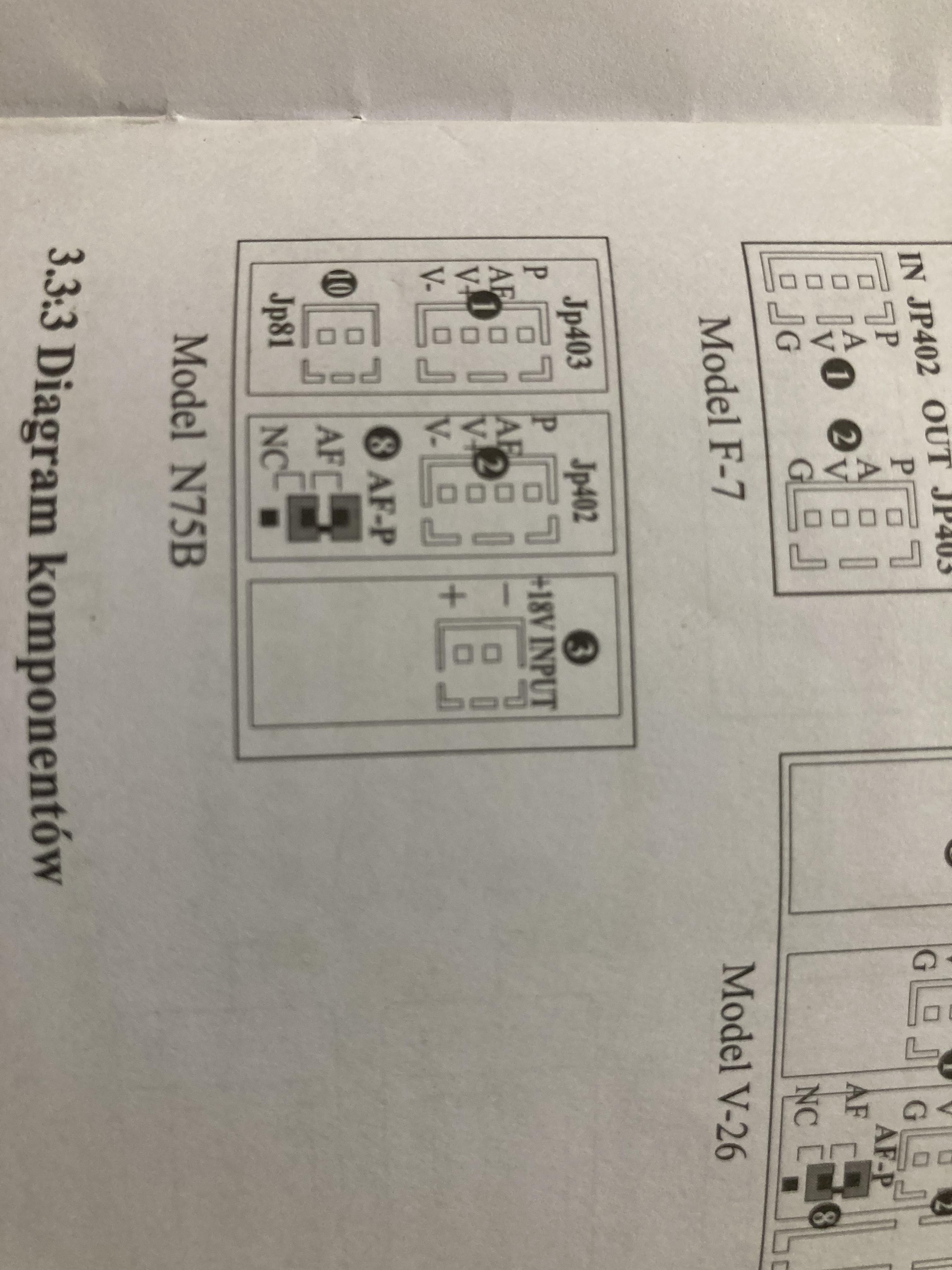

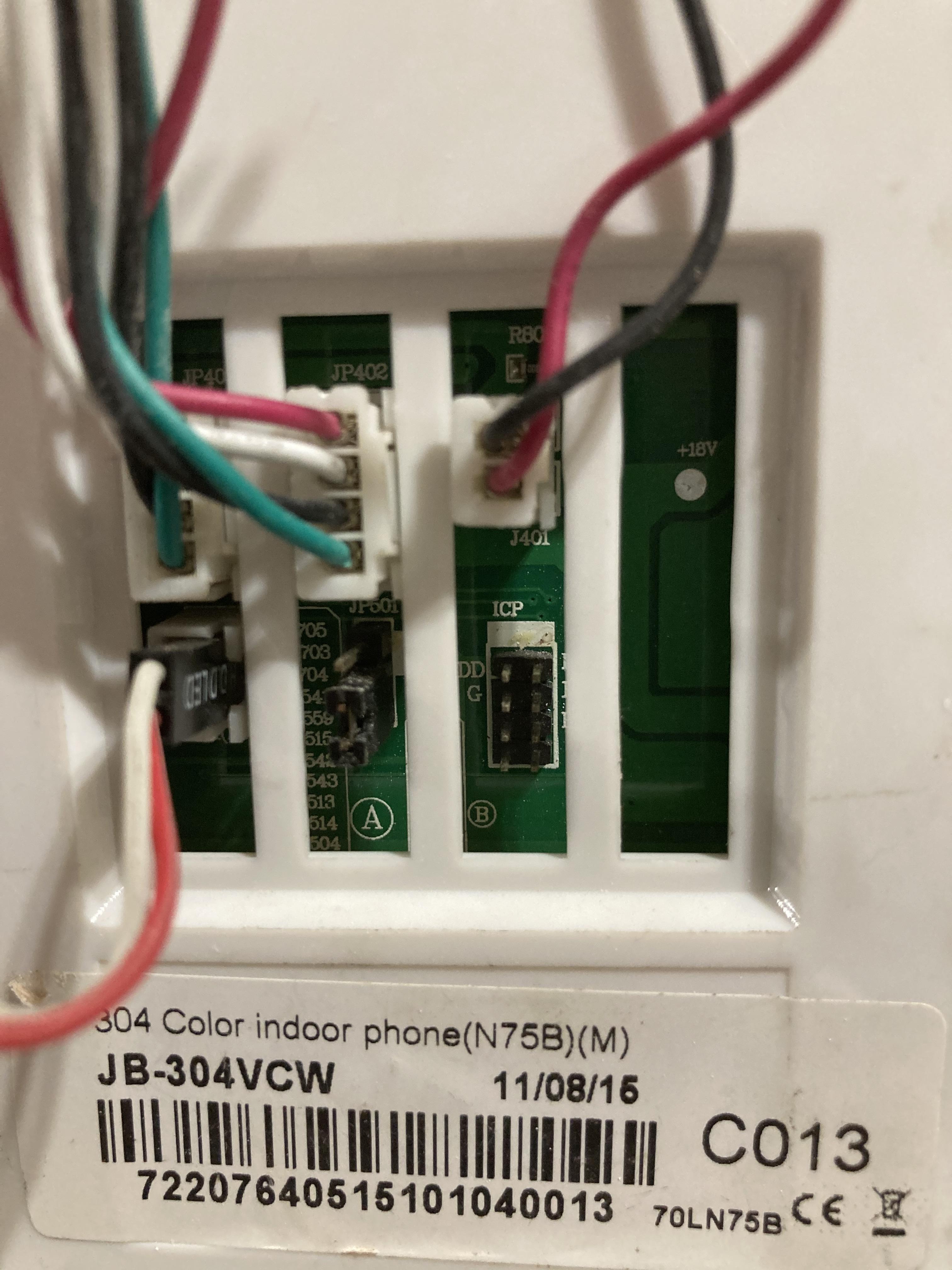

    i have a bit of a challenge when it comes to controlling the entrance gate via google assistant. instead of placing the controller at the gate itself (no wifi coverage) i am wondering if it would be possible to combine it with a video intercom and connect e.g. shelly 1 to it (or another suitable one) to the JP81 relay terminal (i am attaching a photo and diagram). Please comment on whether this can be done and possibly what to use (18v input). thank you. Regards

  • #3 19266386
    DomR
    Posts: 9
    Yes, everything is already connected at home. the button on the video intercom panel controls the gate (open/close).

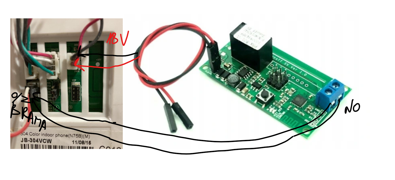

    Sorry I still haven't grasped this diode connection to NO and Com. If I don't do this then the button on the panel won't work for me and the gate will only be opened via wifi/assistant? Like on this connection the button will not work ? Video intercom - shelly connection - google assistant control .
  • #12 19268540
    DomR
    Posts: 9
    Will it work with this connection? Sorry for the super diagram ;) Video intercom - shelly connection - google assistant control .

    #19 19282219
    DomR
    Posts: 9
    Hi everyone, thanks for the discussion and advice.
    Managed to get everything connected and configured today (I didn't plug in that diode after all).
    Sonoff SV voltage free (powered by 18v) + Supla on phone + WiFi - voice control to open/close gate via Siri or google assistant - commands in English (without using IFTTT as Supla doesn't work with it).
