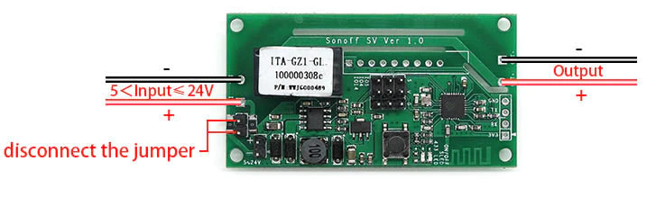

    I purchased a Sonoff sv, I wanted to have remote access to the lighting in the kitchen done on 12v.
    I hooked up the 12v power supply on the input and the lighting on the output.
    However, when connected to the power supply, all I can hear is the relay ticking, the LED does not light up, it does not respond to the button.
    I have connected exactly as shown in the photo below
    Why is the Sonoff SV 12V relay not working? .
    Is the sonoff defective ?
    Have I done something wrong ?

    If you connected the Sonoff to 12V with the jumper in place then it may have broken down. The jumper bypasses the built-in inverter.

    The jumper was not there, but I made a cardinal mistake which I laughed at myself I used a 230v/12v transformer from which AC was coming out instead of DC. After connecting the DC, everything works as it should.
