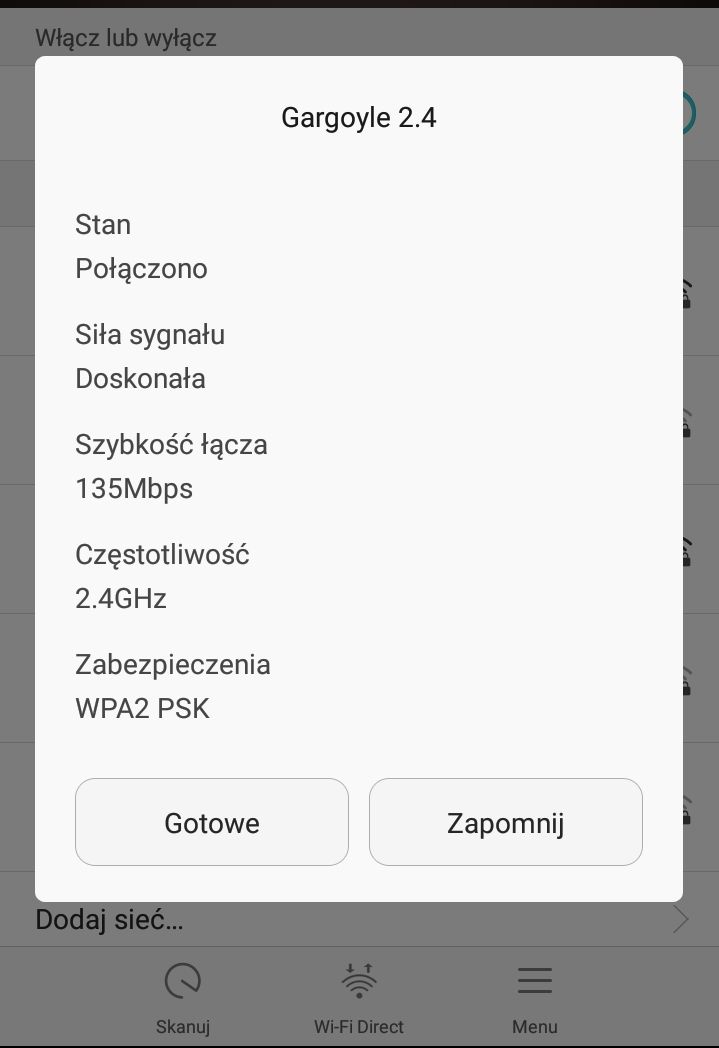

  • Wi‑Fi diagnostics and 20 MHz channel limit
    #2 19467189
  • #3 19467220
    beringen
    Posts: 90
    Quick partial answer.
    I'm not talking about the WiFi band, but about the connection on the computer via LAN. The fact that I have limited bandwidth on WiFi I can accept until I change the router, but on a desktop computer with a cable I should have a full connection. From the router and not only directly from the modem.
