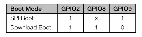

    Do I understand correctly that the USB port will always be enabled in "Download Boot" mode and in "SPI Boot" mode only if the corresponding option is set in sdkconfig ?
    Let's say I want to crash the device into an ESP32-C3 in the form of a USB dongle. If there is no button in it, will it fail to replace the firmware via USB ?

    khoam wrote:
    Not the USB port, but the ESP32-C3 chip itself can be set in one of these two modes. If it is set in "Download Boot" mode then it can be programmed from UART 0 or USB.
    I am interested in the hardware aspect. When will the GPIO18 and GPIO19 pins be used for USB ? Is it always after a reset ?
    I don't need to replace the firmware via USB. I am just trying to understand when and what mode this port is used.
