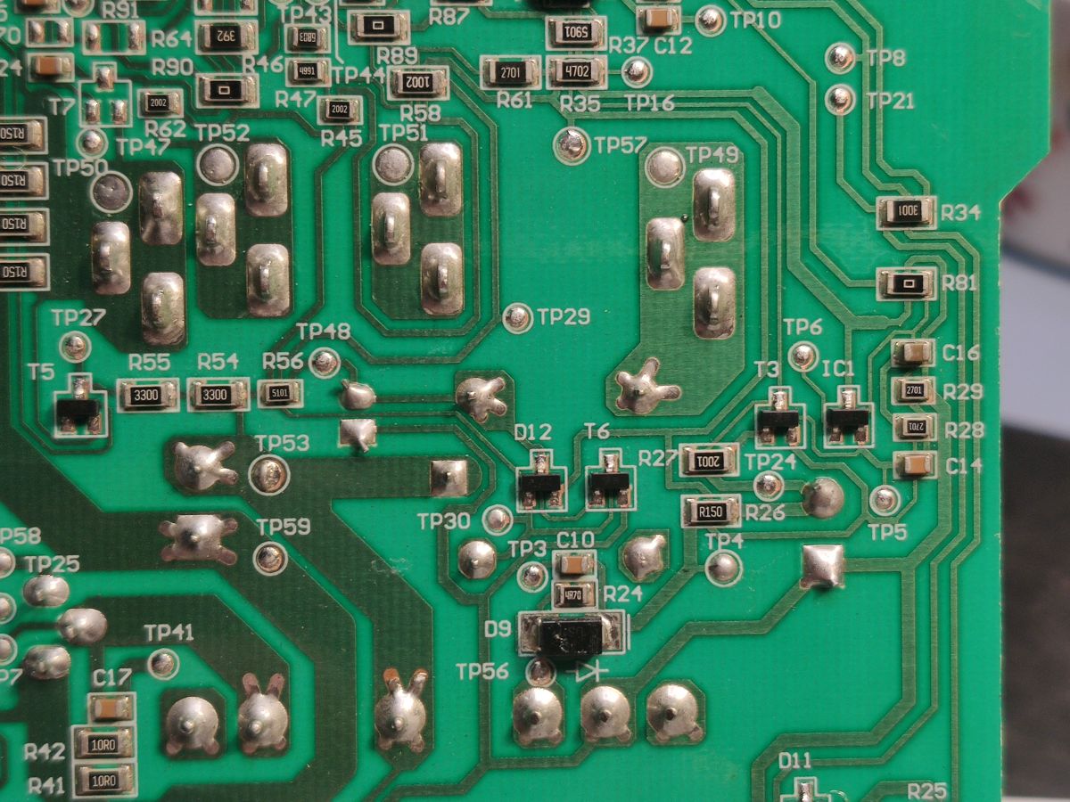

  • Board photos and component markings posted
    #32 21418106
    pablo1521
    Oil burners specialist
    Posts: 943
    Rate: 263

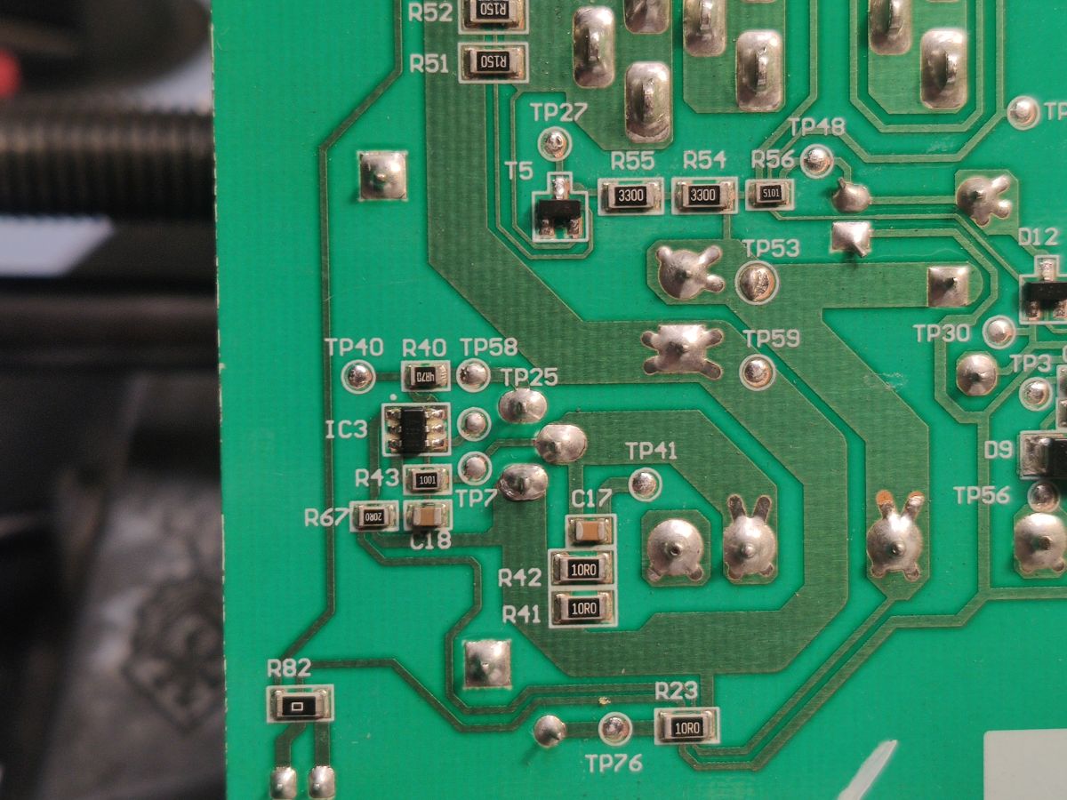

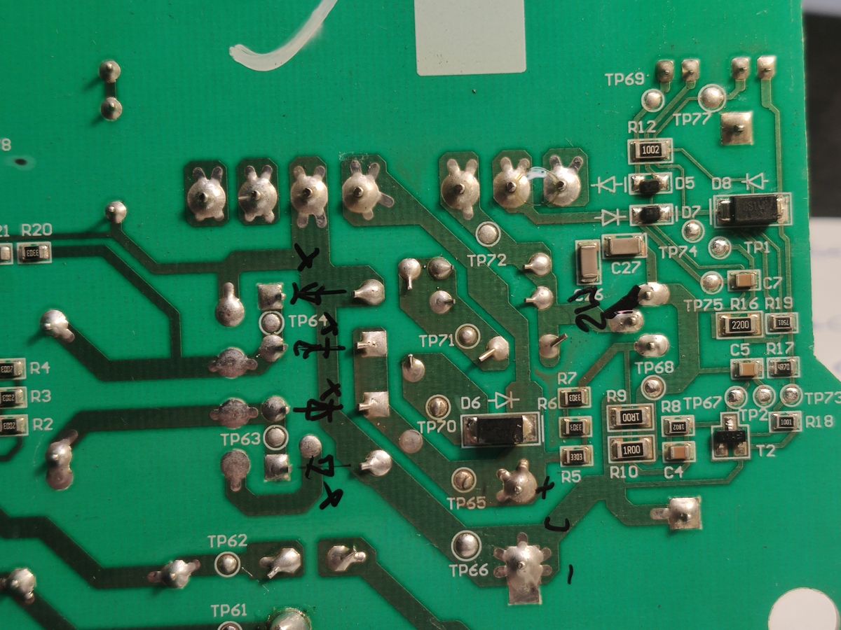

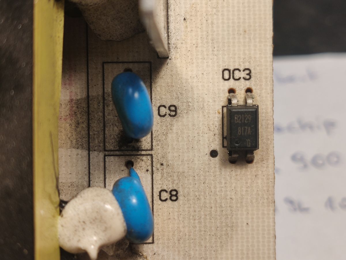

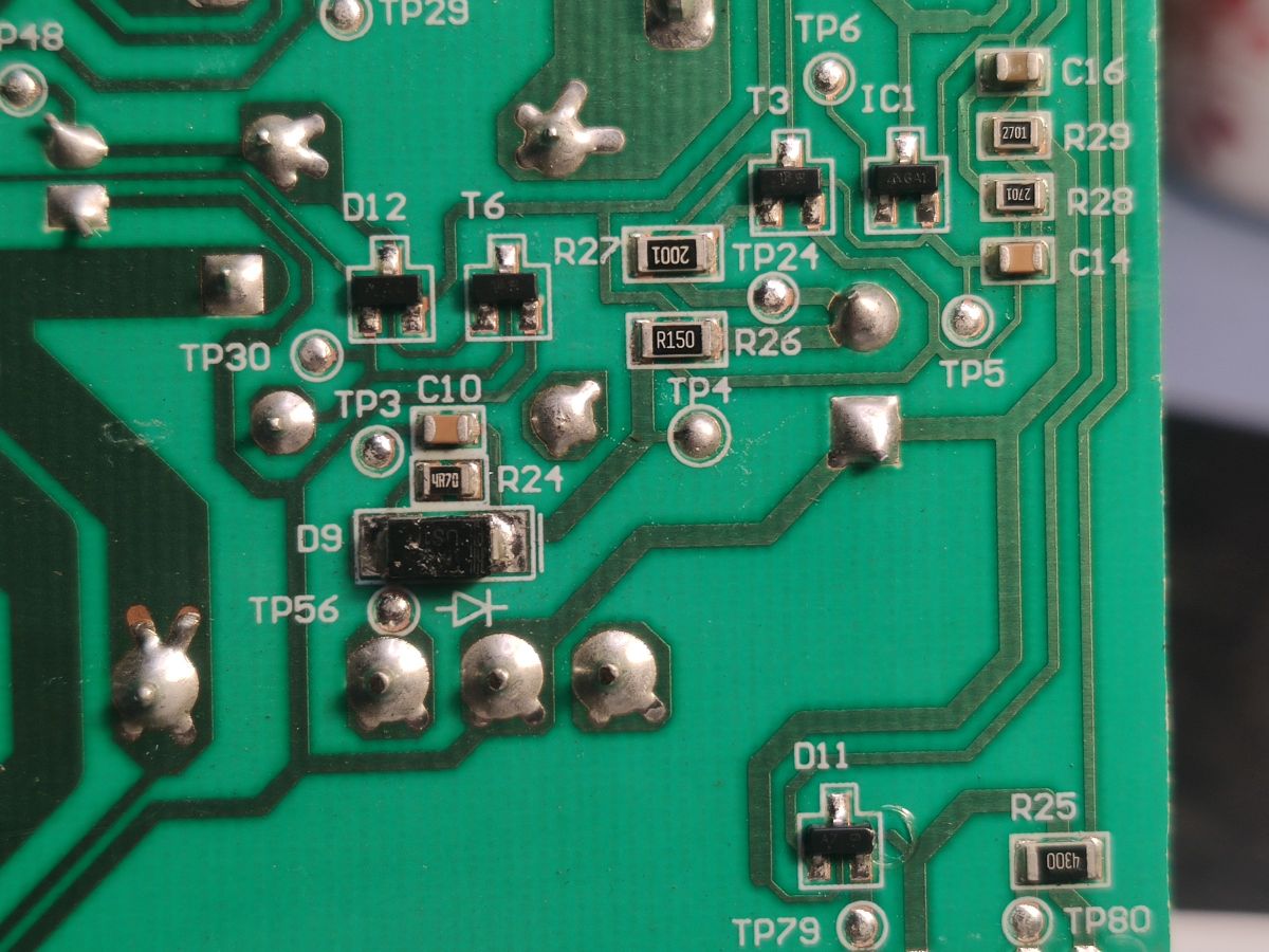

    For posterity, foto's of the board and component markings.
    Electronic components on a circuit board, labeled as C9 and OC3. .

    Close-up of a printed circuit board with electronic component labels. .
    Added after 10 [minutes]:
    A section of a green printed circuit board with visible electronic components such as resistors and diodes, labeled with numeric symbols. .
    Circuit board with labels and electronic components. .
    Close-up of a green printed circuit board with visible markings of electronic components. .
    Close-up of a printed circuit board with various component designations and test points. .
    Close-up of a green printed circuit board with electronic component markings. .
    Added after 4 [minutes]:
    Image of a green printed circuit board with component labels and test points. .
    Close-up of a printed circuit board with marked components and test points. .
    Image of a green printed circuit board with visible markings of components and vias. .

    Close-up view of electronic components labeled OC1 and OC2 on a circuit board. .
    Added after 6 [hours] 29 [minutes]:

    Just so you know, I have the same fault as most, replacing the
    80R900P
    T2 = W1A
    R9 and R10 = 1 Ω
    and works normally.
    However, following advice found on YT, I soldered out one of the 4 resistors that (I think) are used to measure the charging current, which has the effect of reducing the charging current from 4 to 3A. Acctually in my case it was R51 that was soldered out, but this is irrelevant.

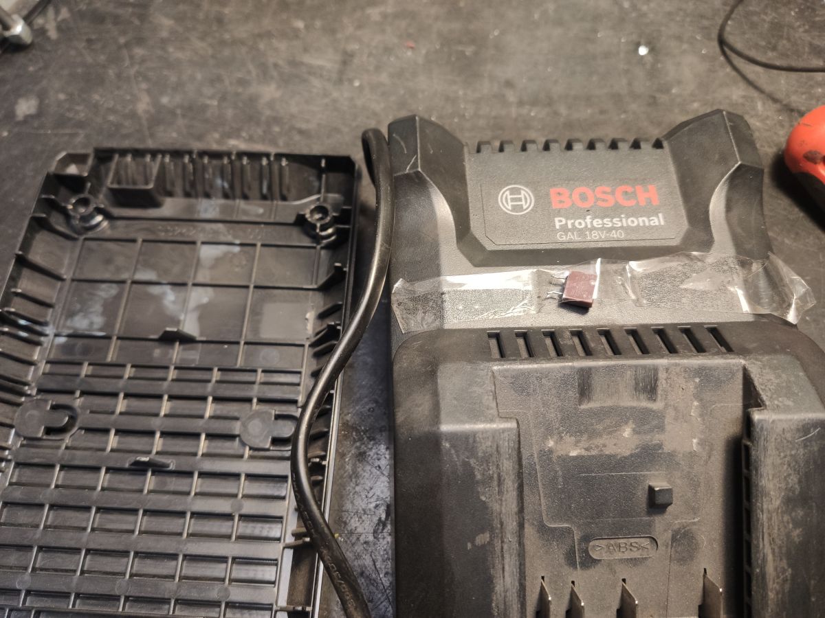

    Let me join the topic (same charger: GAL 18V-40).
    In my case, the charger probably experienced a little flooding which caused a short circuit (at least that's what I infer from the marks on the board).
    Damaged GAL 18V-40 charger circuit board with visible signs of liquid damage. .

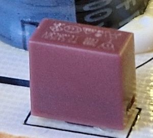

    3. can the fuse (looks like a capacitor next to the brown power cable) be replaced with a normal tube fuse? (2,5A)
    Burgundy rectangular electronic component on a circuit board 2.

    Insert the fuse you have. As long as the amperage is the same.
